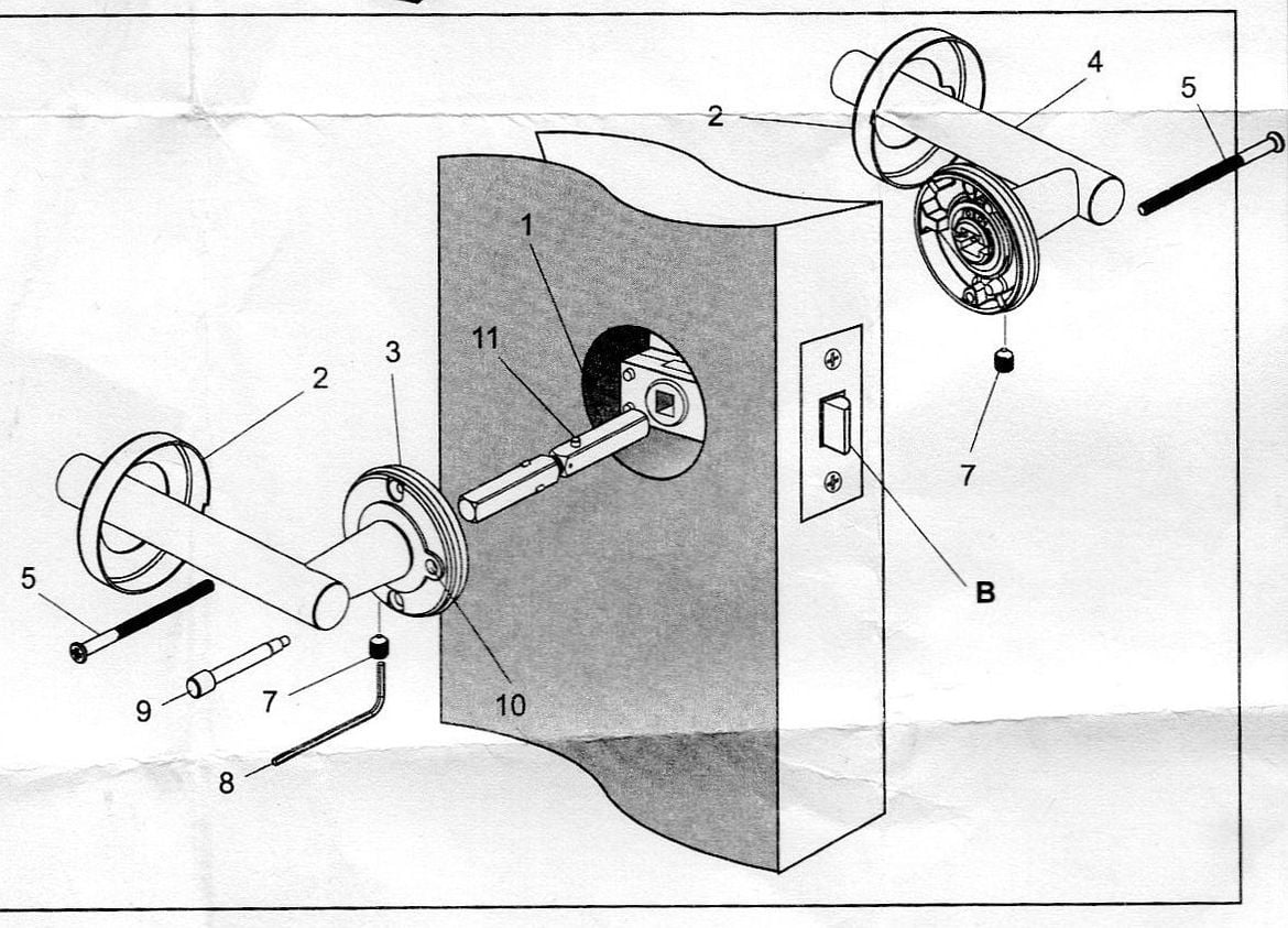

Better rosette cover that self-centres due to the locking pin surround.
Much sturdier locking pin and locking mechanism.
Much better fastening system. The Lane had a fiddly threaded tube system.
And a very clever square drive spindle that locks into position with a depressed button (No.11). Much better than the springed version on the Lane that flys off when attempting to assemble.
Similar lever spring to the Lane so I suppose it could break just as easy as the Lane - time will tell I guess.

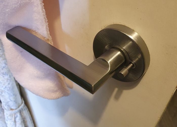

The finished look...
