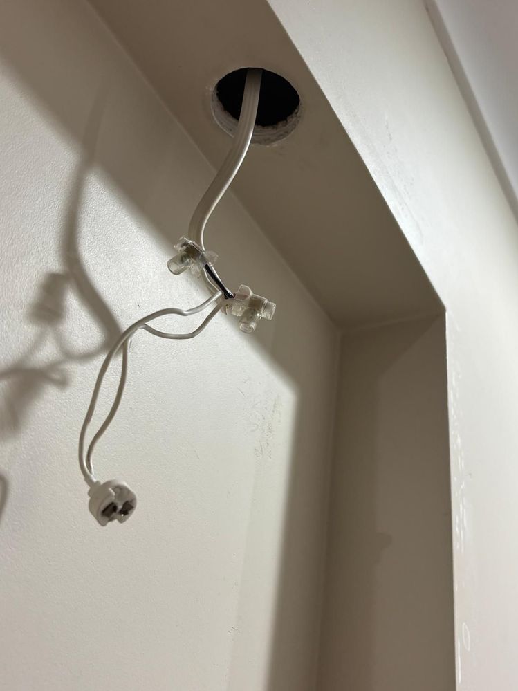

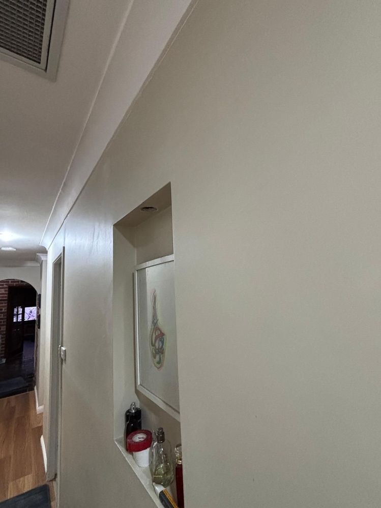

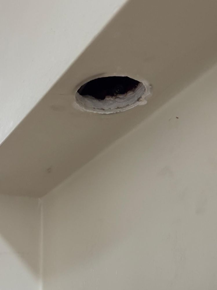

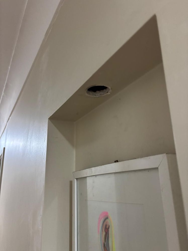

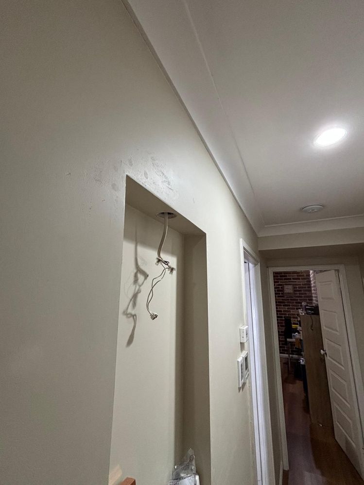

Looking to use two hole saws with a single arbor to enlarge existing ceiling gyprock holes from 50mm to 70mm something similar to this
https://bloximages.chicago2.vip.townnews.com/lakeexpo.com/content/tncms/assets/v3/editorial/6/0a/60a...
Reason to enlarging holes as I can't the downright 50mm with their brackets as I guess there are old style

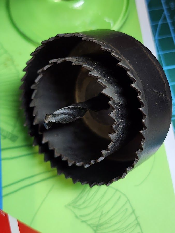

I have got couple of hole saws set but problem thread on arbor wouldn't fit 2 hole saws

I just popped into the shed at 10 pm and looked through some old hole saw sets.
These are from Clints Warehouse from the early 2000's. Cheap and nasty I admit but would suffice for gyprock.
I can get the combination but the 50mm only protrudes 5mm above the 70mm, so certainly not as long as seen in the photo in your link above.
Another thought is a 50mm wood disc inserted into a PVC pipe section.
Just late night thoughts.

I suggest the following workaround (which I have done) providing you can access that area and... it's quite laborious requiring some patience.
Cut to size a piece of plywood to fit between the joists and secure with brackets.
Back inside using a compass find the center of the 50mm plaster hole and boar your 70mm hole.

"i am thinking about your suggestion 50mm wood disc"
It does work. I removed the 6 mm drill and replaced it with a 6 mm bolt. Cut the head off and 'notch' the other end for the grub screw.
But it's not pretty.

If it's just the one downlight, it likely would be easiest to just adjust the hole size with a jab saw.

Morning Noyade
Nice technique
I guess initially you used 50mm holesaw to boar in a thick timber to get 50mm cylindrical template
Then you attached that template to your arbor to be a pilot guide with 70mm holesaw
