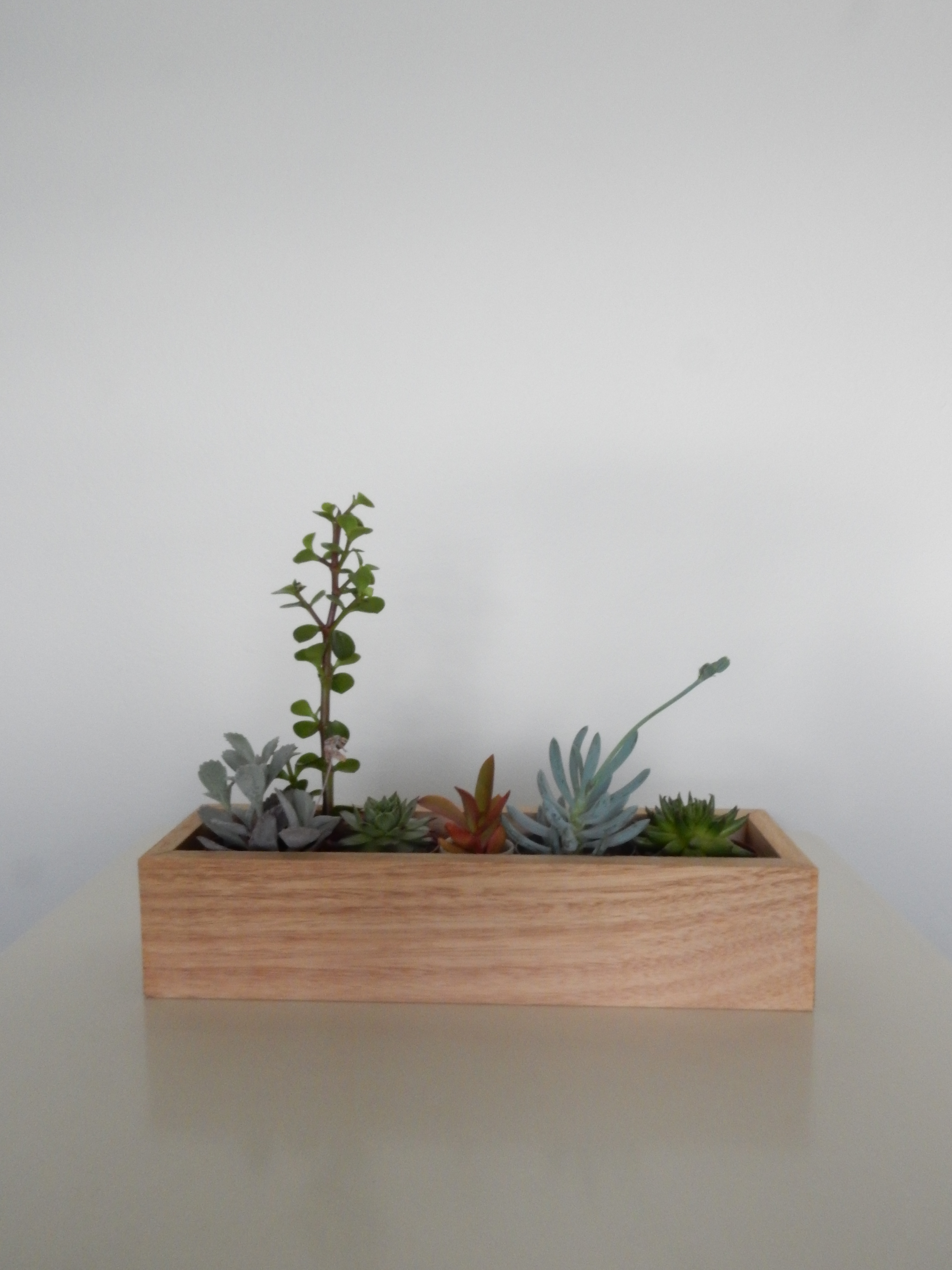

I'm completely new to woodworking and in dire need of help! I tried making a wooden planter with 45 degree cut corners and glued it together with Sellys aquadhere -the first one looks okay but the rest of the corners are terrible ![]()
This was made with scap wood I found on the side of the road. I would like to try again with some 12mm thick tasmanian oak I bought from bunnings and coat it with tung oil (apparently it cures the wood and makes it waterproof?)
I want to create something like the planter on the right...any help would be greatly appreciated. Oh and I bought a corner clamp from bunnings but it never clamped the corners properly ... either that or I didnt use it properly?

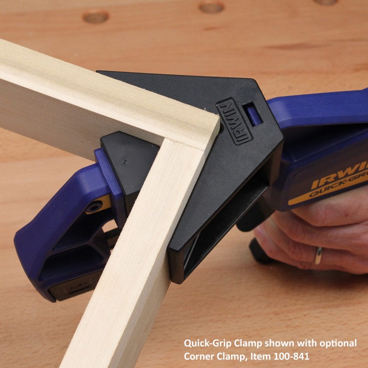

@Kim2is the clamp like this?
Or this?
The all in one clamping action is hard to get to line up properly while the double clamps let you adjust one side at a time for best fit.
To help with alignment you can use dowells, biscuits or glue joint routing.
Pocket holes are another choice you need the alignment right while screwing together though.
Through dovetails would be the holy grail of woodworking, not for the faint hearted though.

I have moved your first gallery photo here so everyone can see it. It looks fantastic. Well done.
