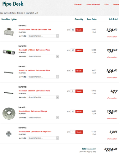

The Shopping List:
(for the frame only)
(I forgot to add the screw ends)

I like how you shared your shopping list @topper . It would be good if there was a way to download people's shopping lists for popular projects so its easy to replicate them.
Looking forward to seeing the finished project.

G'day @Kermit
That was my exact thinking. Hopefully if @Jason likes the idea we can see some kind of implementation of 'shareable' lists or even integration between users on this site, users on bunnings site and your own wishlist sharing?
Re: Project: Galvanised Pipe Desk
Thanks @topper.
We can certainly see the value of being able to share wish lists with other community members. This is something we have on our radar once we have tighter integration between Workshop and the Bunnings site, which will include a single sign on (single identity).

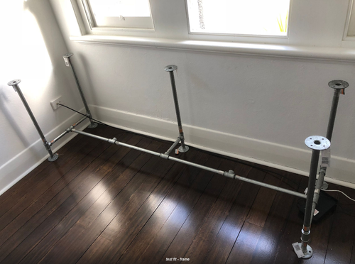

I used the same design but with 4 uprights to support a full 2200mm table top.
But you seem to have 3 x L shaped extensions along the back... are they extensions for an above desk shelf/platform?
I really like that ideas as a monitor stand to get it to the right height as well as to free up some space on the table top ... clever!
