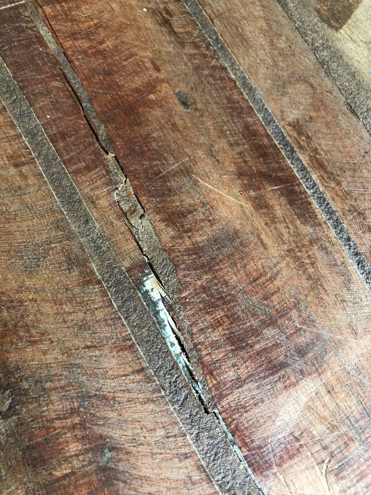

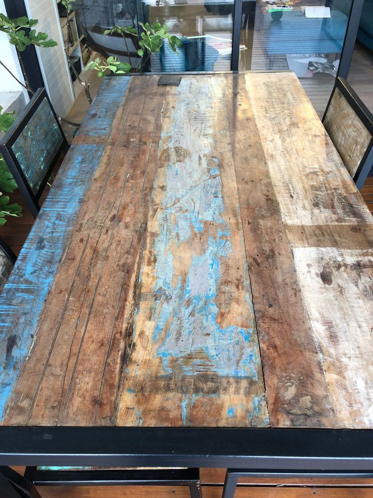

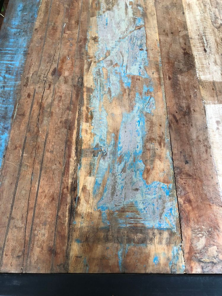

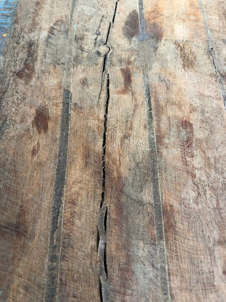

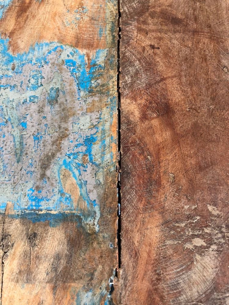

Hello, looking for some tips/advice from someone with some experience! My rustic/salvaged look wooden table has been used outside (but undercover) for the last 6 months and a huge crack had developed. I’m hoping it can be filled/repaired - I was thinking some kind of wood filler, ratchet/clamp combination but have no idea how to approach it and minimal tools/experience!
What steps do I need to consider and when it’s repired, will treating the table with oil help avoid more cracks?

Hey @rkbake - it’s a lovely looking table - it loooks like the top has been constructed from 3 wide pieces that haven’t been “glued and dowelled”. Bit puzzling as it’s undercover, but that isn’t going to stop it from drying out and warping.
Without knowing what other finish you’ve got on it (so, do let us know) I’d suggest 2 options.
#1 is the glue/fill and clamp that you’ve already thought about - in which case Liquid Nails have a clear glue (it’s the one in the light blue tube) and so do Sika (sorry can’t remember which one that is) - this would definitely work, and a polyurethane glue is another option., The sand an clear coat refinish. You would need the glue (obviously 😂) and a couple of massive clamps to force it together whilst setting. I wouldn’t suggest a wood filler because it’s going to make it look different, by emphasising the cracks.
#2 is to go with the flow and fill the gaps with a clear resin, which by using a clear filler, makes the cracks look like they’re part of the table. So, you could use the clear casting resin that should be on the shelf with the fibreglass kits (casting resin). I’m pretty sure that you’ll have to use an oil base topcoat over this to further protect it - so an oil base exterior varnish of some sort.

It would be interesting to see what your aim is in reference to the finish. Are you wanting to totally remove the current too surface back to bare timber or just fill the holes and cracks and keep that awesome half timber half sanded paint look.
It will also depend how much love you want to spend on the table top.
I honestly with all the research I've done over quite a while would go with as @Mathy suggested with epoxy resin.
You could go clear, black, metallic blues the options are endless. Even after a sand and then fill the cracks with a resin of choice.
