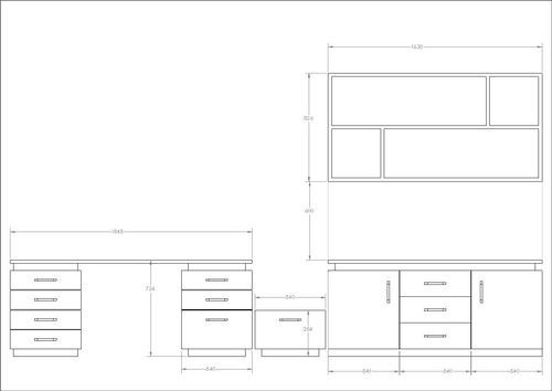

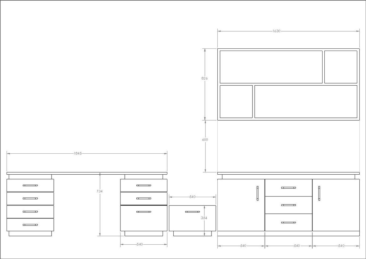

Hello to everyone.
This is my attempt to renovate my Study area.
First step was to make the desk.
I have made the Desk with Laminated Panels and Deco Plywood.
I used pocket holes to make the cabinets and kept a shadow line on the top to keep the design novel.
Top is a Merbau laminated board.
Drawer covers are Beech panels.
Finish - linseed oil
step 2 is to make the cabinets and book shelf.

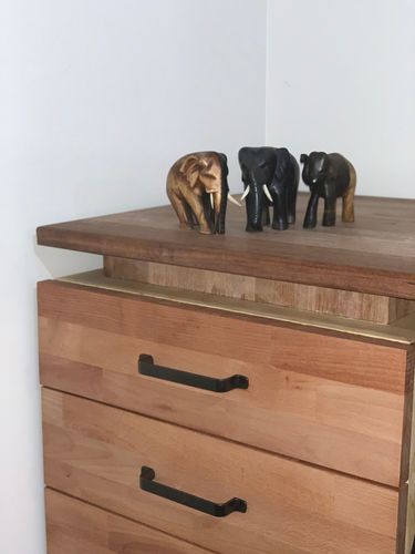

That looks impressive and my mother would of loved the elephant.

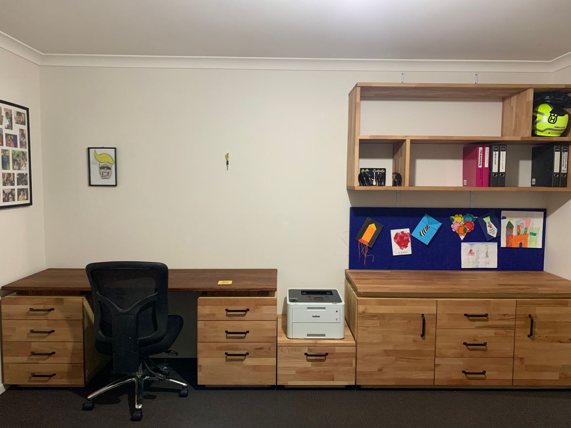

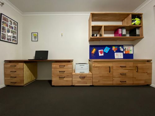

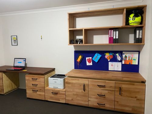

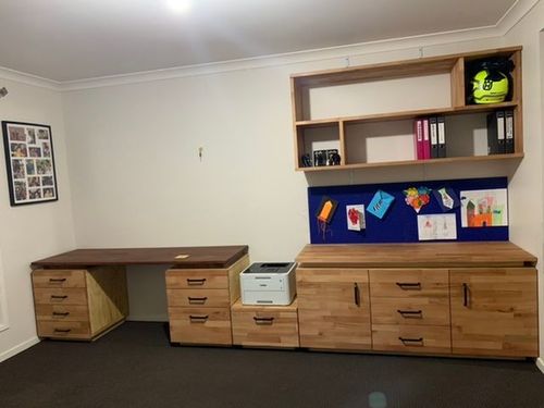

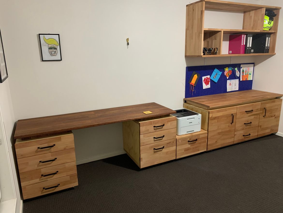

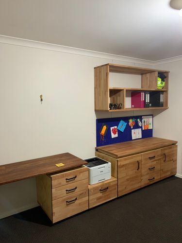

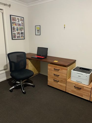

Hi Everyone,
This is my second DIY project for in-house renovations. I have completed renovation of my study by making custom furniture using my own design and with Bunnings project panel timber.
Material used
Project panels - Beech and Merbau
Deco Ply
Cabinet drawer slides and handles. Concealed hinges
Finished with linseed oil ( use caution in handling linseed oil )
I have used pocket holes to make the boxes and countersunk holes in drawers.
