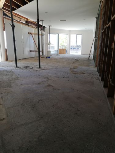

Hi, Could anyone share your expreience about what is the best way(tools) to Remove the Glue? Taa

Floor scraper is the back friendly way as it is long handled.
If you have an SDS+ drill you can get a tiling chisel which is less physical effort but lower to the ground so not so back friendly.

What do you plan on laying as the flooring in this area? As @Brad mentioned removing glue can be rather labour intensive. Since it is such a large area I would be inclined to look at whether a floor levelling product would be suitable. As long as the existing cement-based glue is sound then a leveller can be poured over the top of it.

Thanks for replying. I will try jackhammer&trolley with wider blade.

Will retiling the floor. Prefer to remove the glue first.
