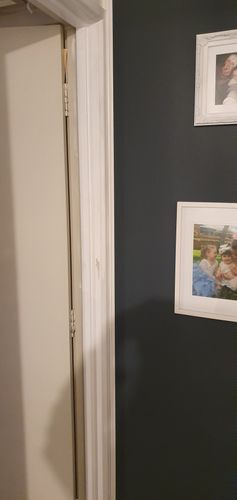

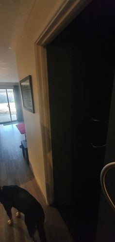

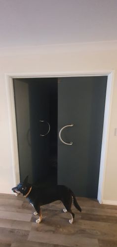

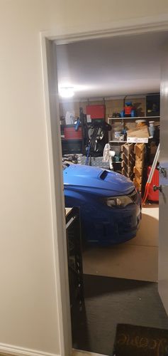

Good morning everyone, thanks for the advice. We are just wanting to paint them white, so staining is no problem.
I have attached a few photos. Some places are harder than other as they are flush against a wall or another door frame.

Hi @amclaughlin09.
There is a range of Porta mouldings which can be used individually or in a combination to give a similar look to the image I posted previously.  If you liked the look of a Colonial moulding it can be fixed to the face of the metal frame and an infill strip of something like Clear Pine Tri-quad Moulding 12 x 12mm 3.0m Porta used to blend it to the wall. It generally would be a case of taking some measurements of the metal frames profile and seeing what works with it.
Did you want just the metal covered or were you looking for a wide architrave look? Consideration will also need to be made as to how this is going to flow into your existing skirting boards.
