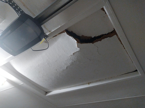

1) What board should we purchase from Bunnings for replacement if our current access panel doesn't have a standard size: 142 cm X 84.
Gyprock board? MDF board? Which one is easier to cut and more durable?
Preferably not too heavy. We are not sure if the ceiling can support heavy weight
2) What kind of Tool can we use to cut the board to our size? We have a wall board saw.
Our current panel left by previous owner was broken and rotten so we need a new one. (Frame is okay though)
Thank you for any ideas.

For me - I'd be going down the gyprock path - inexpensive and easy to cut with a Stanley knife of something similar.

It's fantastic that you've received excellent advice from @Noyade. I agree with the recommendation, I suggest using Gyprock CSR 2400 x 1200 x 10mm 2.88sqm Aquachek™ Plasterboard RE. For extra strength build a lightweight frame using 42 x 19mm 2.4m Premium Grade Dressed Pine. Make sure to paint it all around to give it an extra level of protection from moisture. I've placed a drawing for you to look at, if you have any questions, please let me know.

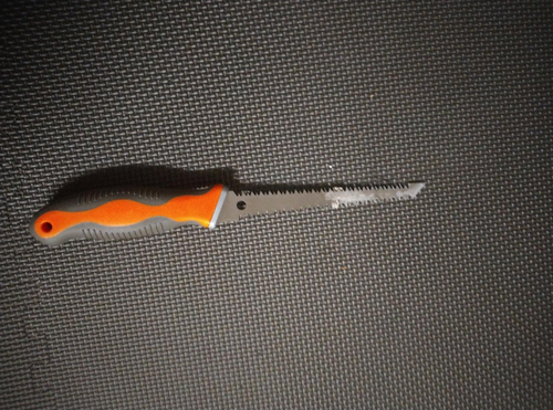

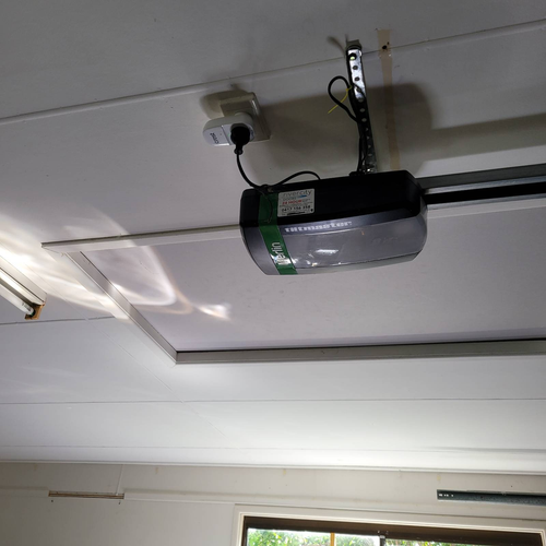

Hi, just want to update you guys, we did it!
Though there are a few lessons:
Stanley knife can cut the board
But this new knife we got has mid-sized teeth and its not very easy to have a smooth cut.
Fortunately we have a Trojan 300mm Hack Saw and we tried it and it seemed much easier, its very small teeth really made smoother cuts for us.
Just some of our observation.
Thank you guys for everything. Really learnt a lot doing this for the first time.
