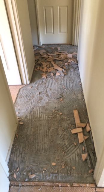

Haha my apologies, see photos below!
I'm planning on using a floor scraper to remove the left over tile glue from the concrete slab. I've considered using a levelling filler but I think I'd rather remove it all for a fresh start. Open to any recommendations on removal methods as there is quite a lot to take off.
Great work, @Schupfer!
I'd recommend a rotary hammer drill with the biggest flat-bladed SDS chisel bit possible.
