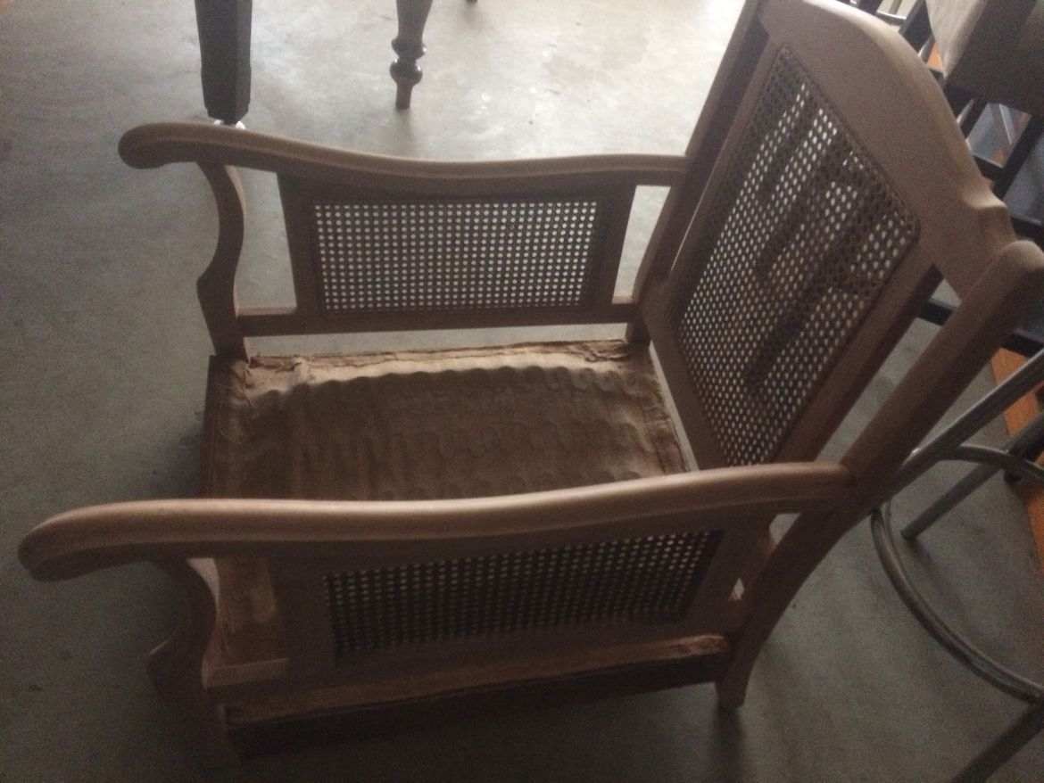

lately,i have just been playing on the scrolllsaw,but i was recently given an antique couch with 2 armchairs that were headed to the tip.so i have decided to restore them.this is going to be one of those slow and steady projects that will be done in between other projects,so it could take a fair while.i know i could jump on the power tools to speed things up but this project deserves to be done manually,so i have a lot of sanding to do ,so let the fun begin.

Hi,@kay

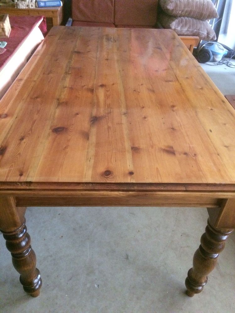

at this stage i am not sure about the finish that i will do,usually my wife and i have very different ideas how the end product will look. At the moment i have got one seat completely stripped back and the other is about half done. Haven’t touched the couch yet. I have recently done a table, which jas come up good. Cjeers kel9D695953-12E9-4FA3-AA7D-B8CCEF549EC7.jpeg

Love the style of the furniture! Do you upholster it yourself or outsource it? I know it can be quite expensive to reupholster furniture, so I was considering doing it myself. Not sure how hard that would be though considering I have never done it before.
The table also looks great! What did you use to get the glossy finish? We recently scratched our bedside table and are considering painting the top again, but not sure what to use for the glossy shine.

hi kay,the  lounge set ,i will eventually recover it myself.as for the table,i used a wipe-on poly(from bunnings),i applied 3 coats,then i just lightly sanded and applied another coat,i did this for a further 3 coats then sanded and applied a final coat of poly with a brush.i intend to give it a final sanding with wet'n'dry sandpaper then applied polish and buff it.that should result in a glass like finish.
