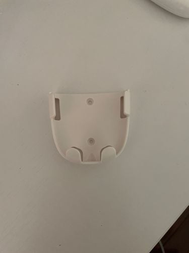

Simple question - I want to fix DC fan  remote cradles to plasterboard walls, not into studs. The holes in the plastic cradle only take 4g screws and are only 3cm apart.
Wallmate anchors say to use them 10cm apart at minimum to avoid compromising the plasterboard strength. And besides they only suit larger gauge screws.
Any suggestions - I’ve often seen these cradles falling off the wall in AirBnB’s because they haven’t been attached properly and I want to avoid that. Thanks

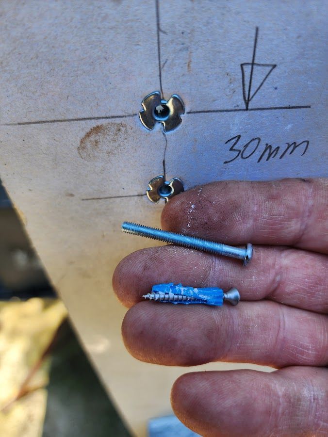

I have a dull life and been outside playing with anchoring styles with gyprock.
Around six styles and plenty of photos if you wish to see.
But at the end of the day the best anchorage (that resisted a pry bar force) was the Ramset style expanding hollow anchor.
M4 X 32mm.
Enough pressure to 'dimple' the gyprock surface for a flush fit and I personally would be grinding the head diameter down to fit the recess in the cradle.

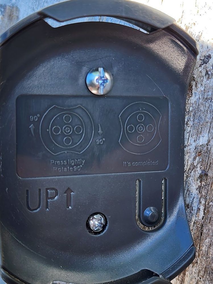

I don't have your 'cradle' @swmw
But this seems close - for a Bunnings Ironhorse fan usually mounted on a wall.
Both screws are from the Ramset syle anchorage system as I illustrated above. The top is the original 7mm diameter.
The lower has had the head diameter reduced with twenty seconds on a bench grinder.
It now fits below the surface of the plastic.
