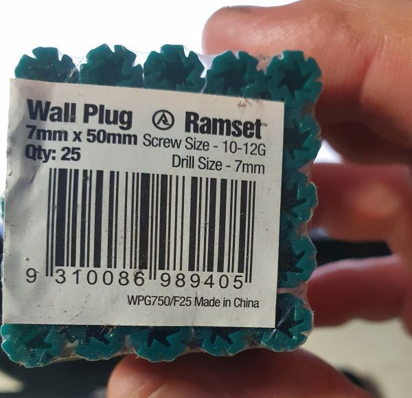

Hi Gote.
Unless Ramset have changed the packaging - on the outer cellophane wrapping you will find the screw size and dill size (recommended) on the top right of the label.
Years ago, I think they used to have these details on the plastic band that held them together?

Thanks @MitchellMc, yes this is what I was after, thank you! I can read the size recommendation on the packaging, but I couldn't find anything that told me what type of screw to use, i.e. timber, metal, plasterboard, general purpose, etc. And timber screws in masonry certainly isn't intuitive!
The STAHL masonry kits are great for an initial purchase but I need more than 10 plugs/screws so unless a masonry drill bit is only expected to last about 10 holes, I need to buy some plugs and screws separately.
Rgarding the plugs that come with the STAHL masonry kits, I notice the size recommendations are different to the ones for the Ramset plugs of the same colour. E.g., the green STAHL plugs says 8g screws but the green Ramset plugs say 10-12g. Is the colour-coding not standard across brands?
Are the green ramset plugs roughly equivalent to the blue STAHL plugs?
I can understand the confusion as there are no plastic screws, which is what you're screwing into. A timber or general-purpose screw is fine for wall plugs. You just need something with a somewhat coarse thread. Avoid fine thread metal screws as they don't cut in well to the plastic and can pull out.
To the best of my knowledge, I believe the colours are standardised, but after @Noyade's comment, it's got me thinking. The colour denotes the drill size, which is the same between both brands. Green plug = 7mm drill bit. What I think is happening here is that STAHL is making their plugs to suit smaller sized screws, and the wall thickness of the plug determines this.
