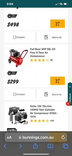

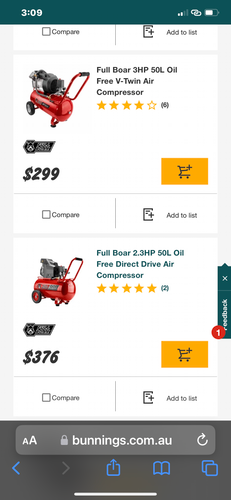

What’s the difference between these two full boar air compressor

It's great that you've received excellent advice from @MikeTNZ. Although both units have a lot of similarities, the main difference is that the Full Boar 3HP 50L Oil Free V-Twin Air Compressor is ideal for powering a wide range of air tools, requiring low to high air volume. It's also rated for spray painting and has a motor with higher horsepower.
The Full Boar 2.3HP 50L Oil Free Direct Drive Air Compressor on the other hand is only capable of powering tools requiring low to medium air volumes such as nail guns, drills, impact drivers and shears. It has a lower maximum working pressure and does not provide the same amount of free air delivery.
My best advice is to look carefully at your spray gun requirements and match them to the compressor. Just keep in mind that mobile compressors are nothing like stand-alone shop compressors that have large reserve tanks. You'll need to factor in the reloading time of the mobile compressor when doing large projects.
