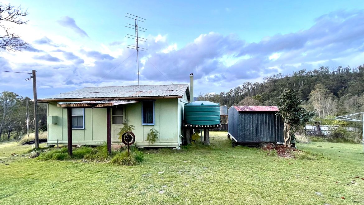

She's a little 1 bedder fibro number, with a little living area, dining space and kitchen, with a bathroom. The toot used to be an outhouse but had to be pulled down, so a septic and toot need to be done as one of the first items with the paint, so if you see someone staring endlessly at the range at Bunnings it will be me :laugh:
The old Zip instant hot water system over the bath is dripping rust stains, so I think it's time to go for it also. The kitchen had a pot belly ages ago, and I'm thinking this will be the perfect place to have a rangehood and an induction cooktop put in.
I could go on and on, but these are some of the early things to be done, and I can't wait!

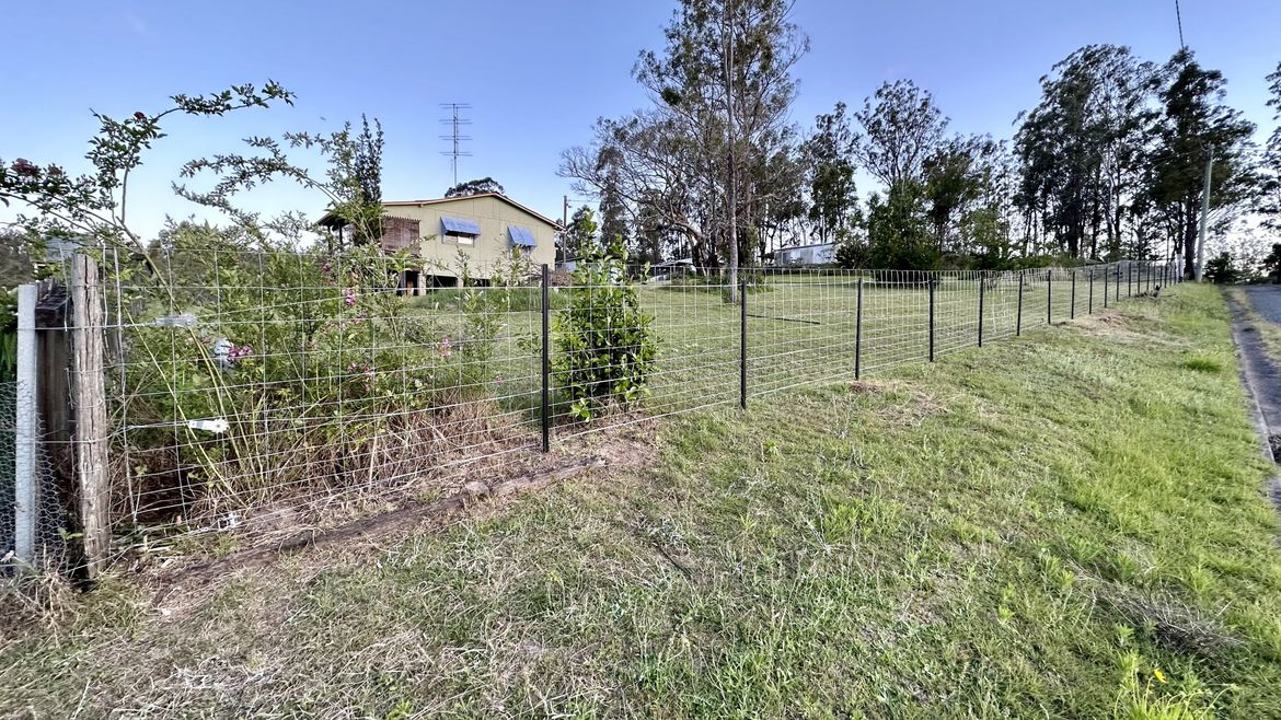

Well, I have finished building my first ever fence! What a learning curve 😀
As I will eventually be relocating my mini sausage dogs to the country with me, this was my first major project. This fence faces the street and is 40m long. I got the wire mesh and posts from Bunnings, however my local store doesn't carry everything needed, so some products were sourced elsewhere. I used 2x rolls of Longyard mesh, 2x packs of 10 Longyard pickets, post driver, netting clips, netting clip pliers, fencing tool, straining wire, strainers, large fencing pliers, U nails, hammer, spirit level, masking tape; I think that covers it.
Given that we'd had a lot of rain just before building the fence, driving the posts in manually was quite easy. The pickets are 180cm tall, and the mesh is 120cm tall, so I drove the pickets in 60cm. I used masking tape on each post to show where the post had to be driven in to. A friend recommended I run the straining wire through the holes in each picket, and plat it through the mesh, however an extremely knowledgable and friendly staff member at a local ag store ran me through the go to whoa of building this thing, and advised me against doing either. In short, running the straining wire through the posts introduces rubbing, eroding the protection to the post and the wire, and allowing rust and wear to shorten the fences lifespan.
The posts were driven into the ground at around 2 metre spans, then the straining wire was run along between the existing straining posts, then strained and and clipped to each picket. Then using netting clips, I clipped the mesh to the straining wire at each post, and midway in between each post. Those little wire strainers were so easy to use, and as this fence is 40m long, I installed them at both ends for extra oomph.

That fence looks terrific, @BoeingFan, and I trust your mini sausage dogs will be contained well.
I suspect you've pulled the bottom straining wire taught, but check at the mid-point between two posts that you can't lift the mesh up at all. Typically, this type of fence is excellent for livestock, but a small dog might nose its way under the mid-section. A 450mm tent peg in the middle of each fence segment should hold it down nicely and prevent escape attempts.
Fantastic work, and I can't wait to see what project you tackle next.

Thank you, it was quite satisfying to finish it. Whilst nowhere near perfect, it was great to learn how to do it, and use those lessons for the second one, which is almost finished. I've clipped the netting at each post, and also in each mid section to help stop it from being lifted, but that's a great idea re the tent pole in the between each post, I'll be sure to do that.

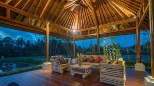

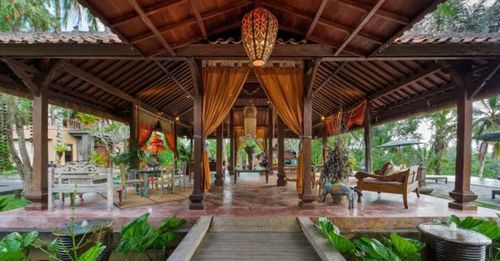

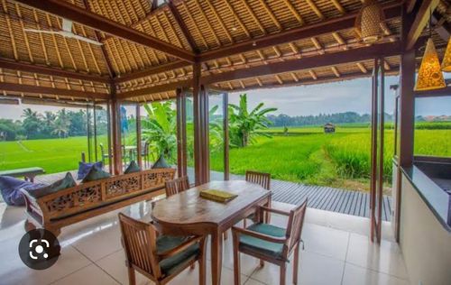

Wow this is one of the most fun projects I’ve seen for ages!
With a small building and a tropical climate, could I suggest you look to Balinese villas for inspiration? Not the first or cheapest thing to do, but that’s where I’d be heading with this place. Outdoor living and bathroom with an air conditioned bedroom.
A deck or pavers with a roof out the front would double your living space and hide the fibro-ness.  Plant the right tropical plants and they’ll take care of themselves.
Paint is your best friend inside. Ask the locals for their tips on keeping damp and mould at bay.
Congratulations @BoeingFan ! Take lots of before pictures now as this will be amazing.
