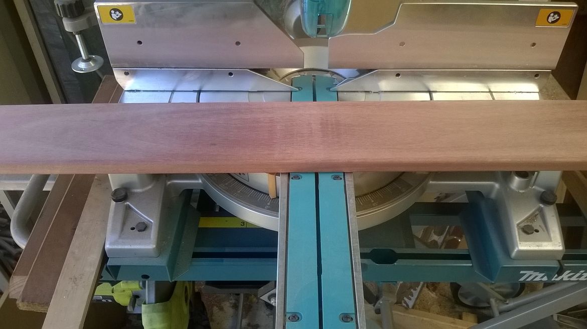

First off select a piece of timber suitable for job at hand. For this piece I decided on a piece of Jarrah 120 x 19 x 1150. Unfortunately I didn't have any offcuts available. And by all means you can use old timber for that vintage look.

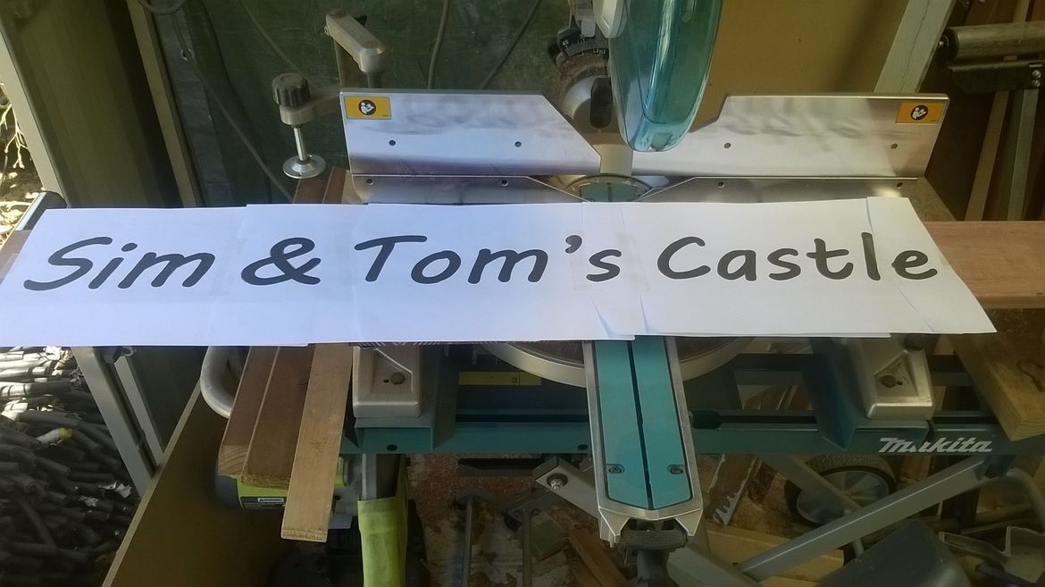

Create the template on your computer with whatever font/text you like.

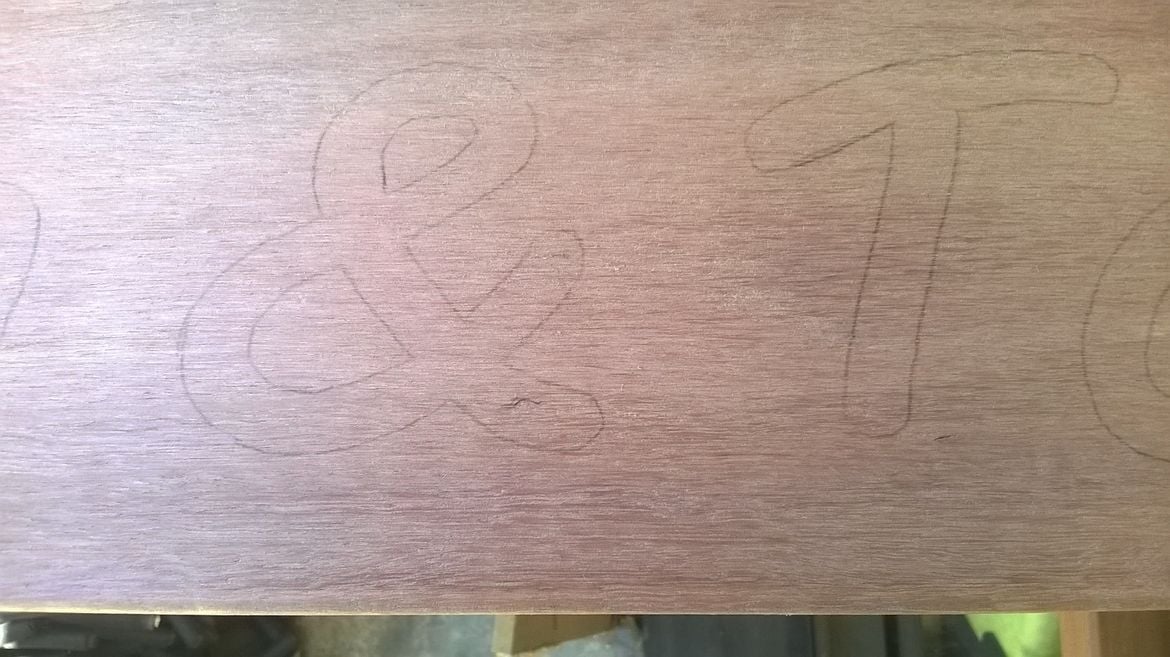

Position the template and using carbon paper, trace the words onto the timber.

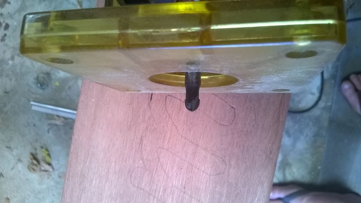

Now the tricky part. I used a small cove router bit for this one as I like the 3d effect the rounded edges give. I also use a smaller router/trimmer as it gives me more control.
With the bit set at about 4mm, carefully trim out the letters.

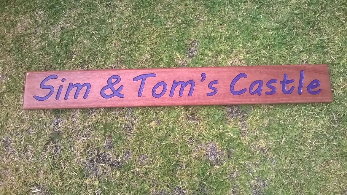

Now with whatever colour you want (the choice is endless), paint the letters with at least 3 coats leaving drying time between coats. Then sand with 180 grit sandpaper to get rid of any mistakes. Coat with 3 coats of clear estapol gloss sanding with at least 240 grit inbetween coats. I always use exterior grade but again, you could use any clear finish you have available.
In this case, I have used purple as it is Simones favourite colour. Tom doesn't get a say in the matter.
I have hung these by either drilling a couple of holes in the sign and screwing direct to wall, or putting screw in hooks on top and hanging by a nice chain/rope.
NOTE: I have found that if using white as your letter colour, it will discolour due to the natural pigments in the clear coat. Of course you could always apply another coat of white if you have steady hands.
Amount of coats is also dependent on the coverage. I tend to use 3 of each.
Brighter/lighter colours work well with darker timber and darker colours work well with lighter timber.
