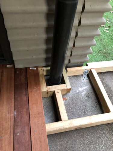

Hi all, I’m building a deck for my brother (with plans I got from the various other contributors on this portal). What’s the best way to be able to trace the stormwater pipe and transfer it onto a decking board to get some snug fits?

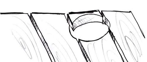

@Bomber25 how about this. Bit of a work and measurement. I would suggest keep this patches separate so that it becomes convenient for you to open the patch (instead of unscrewing the whole plank) to do any repair work on the pipe (if any issues with drainage in future)

Looking closer at your photo - my method would leave you with an annoying piece behind the pipe?

Yer I knew that I would have to do that, I put a bit of frame behind the pipe already. If I can get a right angled drill bit attachment then I (should) be able to put it in

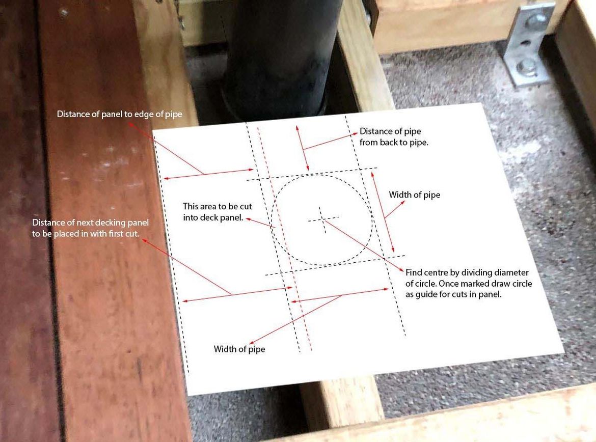

My apologies for the late reply. My suggested cutting technique is not too far off from @Noyade's suggestion. In order to get a very good cut into your decking panel, I recommend making a cardboard template. Ensure that the cardboard is nice and square before you begin.
Here are the steps:
I've placed an example of the template below, please let me know what you think.
