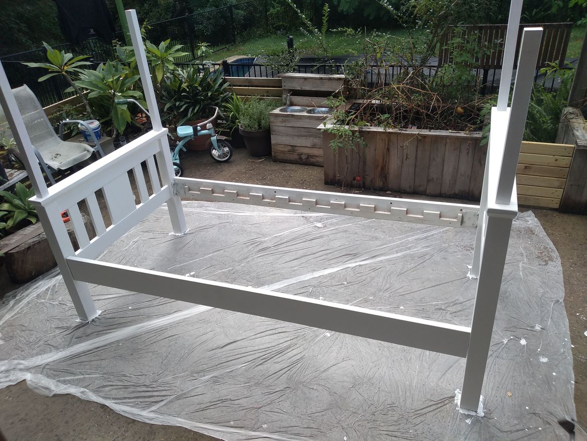

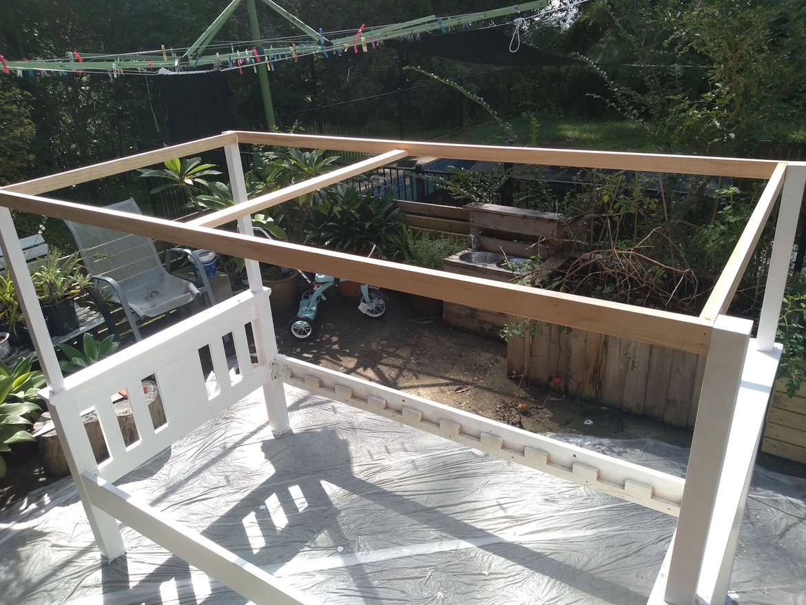

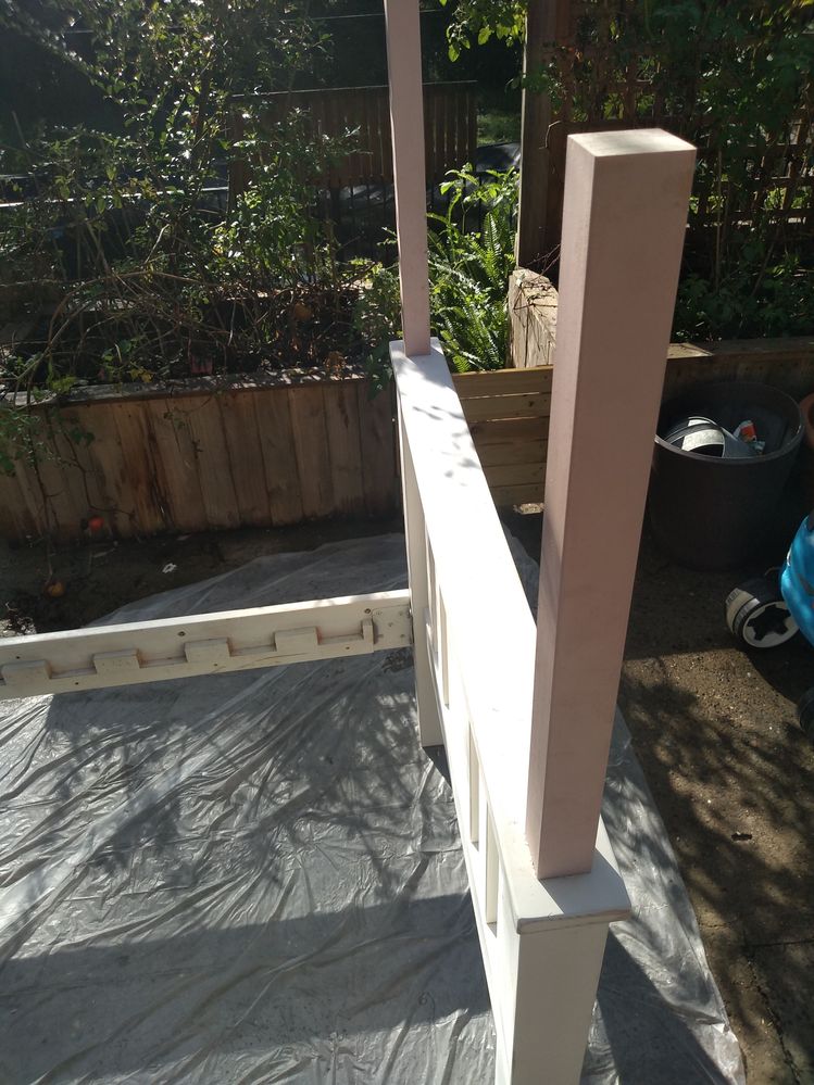

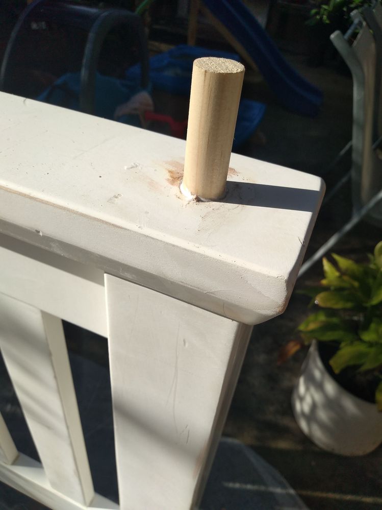

I knew I needed to build a canopy, and that would require support. I drilled holes in the headboard and base to glue in dowels. The dowels would allow me to connect 42mm x 42mm uprights with corresponding holes to them.
I used Dulux Precision primer over the existing gloss paint as it has the best adhesion on stubborn surfaces. I then top coated with Dulux Aquanamel.

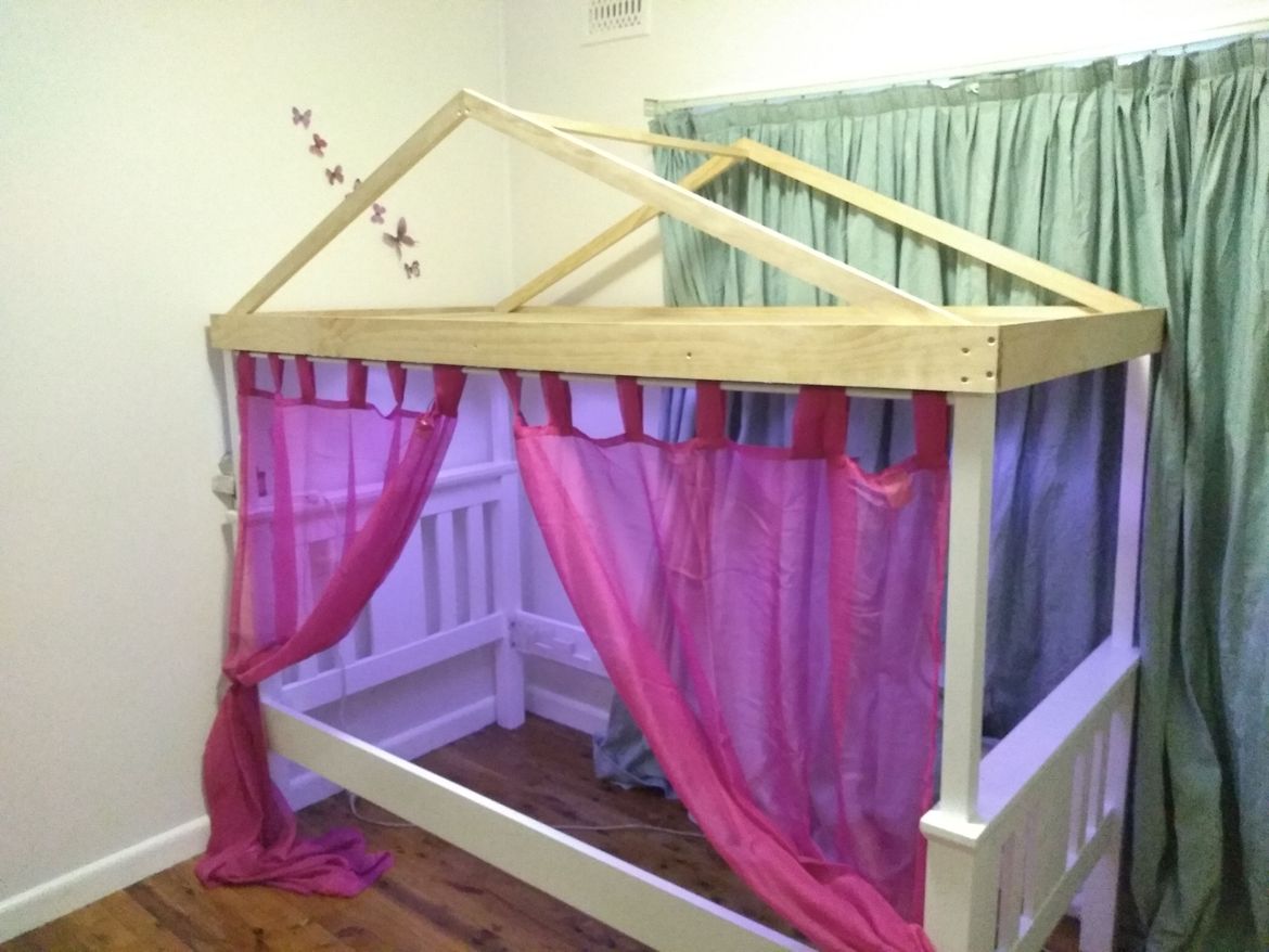

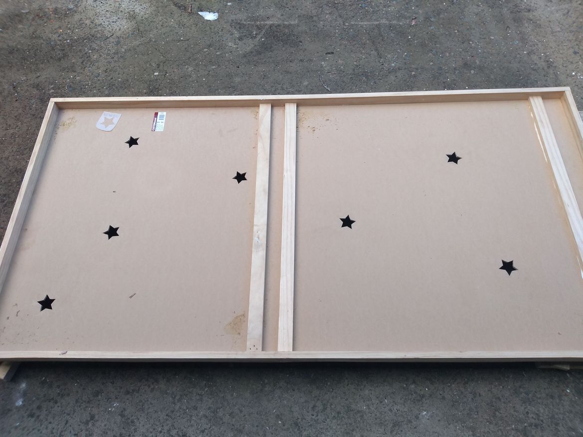

I built the canopy frame out of 42mm x 19mm x 2.4m premium-grade dressed Pine and temporarily fixed it in place to make sure everything would fit when reassembled inside.

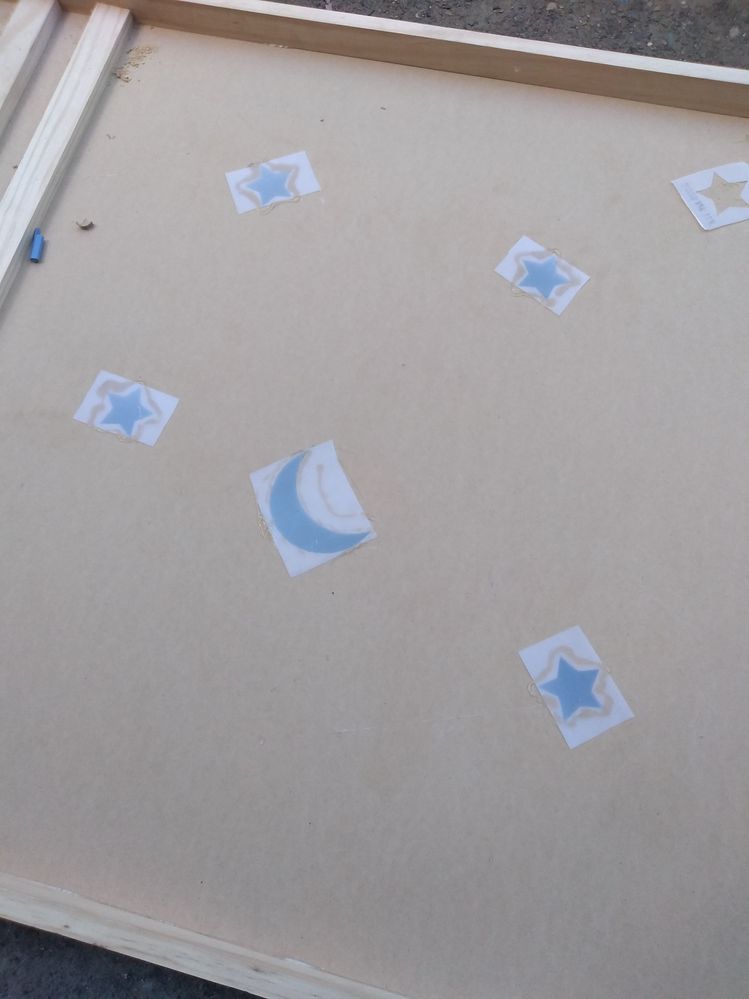

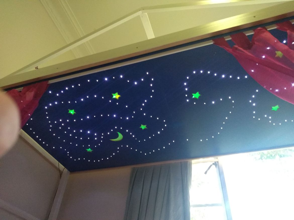

I glued and screwed a CustomWood 2440mm x 1220mm x 6mm standard MDF panel onto the bottom of the canopy frame. I then cut out some star shapes with my jigsaw. I cut up a plastic milk container and glued the pieces on top of the cutouts. This would allow light to transfer through them later.

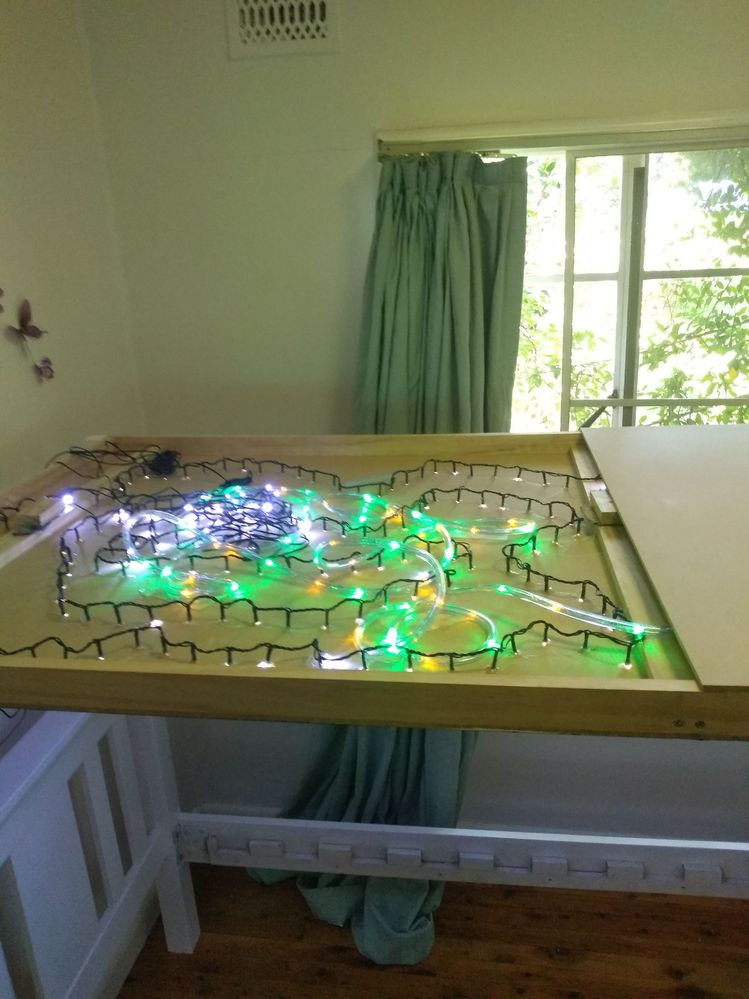

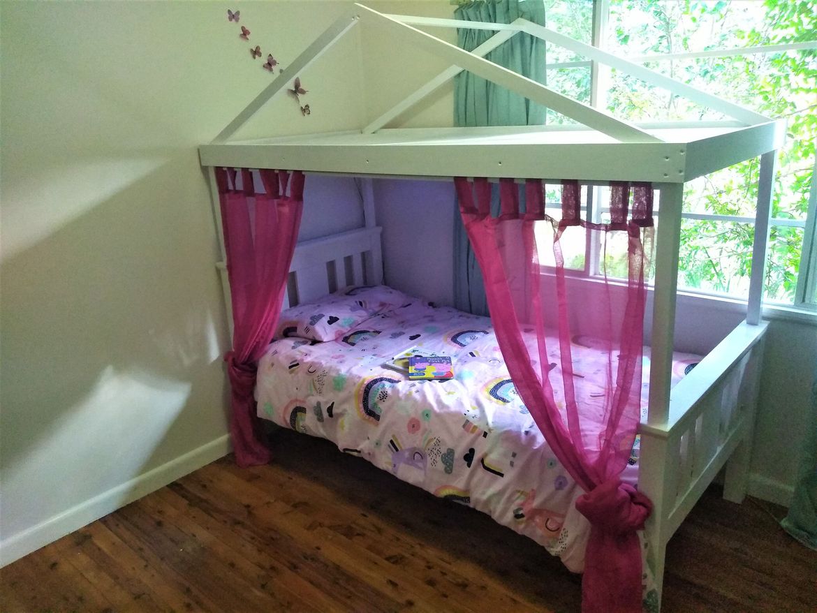

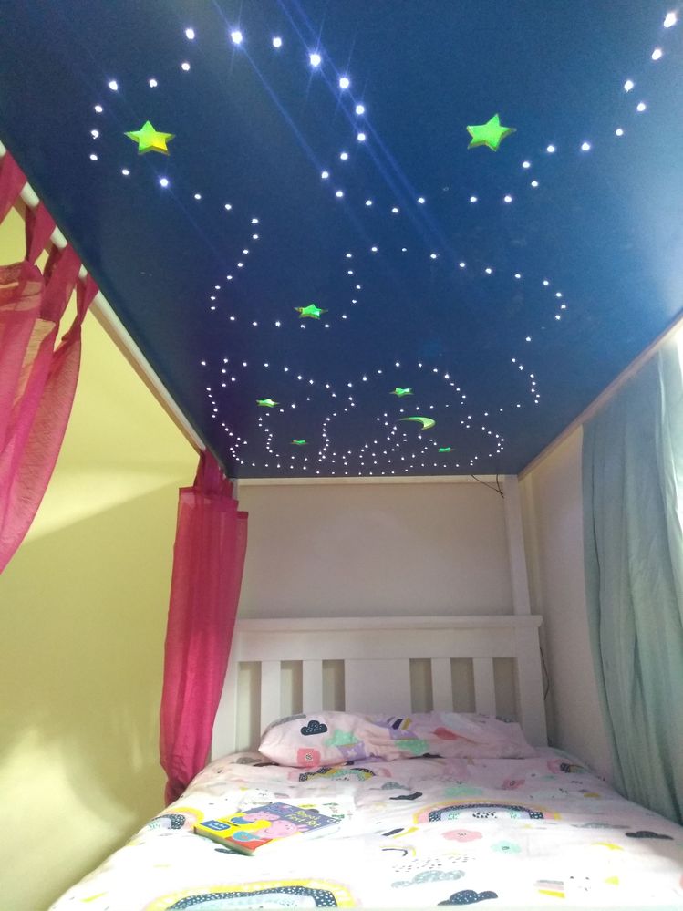

I decided just the cut-out shapes weren't doing it for me, and it needed a bit more "Wow!" factor, so I drilled 150 4mm holes and glued in LED lights. A rope light would provide the colours for the star cutouts and moon. A second 6mm MDF skin was added to enclose the lighting. The top also looked a bit boring, so I created a bit of a roof and added trim pieces around the sides to finish it. A curtain rail and curtains were added as requested.

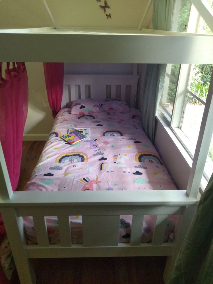

A final coat of paint and bedding was added to complete the look, and my job was done. As expected, a little girl was loving her new big-girl bed to bits. I'm one happy dad!
The stars twinkle and have function settings similar to Christmas lights. Although all these lights are low-voltage and LED, they're only left on for bedtime stories and then immediately switched off.

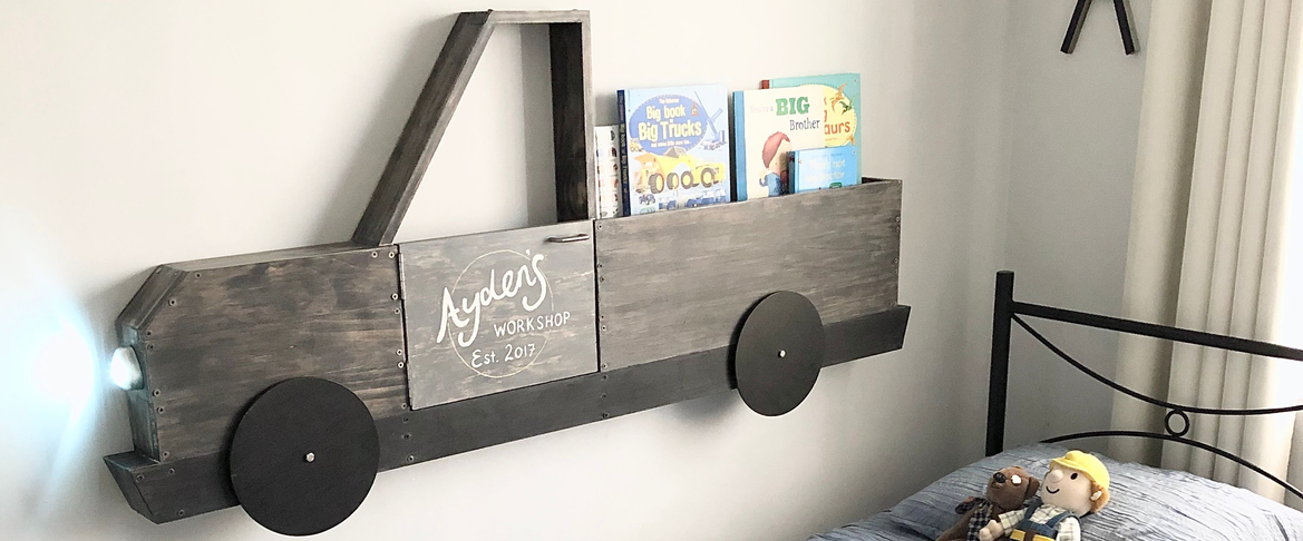

Jess also built this ute-shaped bookshelf for her son, complete with a headlight that can be used as a night light.

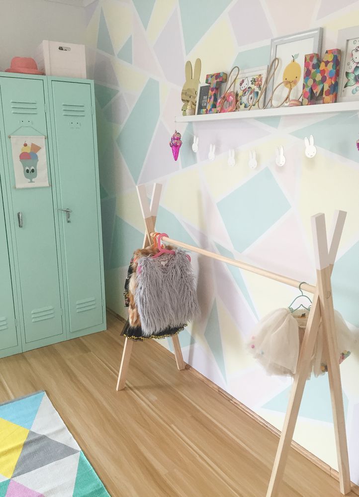

Workshop member ProjectPete made this simple but functional kids teepee clothes rack.
