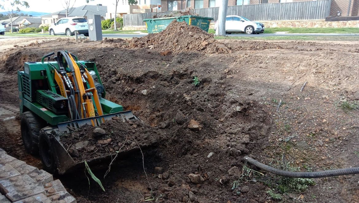

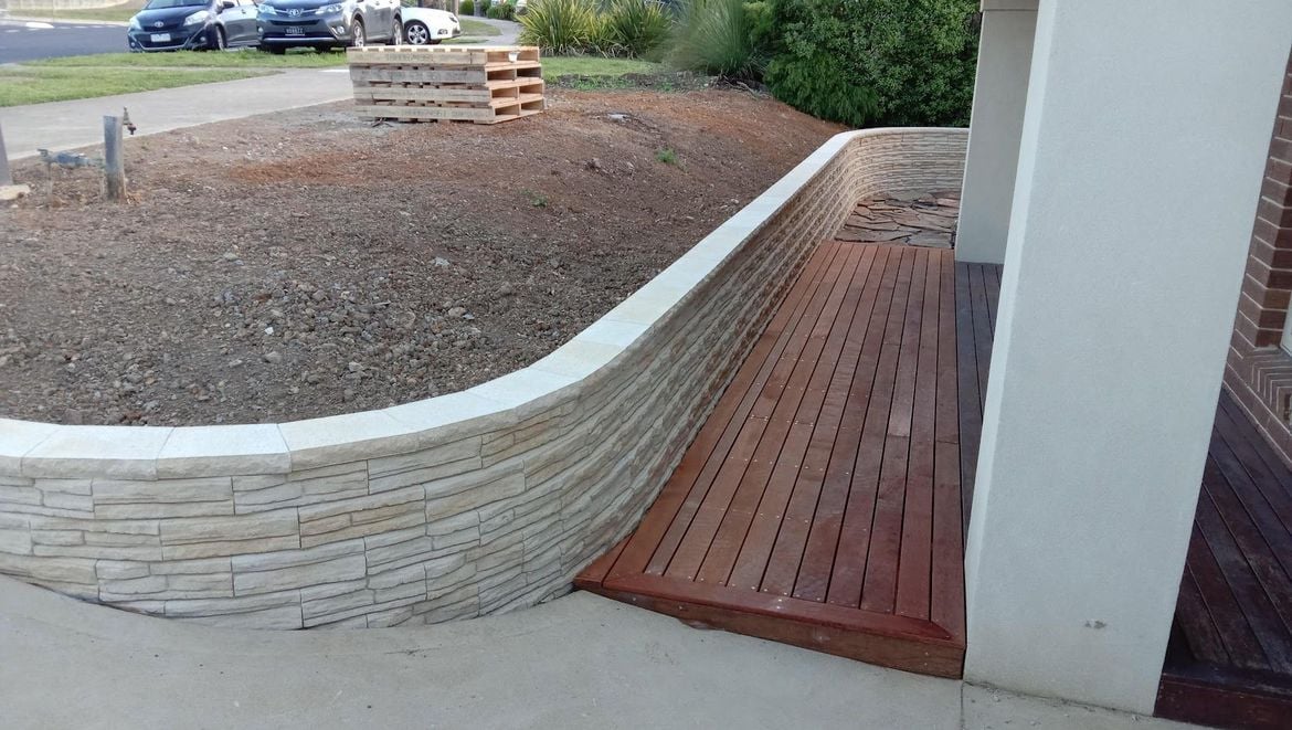

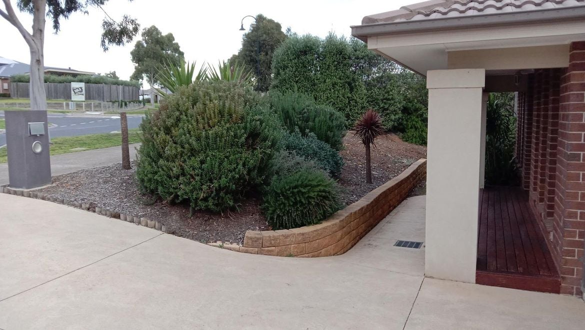

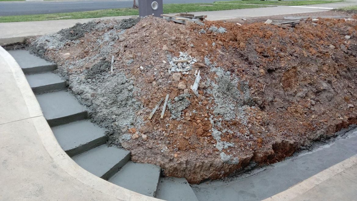

When we bought our house we knew that we wanted to redo the front landscaping. I ripped out the sinking retaining wall, hired a Kanga mini-loader and excavated the whole yard.

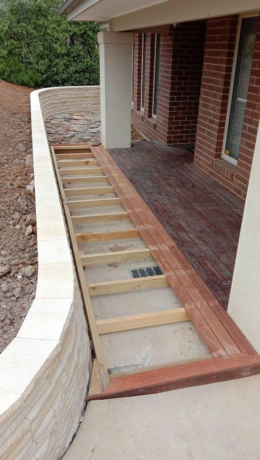

I extended the front deck, concreted footings for my new retaining wall, installed drainage and crazy paving, built a new stone retaining wall with some neat curves and began planting away.
I did need to get a friend in to install the large boulders with his excavator. No chance of me lifting those!
The Kanga doesn't need a licence. In an hour you'll become an expert, and it's incredibly fun and satisfying.

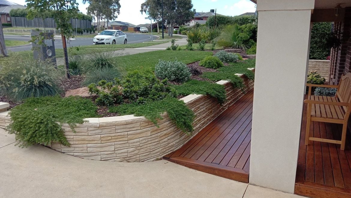

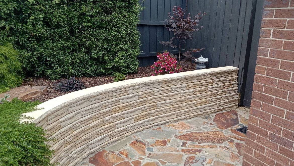

The stones I used for the retaining wall are Adbri Natural Impressions. They are easy to work with as long as the concrete footings are level and solid.
If you're creating curves like I did, you can just chip away the lip underneath the block with a hammer and chisel to allow for the curving. I used Liquid Nails Landscape as extra reinforcing on all the curves and the capping.

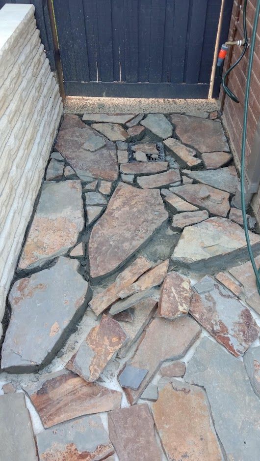

I did the crazy paving myself. It wasn't too much trouble keeping the mortar off the face of the slate. When I laid the pavers I tried to keep everything as clean as possible and kept a sponge and bucket of clean water handy at all times.
When I applied grout, I used a dry mix and swept it in, followed by a mist spray of the hose every few minutes. The whole time I tried to keep everything as clean as possible to limit clean-up afterwards. I then used an acid to remove any excess grout on the pavers.
I had previously done the same paving in the backyard – but about 50 square metres. I relied heavily on the acid doing its job but it also removed a bit of the grout itself. I found that the deeper and cleaner the lines for the grout were, the easier it was to apply and the less likely it was for the grout to break away in time.
The deck got an extension.

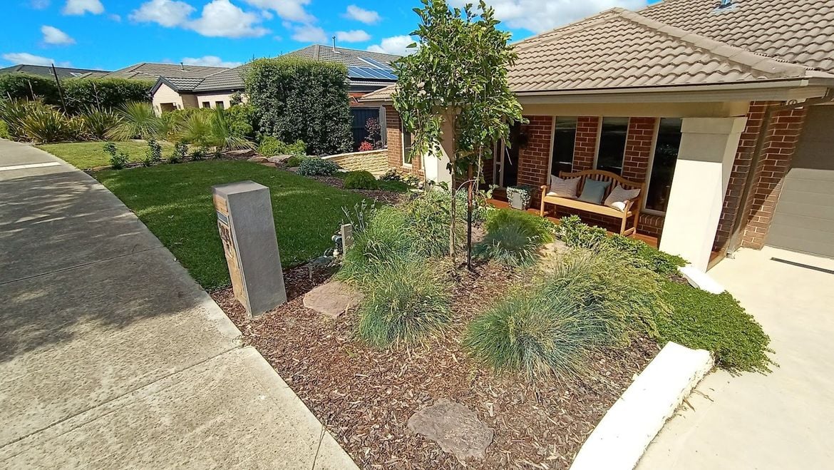

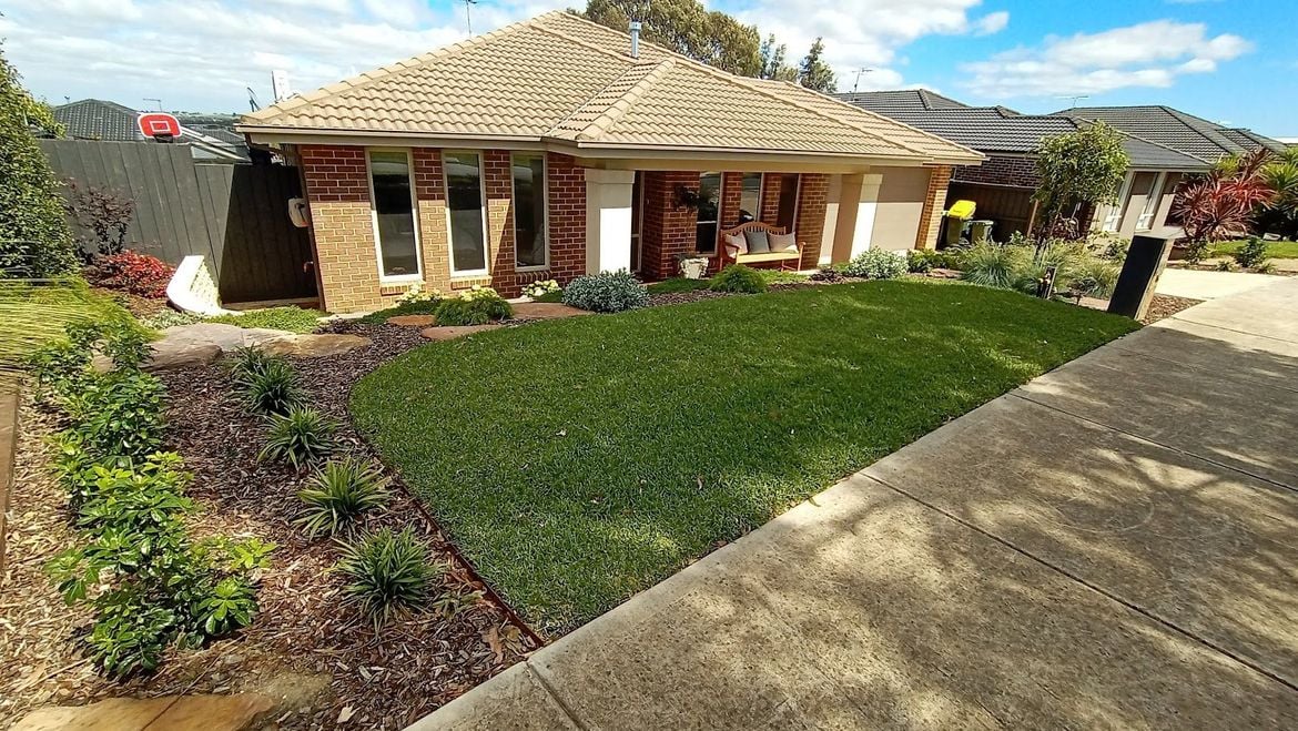

And I installed a sprinkler and drip system for the whole yard.
It has created a nice haven for us that we enjoy every day.
