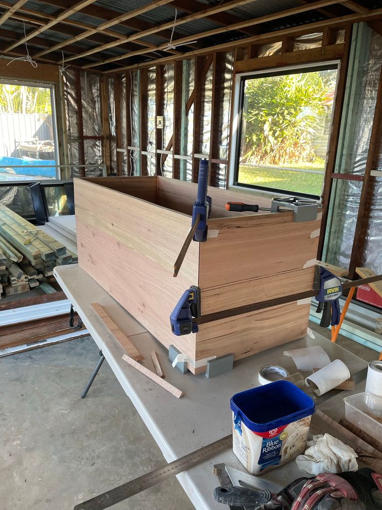

Using the Tassie Oak panel 1200 x 600 x 19 mm, I mitred the edges and glued them together using corner clamps.

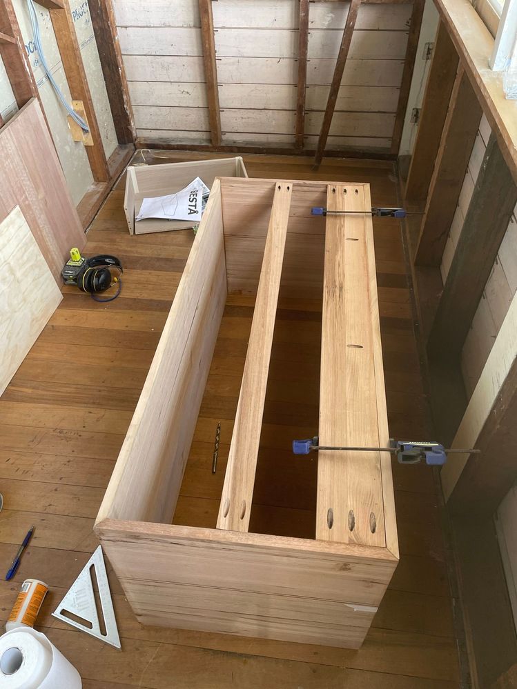

For support: I added timber on the back (helped with mounting to the wall), brackets underneath the bench top and used timber screws to secure the bottom.
