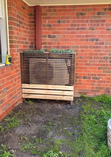

- We started by measuring around the a/c condenser unit to make sure there was plenty of clearance in front for ventilation and air flow as well as space to accommodate some planter boxes up top.
- We concreted in the corner post and fixed two treated pine lengths to the brick.
- We then created 3 holders on the top for the 3 planter boxes to drop into (we used the Whites 495mm Charcoal Outdoor Garden Up Classic Pot)
- We attached the merbau screening to the posts and for the bottom section, we used treated timber fence palings.
- To finish, we painted everything in Dulux 'Monument'

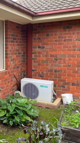

BEFORE:
BEFORE: Old a/c condenser unit sitting on the ground with a brick edging
Installed a new unit and had it raised off the ground:

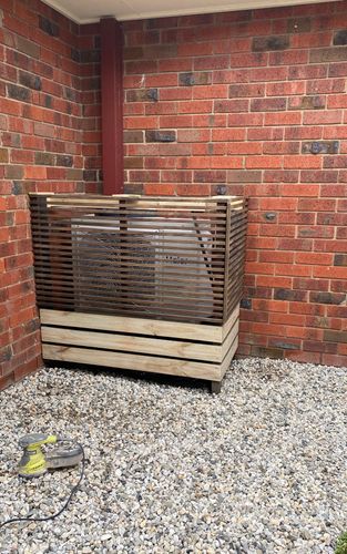

Sanded with 120 grit and cleaned to prep for painting:

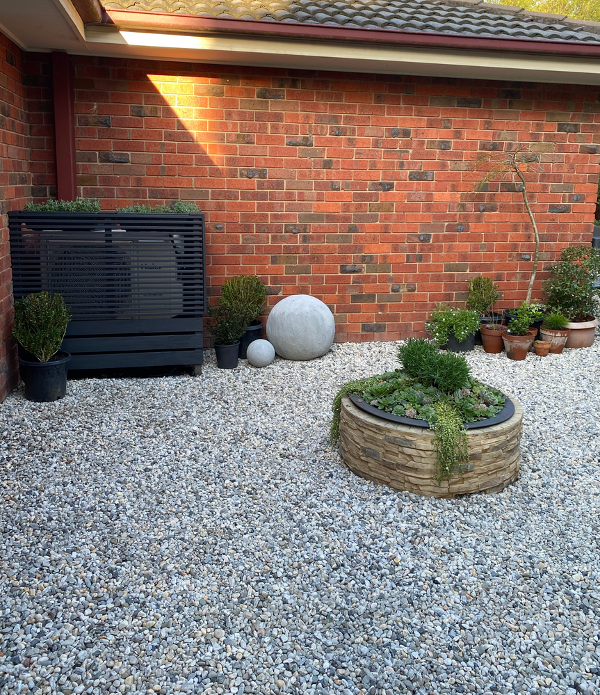

(Buxus placed in front of screening for the photo only. It will be moved so as not to block air flow)
Courtyard/Pebbled area for potted plants. (Buxus placed in front of screening for photo purpose only. It will be moved so as not to block air flow)
