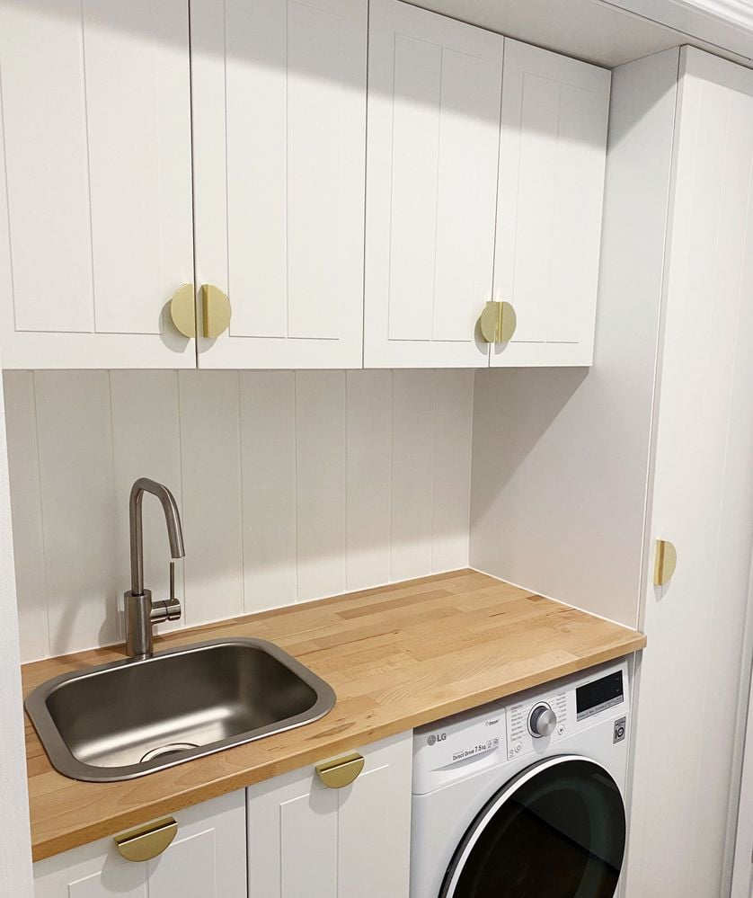

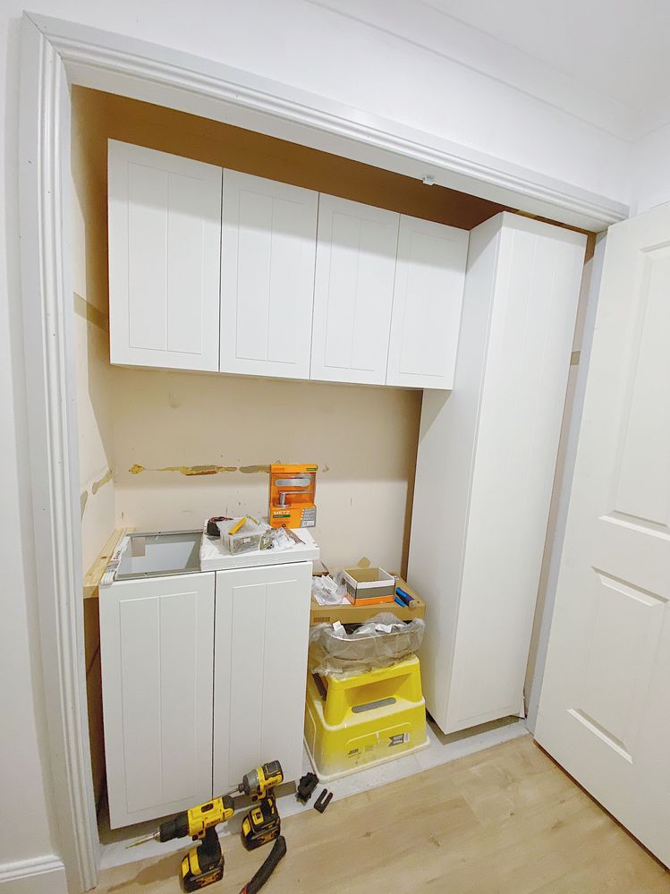

As part of our house renovation, we converted the old laundry room into a home office/extra bedroom and moved the laundry into a European-style laundry cupboard in the hallway.
Turning the linen cupboard into a laundry required moving a doorway, trenching plumbing wastes, plumbing new hot and cold water for the laundry sink and washing machine and running electricity inside the cupboard for the washing machine and small appliances.
Once all the plumbing and electrical work was done, here's what we did:

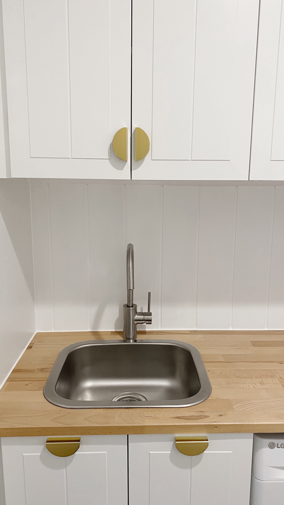

- Assembled flat pack laundry cabinetry (IKEA Metod carcasses with Stensund door fronts)
- Installed and connected the plumbing fittings under the sink cupboard for the laundry sink and washing machine
- Cut and installed the Beech benchtop from Bunnings after routering the edges
- Installed noggins for the filler panels to fix onto around the cabinetry
- Measured, cut and installed white melamine filler panels to box in the cabinetry
- Installed new door architraves and painted them with the same Dulux Semi Gloss Vivid White

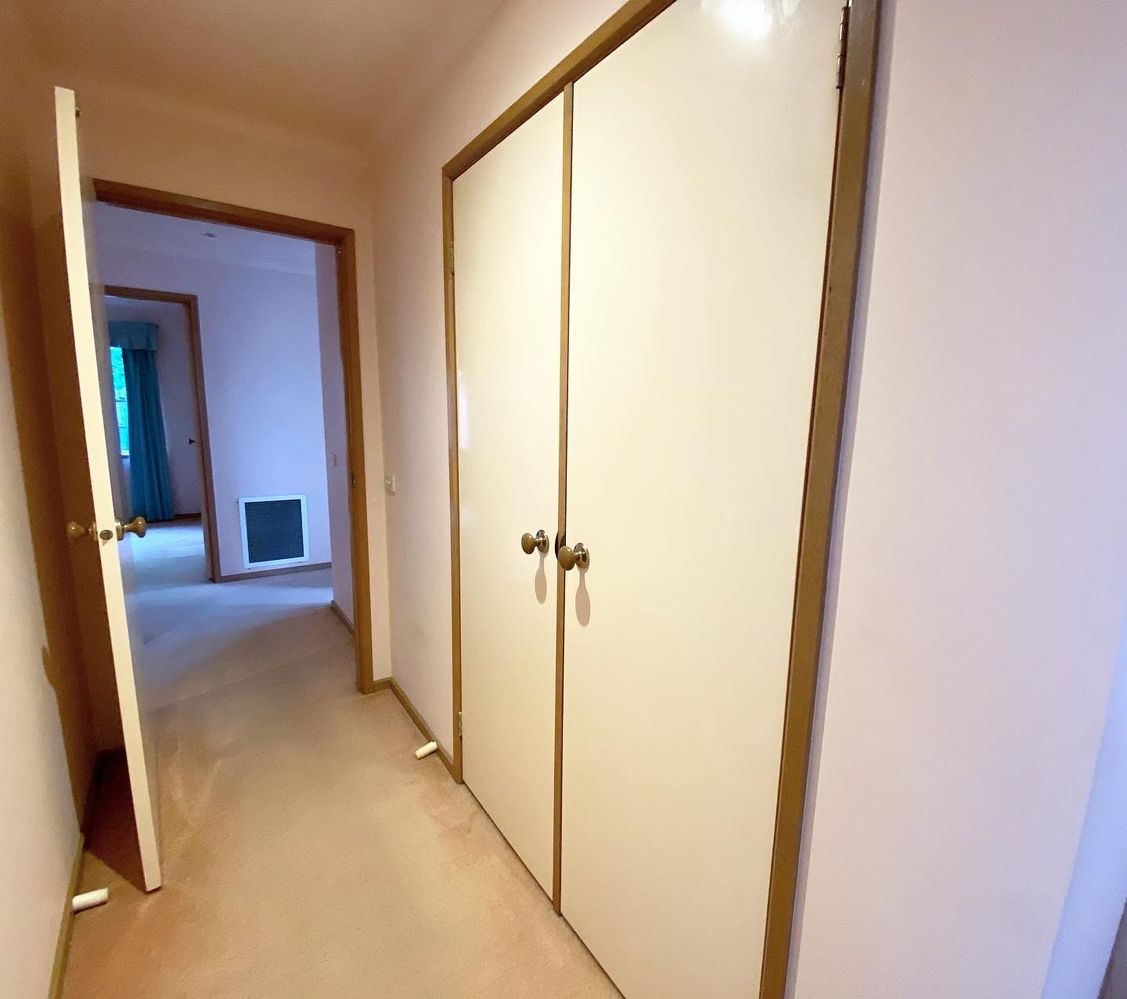

The original linen cupboard.

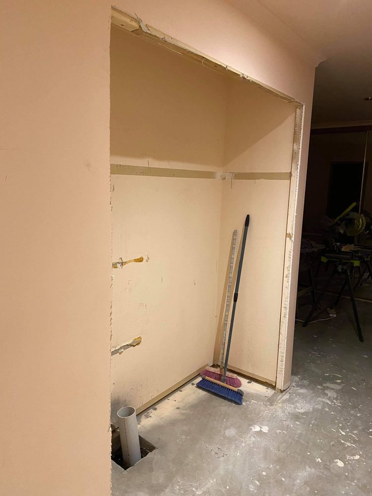

We removed the cupboard doors, shelves and architraves.

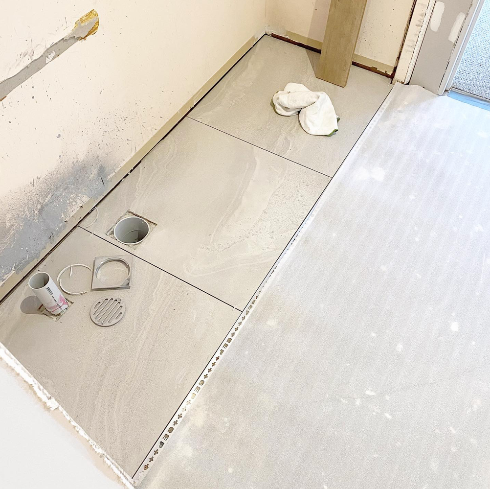

New plumbing wastes. Tile mock-up and tile trim edge installed.

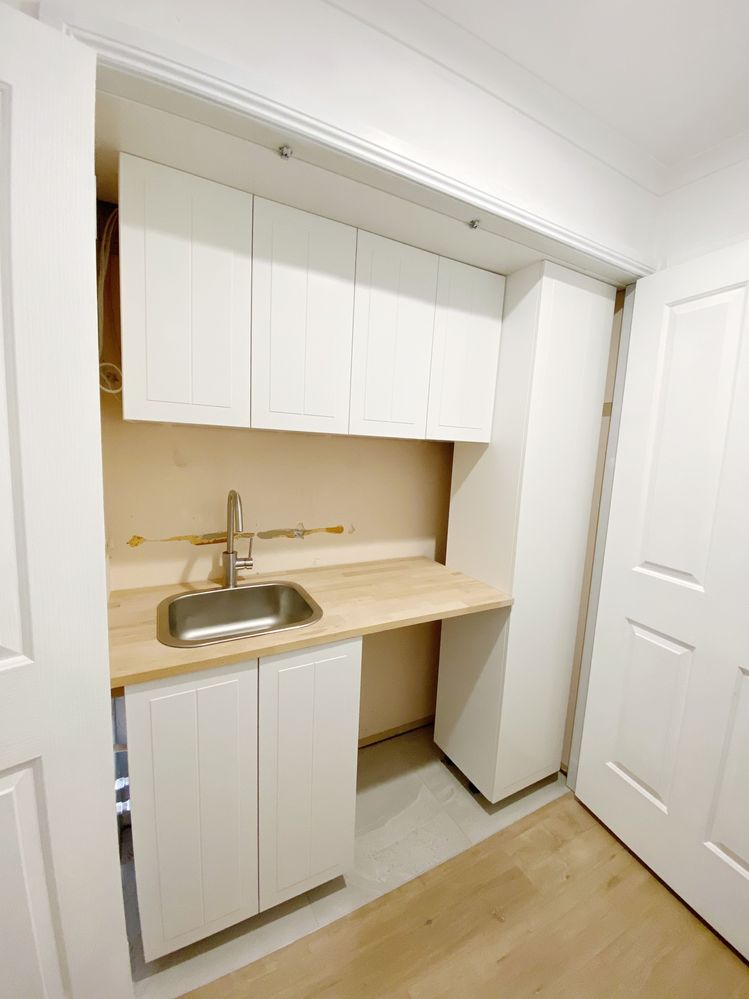

Cabinets installed.
Benchtop installed.
It was a bit of a compromise not being able to fit in a dryer or have much bench space to fold clothes but I think converting our old laundry room into a home office and bedroom was a better use of the space.
