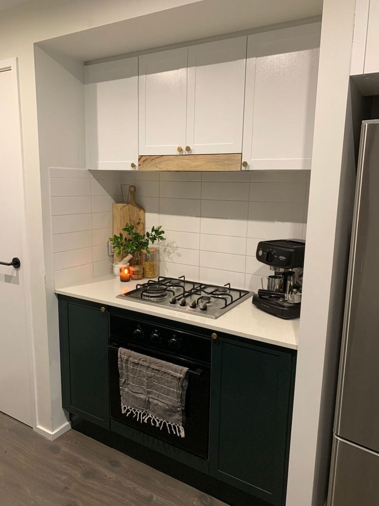

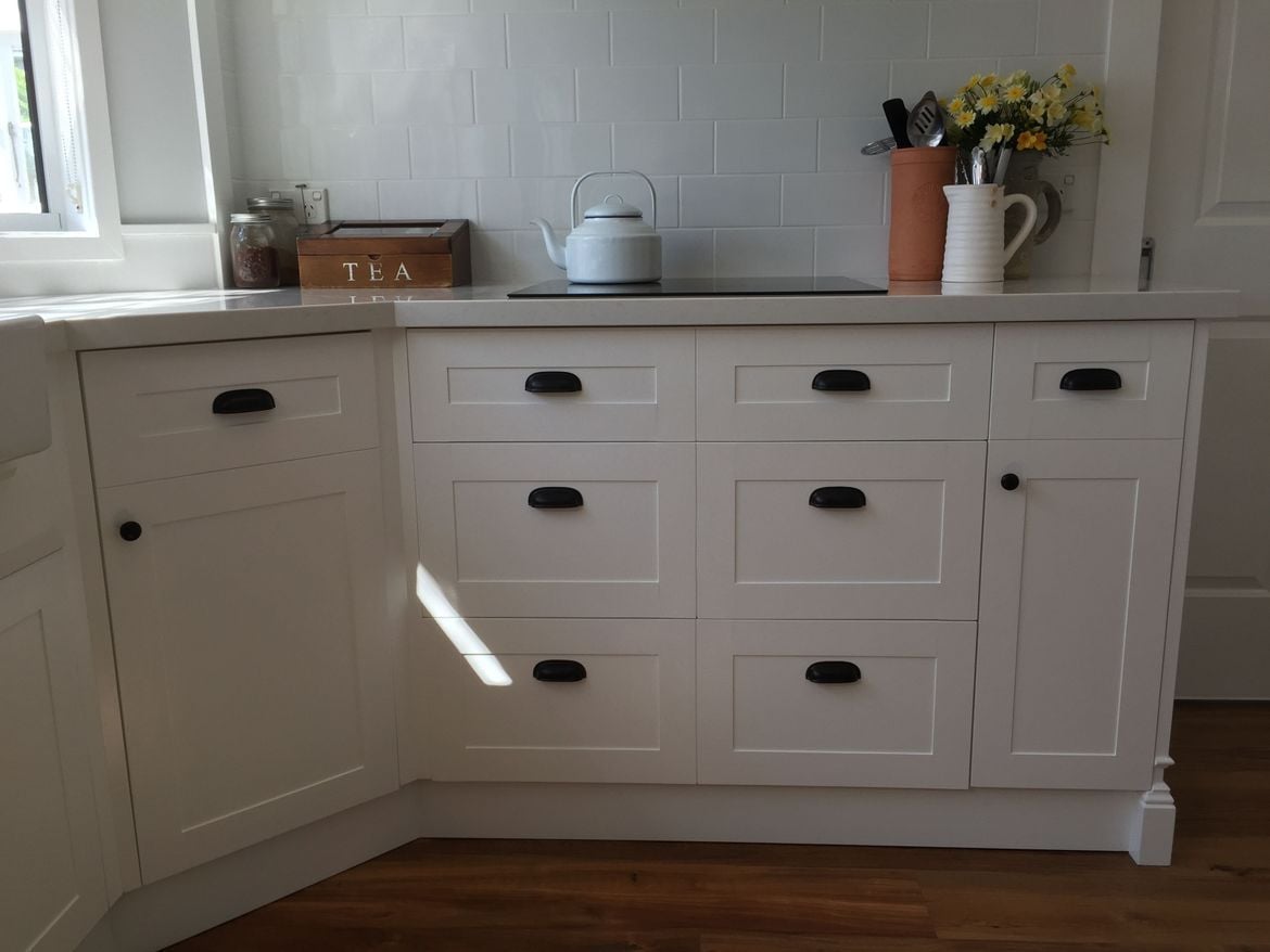

I wanted to add some charm and character to my very stock-standard kitchen. I have always loved Shaker-style doors and because I couldn’t afford a brand-new kitchen I decided to give it a go myself.
I started by using a heat gun to take the laminate off the doors. I patched the holes from the original handles then sanded it smooth.

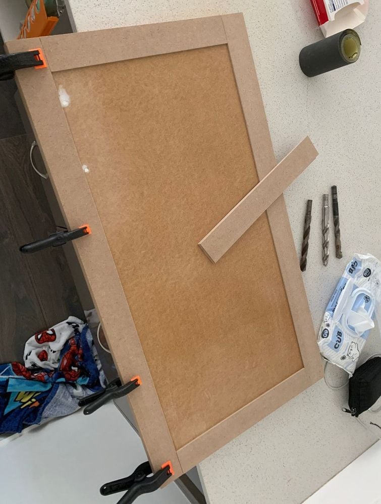

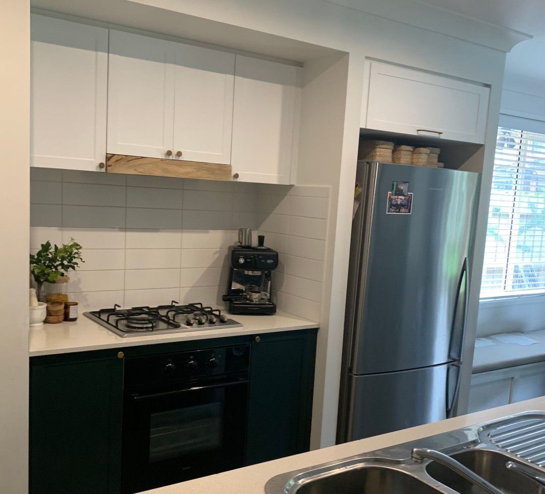

I had 3mm MDF board cut into 45mm strips, then glued and clamped it to the doors to create the Shaker-style trim.

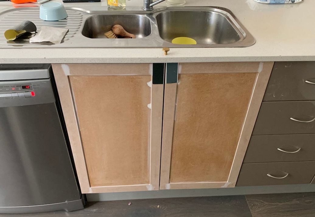

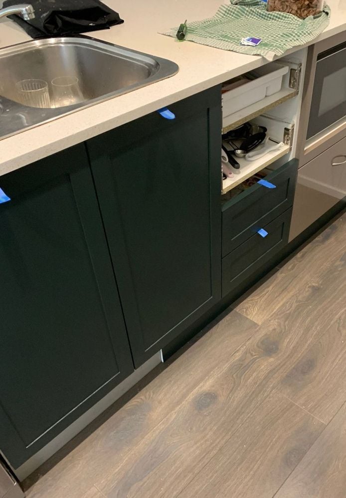

Once the glue had dried I patched the joins and then sanded until very smooth. The doors were then ready for undercoat and paint.

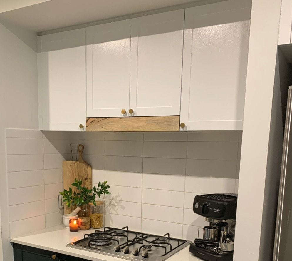

I also cut a very thin strip of Mango wood and glued it over the metal rangehood to add more detail to the kitchen.

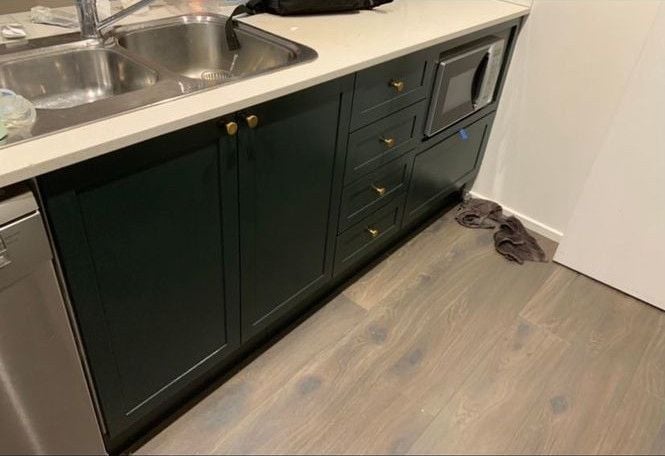

This project probably cost me around $200 and all the supplies I used were from Bunnings.
I am very happy with how it turned out and I feel more confident in myself now to try more D.I.Y. projects.
