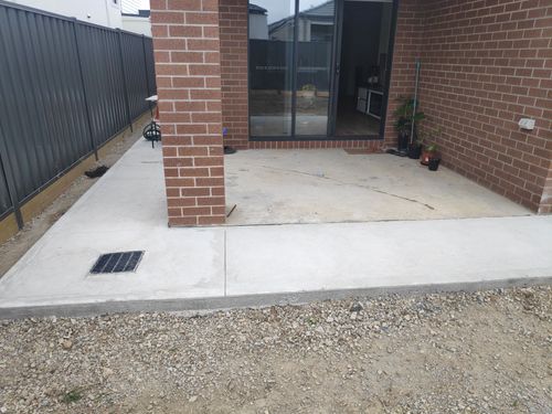

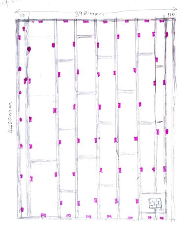

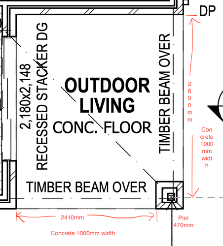

We are planning to build a Merbau deck with picture frame edge on the concrete Alfresco in our new house. There's a concrete of 1000m width around the alfresco area.The height of the brick below the Alfresco Stacker door is 13cm, so we reckon the height of the deck should be 13cmm once its built. We are thinking to extend the deck over that concrete area (as shown below) as well so that it ends next to the lawn when we plan to put that later and also we have some space to the sides. Does it sound like a good plan? Would really appreciate if you could help us with the materials required and a plan as to where to place the joists and bearers with the below dimensions ?
There's a silt pit in the corner (concrete area). Is it ok to extend the deck over it ?
Alfresco concrete
