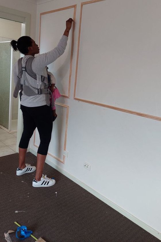

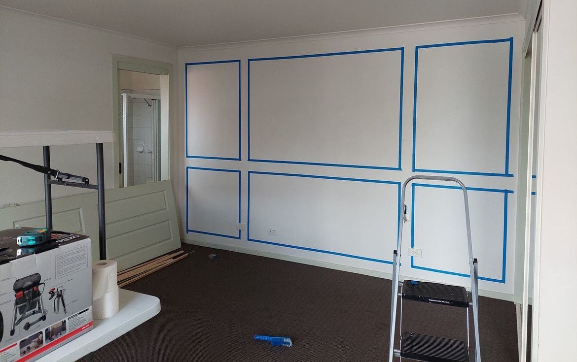

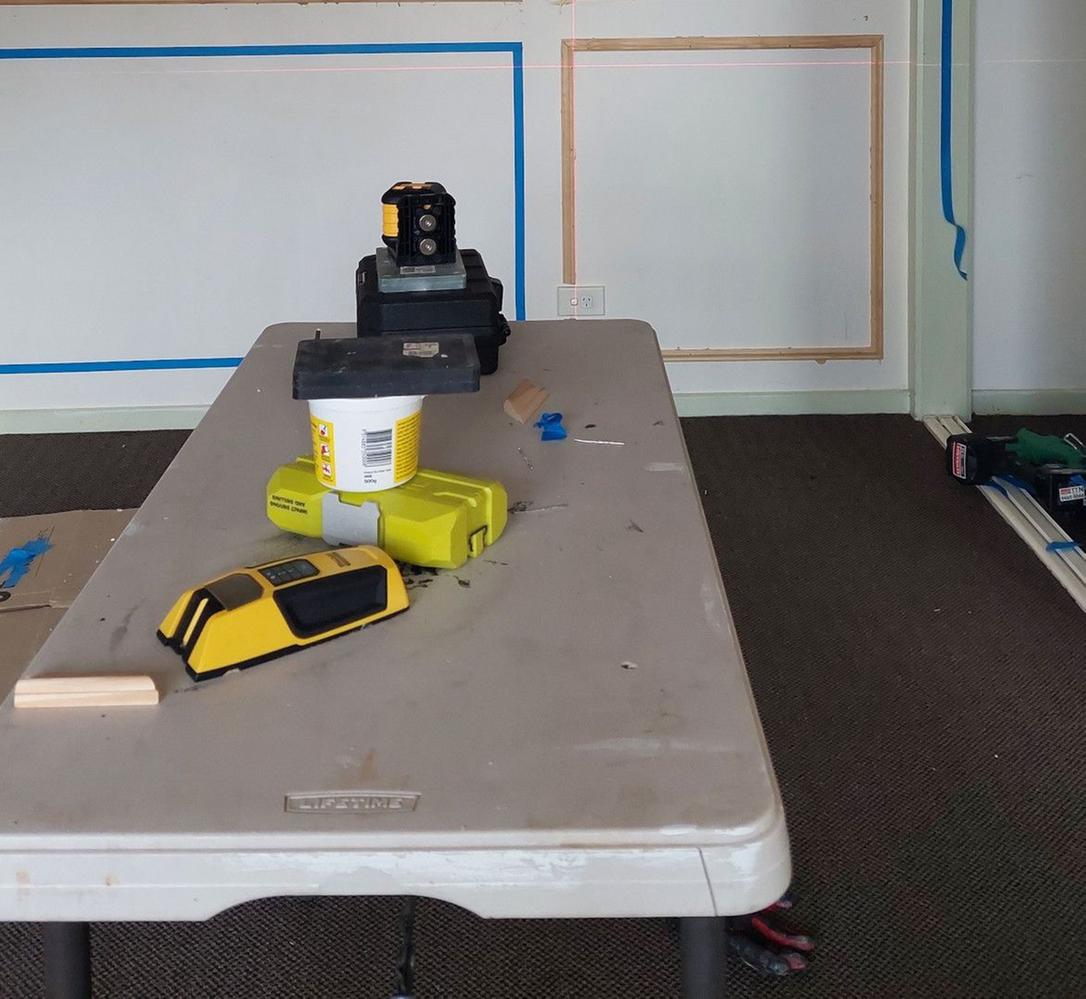

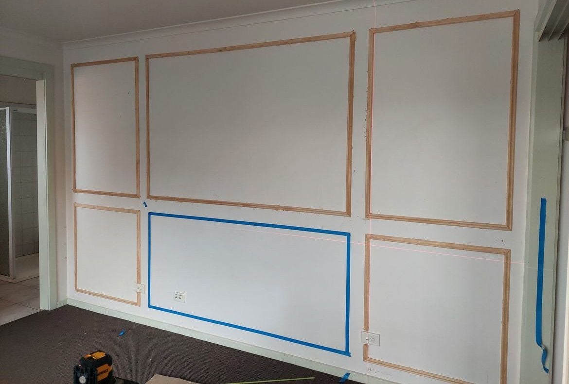

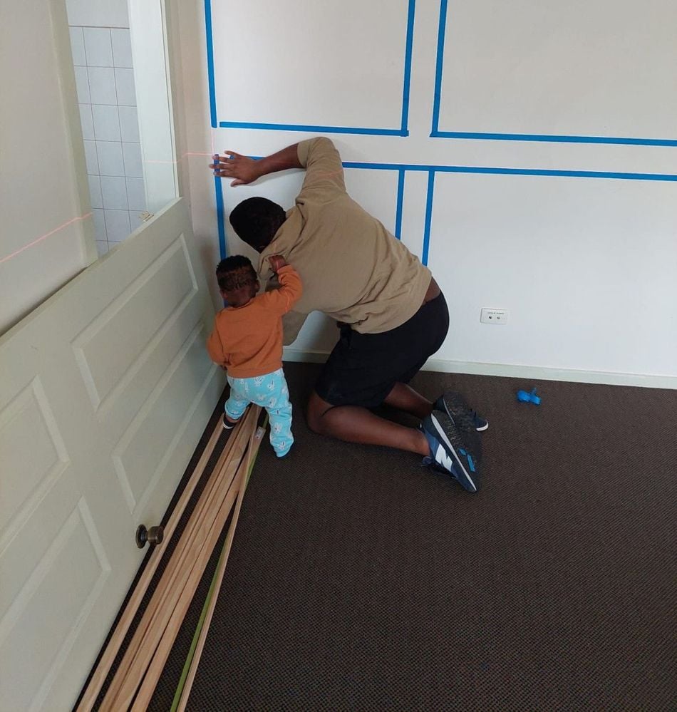

We first designed and marked out the proportions of the rectangles to allow for balance and composition with the door height, windows (opposite wall) and general room layout. We used a laser level and tape to ensure accuracy. Took a few tries to get it right, but we nailed to balanced proportions.
Step 2
Using a mitre saw, I cut the profiles pieces to size, gluing and nailing using a Brad nail gun (to studs where available). This was great to line up the slightly bent pieces. Some of the trim pieces were bowed so we found it helpful to keep that in mind when cutting the longer and shorter pieces!
Step 3

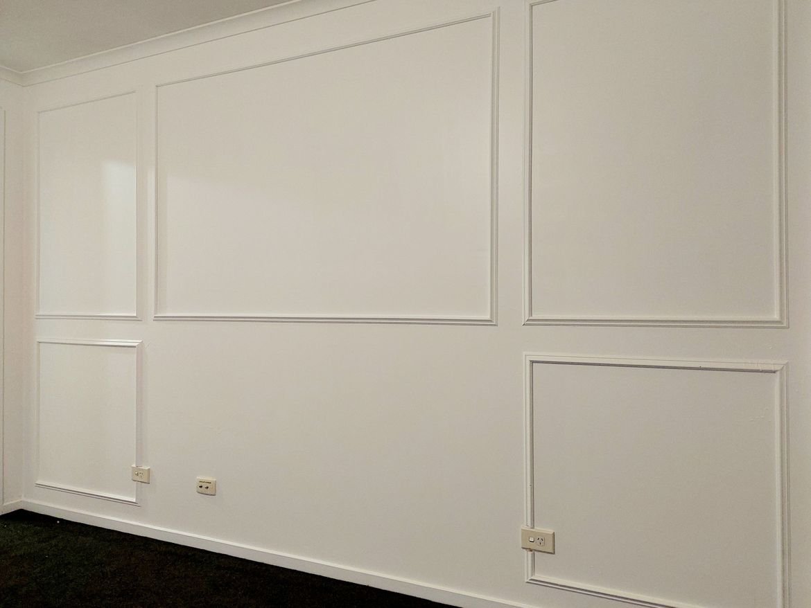

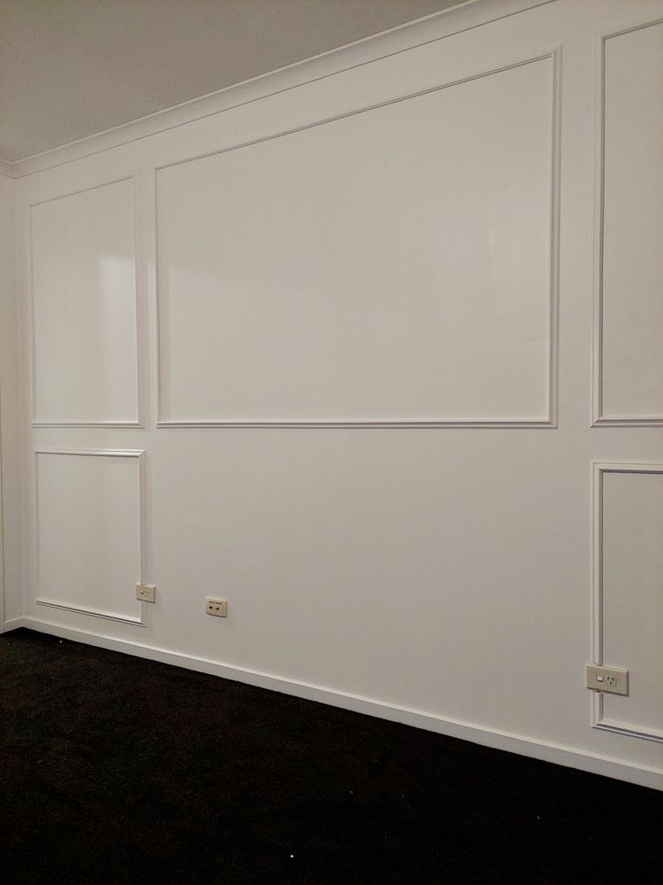

We then filled out nail holes and the mitre corners with wood filler to allow for a neat and tidy finish. After it dried and a bit of sanding, we then filled the gaps between the trim and plasterboard with gap filler.
Step 4

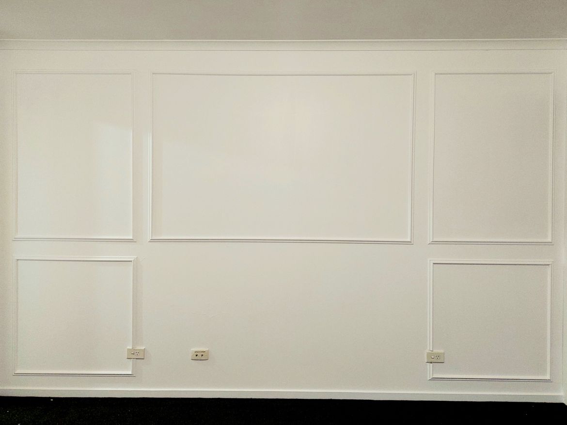

We then primed the trim in preparation for painting the rest of the room and the installation of the new carpets.
We are pretty happy with it.
