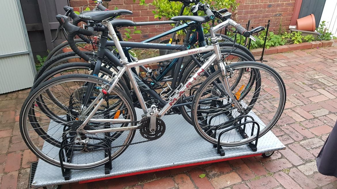

I only have a small workshop where I also store the family bicycles. Every time I needed space, I had to carry out each bike separately. I thought of placing all four bikes on a rack on wheels to pull them in and out in one go.

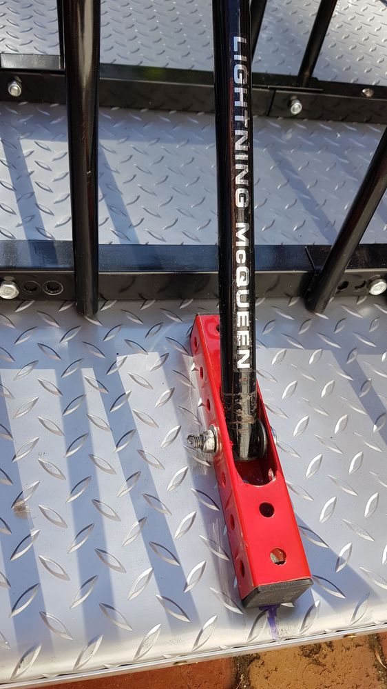

I recycled some old bits like a BBQ stainless steel handle, another handle from my son's old children's bike and some old hardwood fence pickets for the red side rails. The main board is a flooring board, painted underneath. Aluminium angle and flat bars tie the edges together and hold the edges of the vinyl floor matt where the red rails don't reach. I enjoyed making some extra parts to make it all fit together.
The chequered plate is a Bunnings vinyl garage floor mat. A nice product in itself. I was planning to use black rubber flooring or a patterned lino, but the look of the garage mat inspired me to go in the direction of the chequered plate.
I actually added the centre wheel after I first laid out the parts on the ground, before assembly. Apart from not getting stuck on uneven surfaces, I also wanted the trailer to not sag in the middle, as the floorboard, which forms the bed of the trailer, has a bit of flex in it. The side rails increase stiffness and hold the edge of the vinyl.
As for time, I have to admit that it always takes longer than one would think. I was on holidays, so I took some time to paint, drill and countersink holes, etc. I worked on it over three days and then tinkered a bit for another two.
