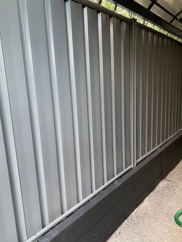

After some advice on how to put artificial fern panels onto a colorbond fence . Measuring 5m wide x 2 m tall.
Ive been told I need to be careful about the weight that will be going on the fence .
Thanks
Thanks so much for answering. Thinking this might look cleaner .
Thanks for your reply . The panels are plastic that measure 900 x 900 . I’ll be putting up 10 in total . The fence is 1800 tall .
Using lattice sounds like a great idea, @peggysue. I don't believe the combined weight of the lattice and panels would come anywhere near the capacity of the fence.
Afternoon @peggysue
I can't visualise these fern panels? Patterned metal?
Just a quick lunchtime thought.
Could you screw an upturned galvanised metal fence railing onto the rebated sleepers seen in your photo above, which then becomes a 'shoe' for the bottom of the panels?
Minimal anchorage would be required at the top.
Thanks for your reply . I was just in Bunnings and someone suggested I could use lattice . If I got 4 pieces of lattice and screwed into the top of the fence and the bottom then attached the artificial panels to that do you think that would be ok in terms of weight on the fence ? Otherwise the double sided tape is my back up option . Thanks
Thanks for your response. I’m thinking tape might not be strong enough as I’ll be putting 10 panels of fern onto the fence . I will definitely have a look in store though . Thanks again

Do you have any idea how much these panels weigh? Typically the ones I've handled are very lightweight, and you shouldn't have any issue hanging them on a Colorbond fence.
I'd recommend placing some horizontal timber batons across the Colorbond panel and screwing them into the upright posts. You can then affix your fern panels to the timberwork. You can screw into the upright posts with Tek screws. Make sure to pre-drill the timber so it doesn't split. The reason for adding the timber is so you have far more points you can attach the fern panels and won't need to drill into the panel itself.
As long as you use a reasonable calibre timber like 66 x 42mm 6.0m F7 H3 Treated Pine Primed LOSP it should cope fine with that span.
