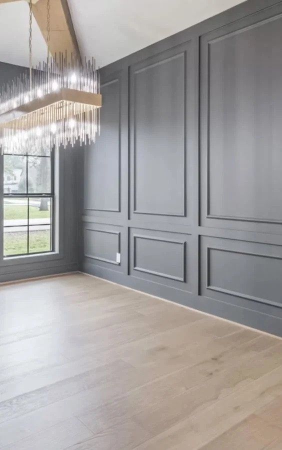

I am planning on a mould (wall panel) instllation project, where I want to install wooden mould in some of the wall in my house.
Moulding style would be as follows:
Wall moulding
