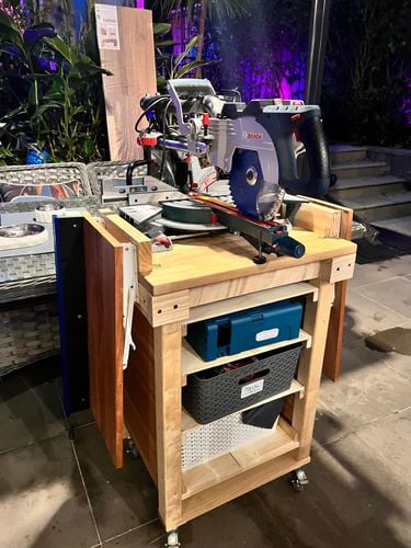

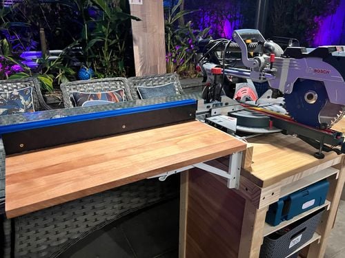

So this is the mitre saw station. I Hacked an ikea butchers block I had and built folding wings with a fence that will allow me to add stop blocks. Overall cutting surface is 1.8 metres which is awesome. Currently I have shelves but will put 4 drawers in to hold tools.
I love the fact that I can roll out, plug in and fold out my station in less than 5 minutes.

18. Centre mitre saw on the butchers block
19. figure out where to place your wings so your wing fence lines up perfectly with your mitre saw fence and your wings are level with the plate of mitre saw.
20. attach the last two pieces of 70x30 pine to the top of the butchers block in the position you have marked above
21. attach the 4 folding hinges
22. cut your laminated 42x19 pine in half
23. attach pine to back of wing
23. attach form ply fence to wing and pine backer - make sure to countersink screws
24. take two pieces of the Kreg track stop and drill holes and screw into fence.
25. Clamp wings to fold up hinges and ensure that everything is flush and square
26. attach wings to hinges.
27. Add measuring tape to Kreg track stop on either side and attach stops.
