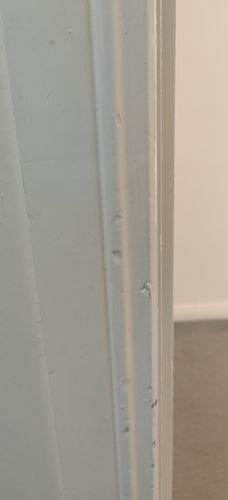

Can someone advise me how to fix small dents in the door trims.

Looks like you have been taking photos of my hallway lol A couple of questions.
Do you know what type of paint that is? (as you will need to repaint after fixing the hdings)
Are you going to repaint the hallway/room? 🙂
I would suggest to use something along the the lines of a timber putty Timbermate timber putty
I would also at the very least sand out the dings first (only because if the paint is old you are attaching putty to potentialy old paint)
Use the putty, sand it smooth and then repaint.
Everytime I "fix" an issue it shows up how new and sparkly it is and how drab the existing stuff is. (just painted nmy front door and my foyer looks shocking now lol)
You could potentialy rough up the dings and be careful filling and sanding then colourmatch teh existing paint instead of painting all the trim?

I am repainting the doors and trims . I was worried about the fact that since dents are on the edge and not too deep. Will the timber putty have enough grip hold or stay there or I better use Knead it .

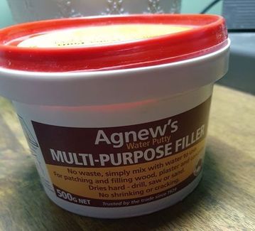

I'm hooked on this product (I'm not a Bunnings employee) - wonderful filler and sticks really well. Some sanding prior and I believe it will work well.

The timber putty should hold, especially if you sand out the dents of the paint. I have been surprised at how well plaster holds up when I have been doing repairs and timber putty I would think is even stronger.
To ensure you get enough grip I'd drill a small hole or 2 in the bottom of the dents (at an angle) so that the filler goes in and has more surface to grip on.
Hi @sj1,
It appears that our fabulous and knowledgeable members have already provided some great advice. The timber putty will be fine for those small dents. It's actually the opposite; if they were larger chunks out of the edge of the door, I'd then suggest a two-part filler.
