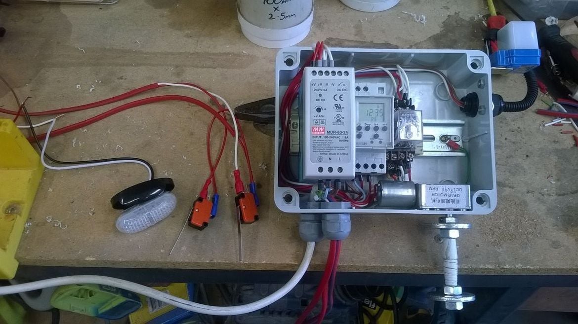

Time to put it all together. I also decided to install some LED marker lights I had as surplus to come on just prior to dusk and turn off after a couple of hours. I did a test run at this stage to ensure it worked.
