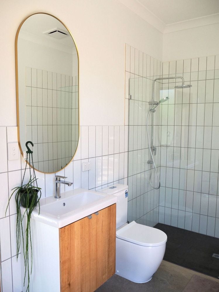

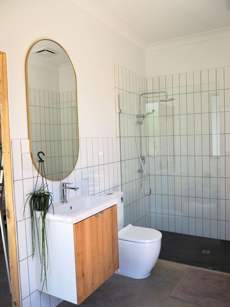

We have finished the studio bathroom and are so stoked with the result.

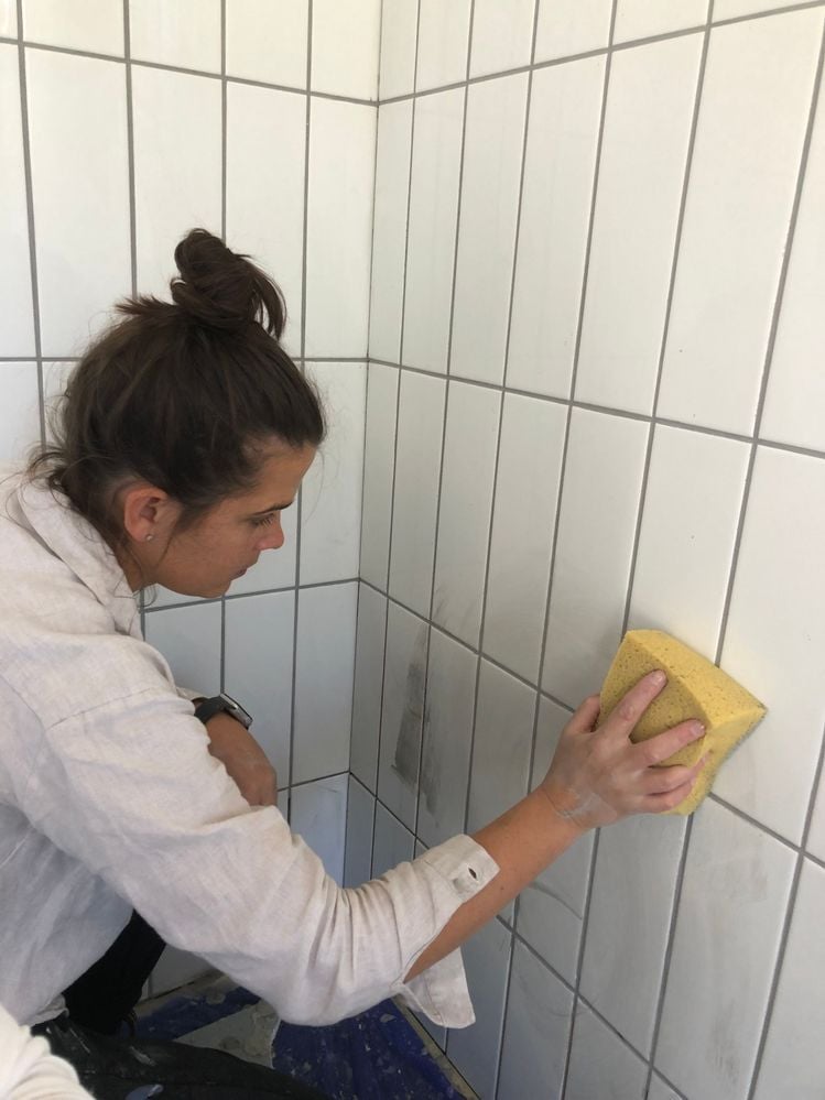

This was our first tiling job, so we learnt a lot very quickly. My number one tip would absolutely be to try and clean up as much as possible as you go. Wiping off excess glue and grout will make your life so much easier later down the track when you're finishing up.

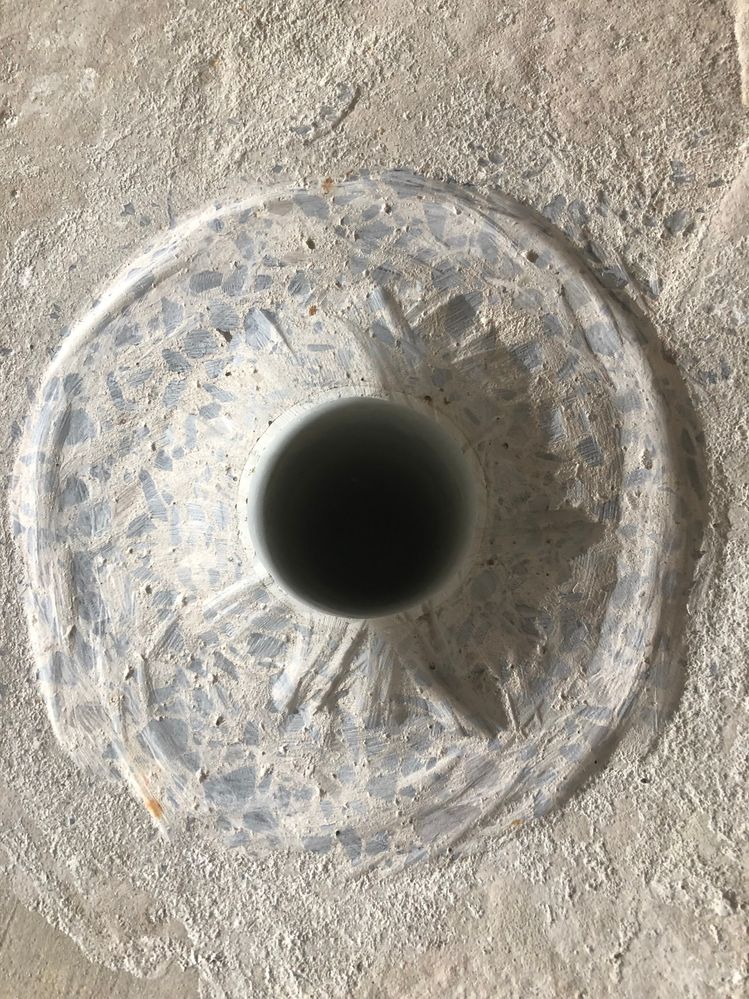

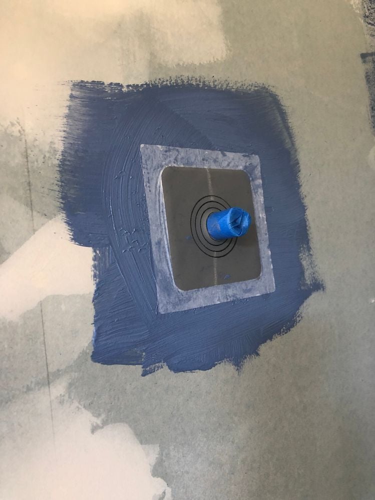

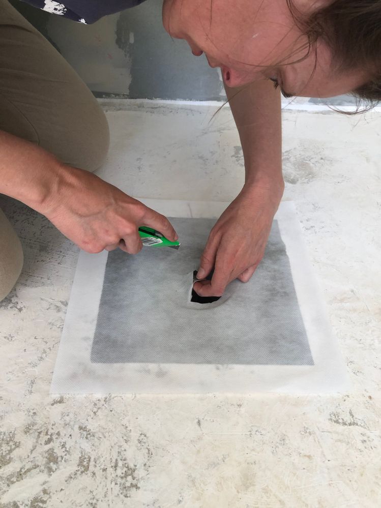

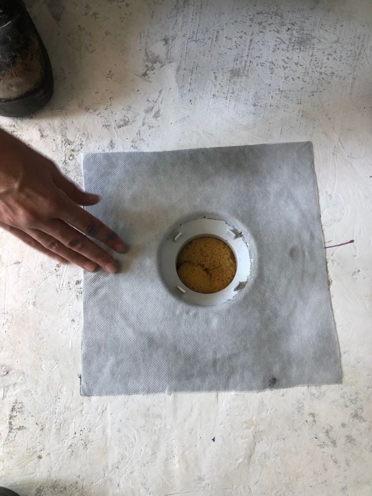

Here is the puddle flange preparation.

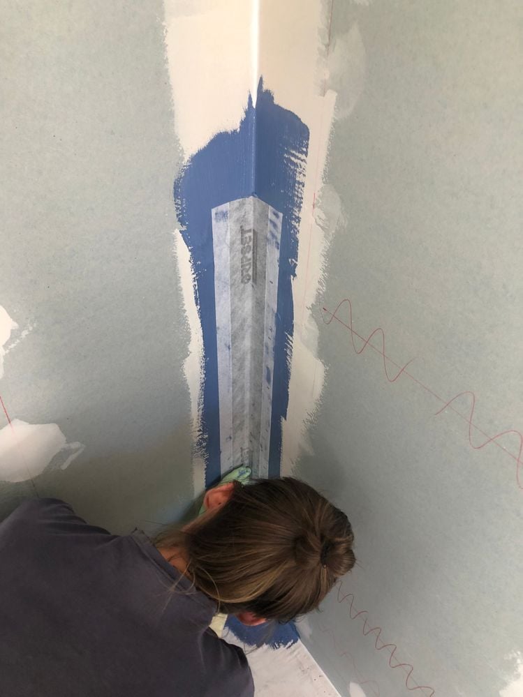

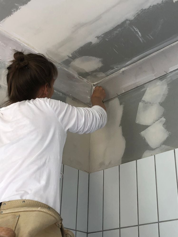

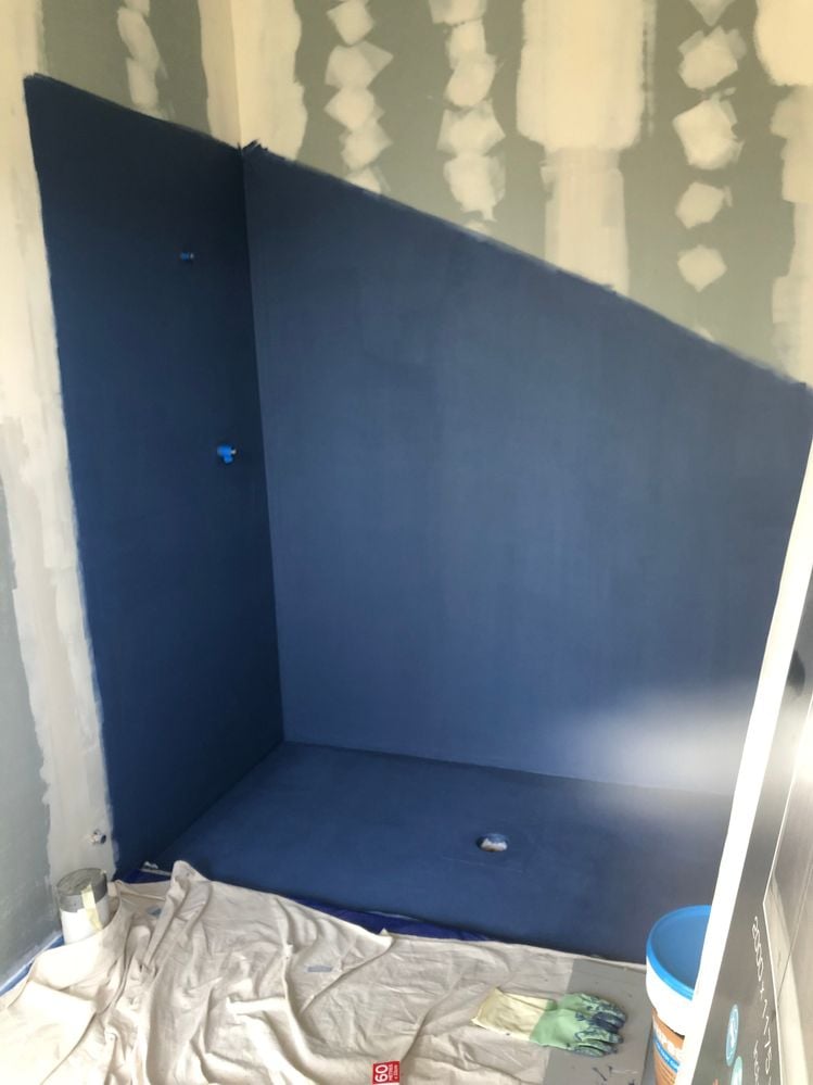

Bond breaker tape in the corners.

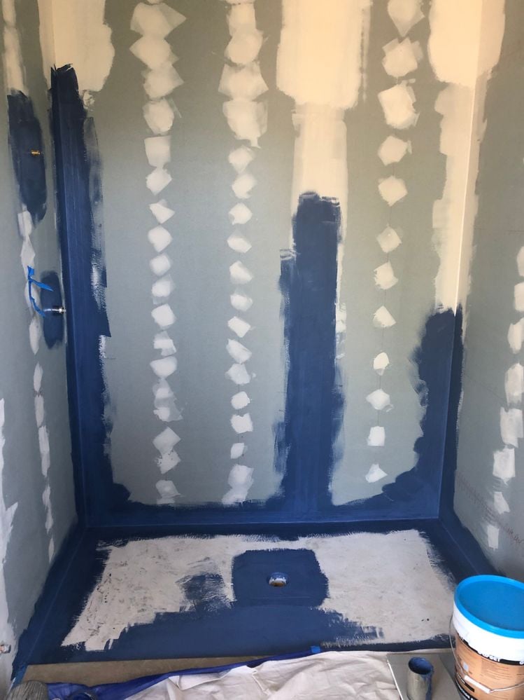

Waterproofing the mixer taps.

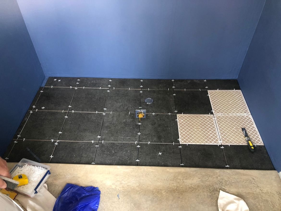

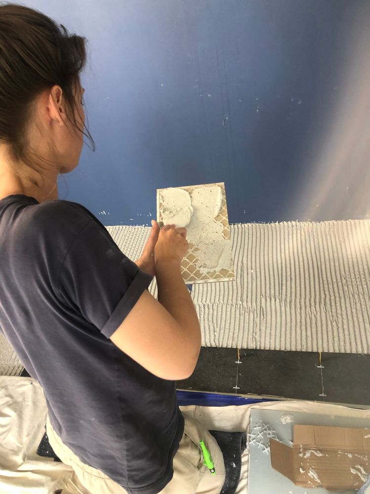

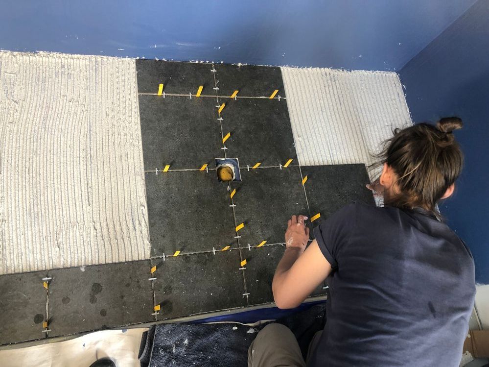

The tedious job of tiling the floor.

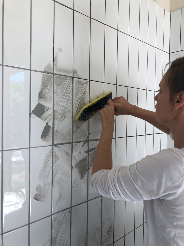

Grouting the walls.
Cleaning up.

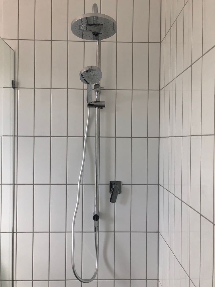

We're very happy with this Methven shower.
Areas where we could easily have cut costs further would be the tapware and toilet. I haven't included the cost of purchasing some of the tools we needed to do this project.
