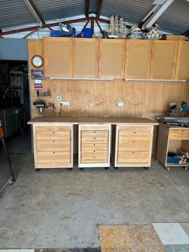

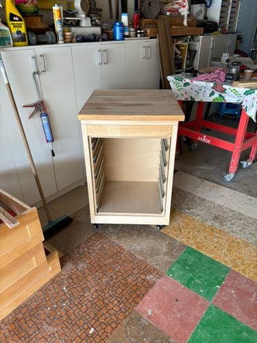

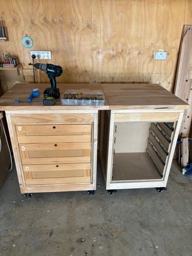

Before and after shots.

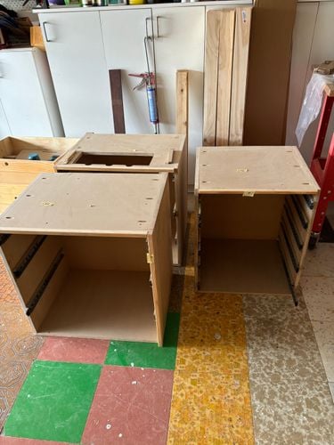

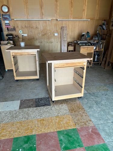

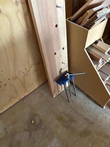

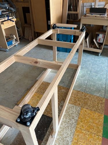

Deconstructing work bench

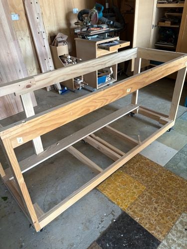

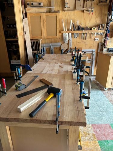

No going back now, cutting starts.

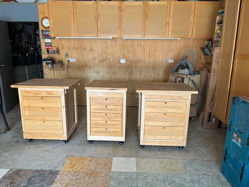

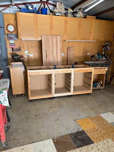

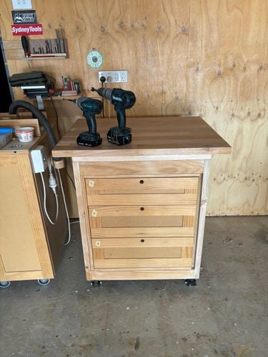

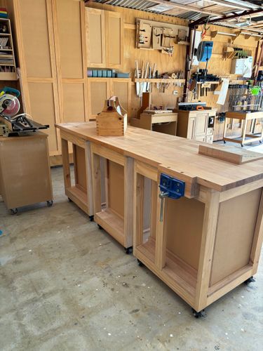

Di section completed, extra timber, extra wheels installed. ( approximated cost of modification, just under $400, for heavy duty wheels, timber and toggle clamps)

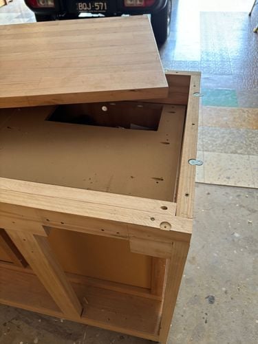

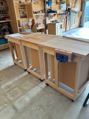

Bench top was cut up and installed, the original bench top was not enough to cover the three benches, the reason is that I decided to make the the first and third bench top longer to allow for clamps, luckily I had a piece of the original bench top off cut which fitted perfectly for the middle unit.

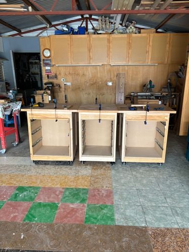

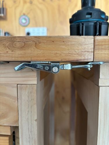

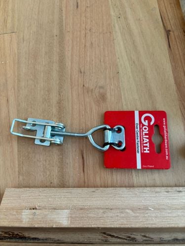

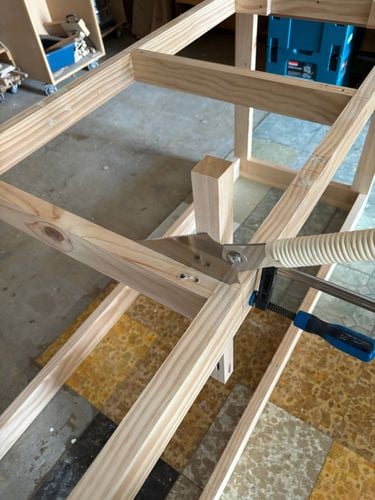

Toggle clamps fitted to join the work bench together

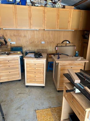

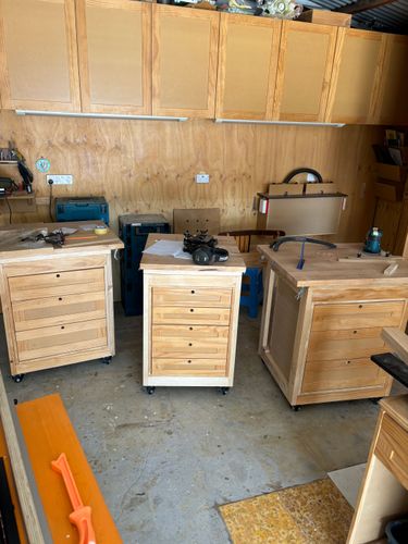

The madness!!!!!!!
Now you can see that I like modular everything.

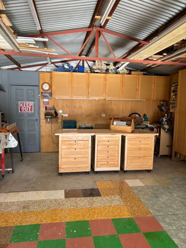

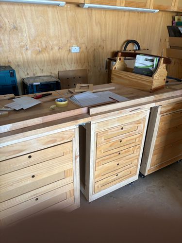

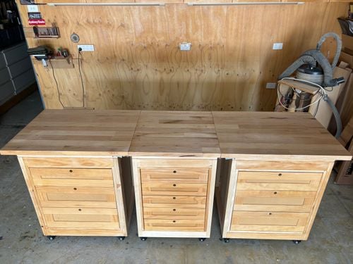

Front shot of Modular workbench ( yet to be varnished)
Rear shot of modular work bench
