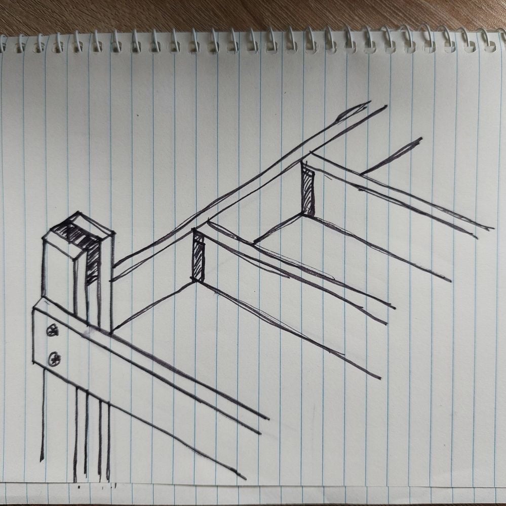

Design ideas (not final).

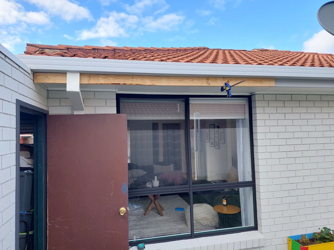

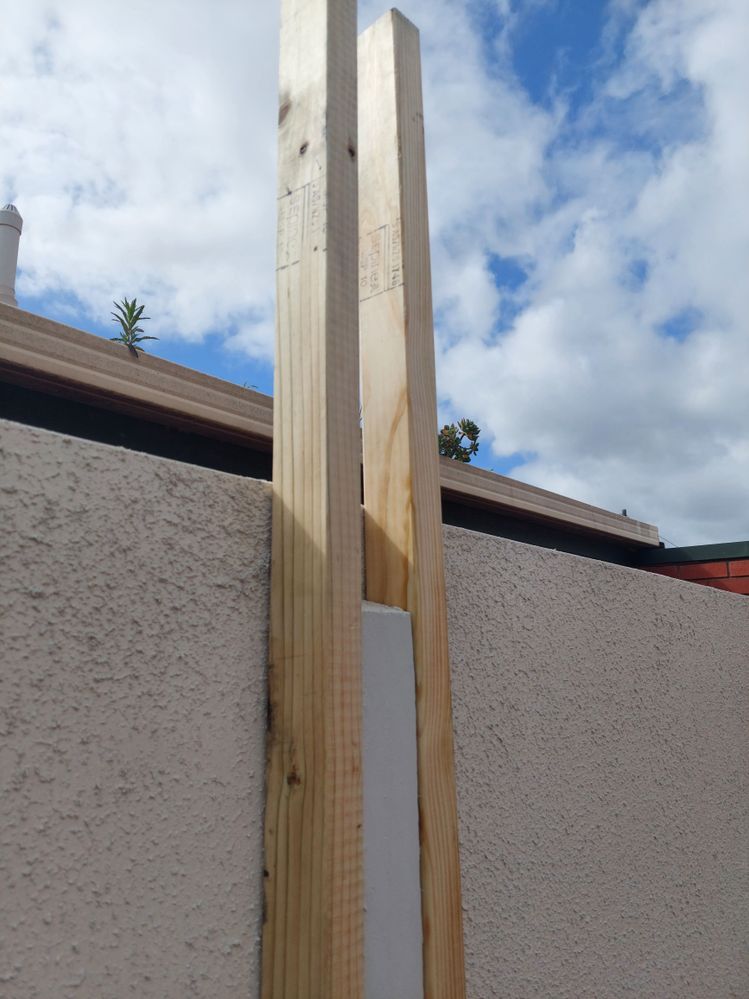

I had to figure out how to extend the uprights of the fence. This took some creativity but I worked out something in the end.
I also installed the barge board going through the existing fascia to fix it to the rafters.

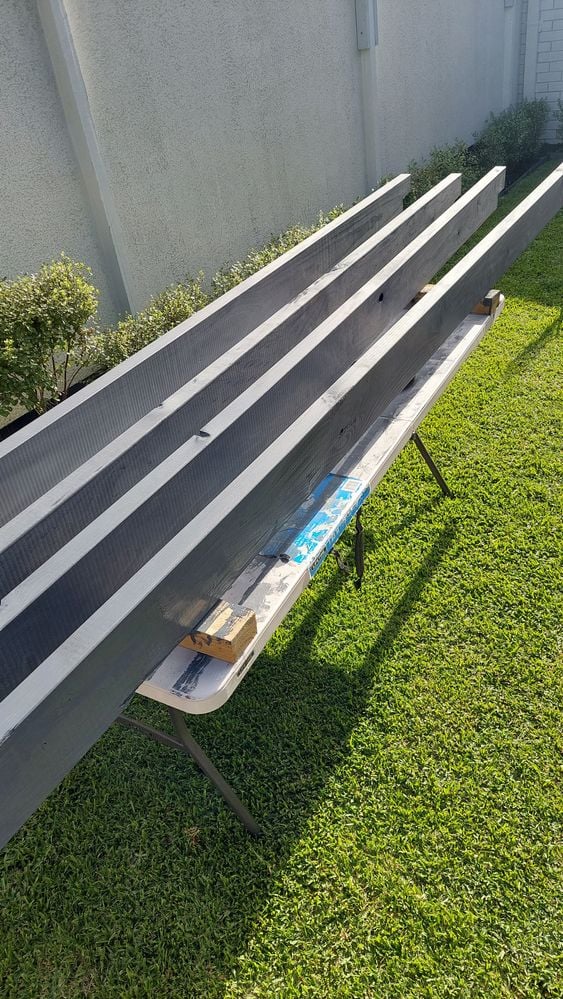

The next step was cutting the timber to size using a mitre saw and jigsaw to allow clearance for the gutter.

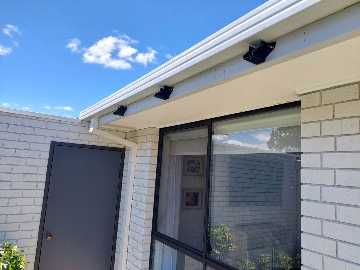

Next was installing the joist hangers after painting the barge board.

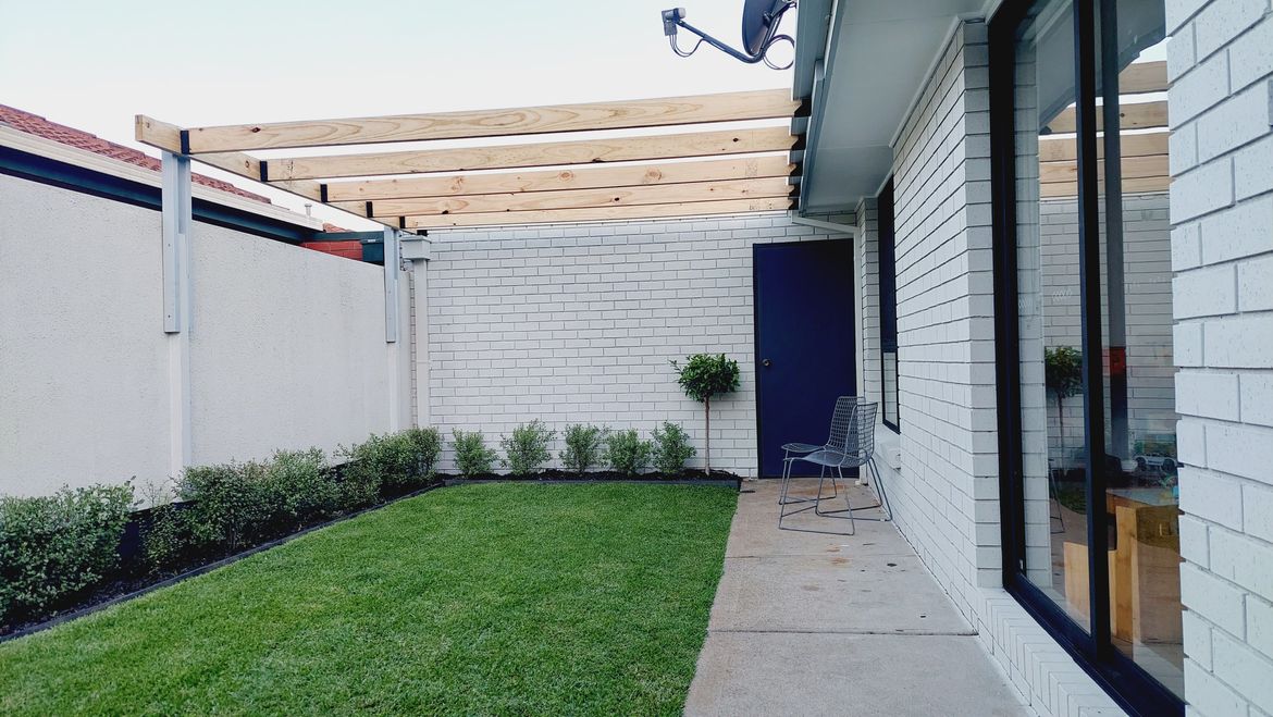

I then did a dry fit to see if all my measurements were good and the whole pergola was level.
Step 6

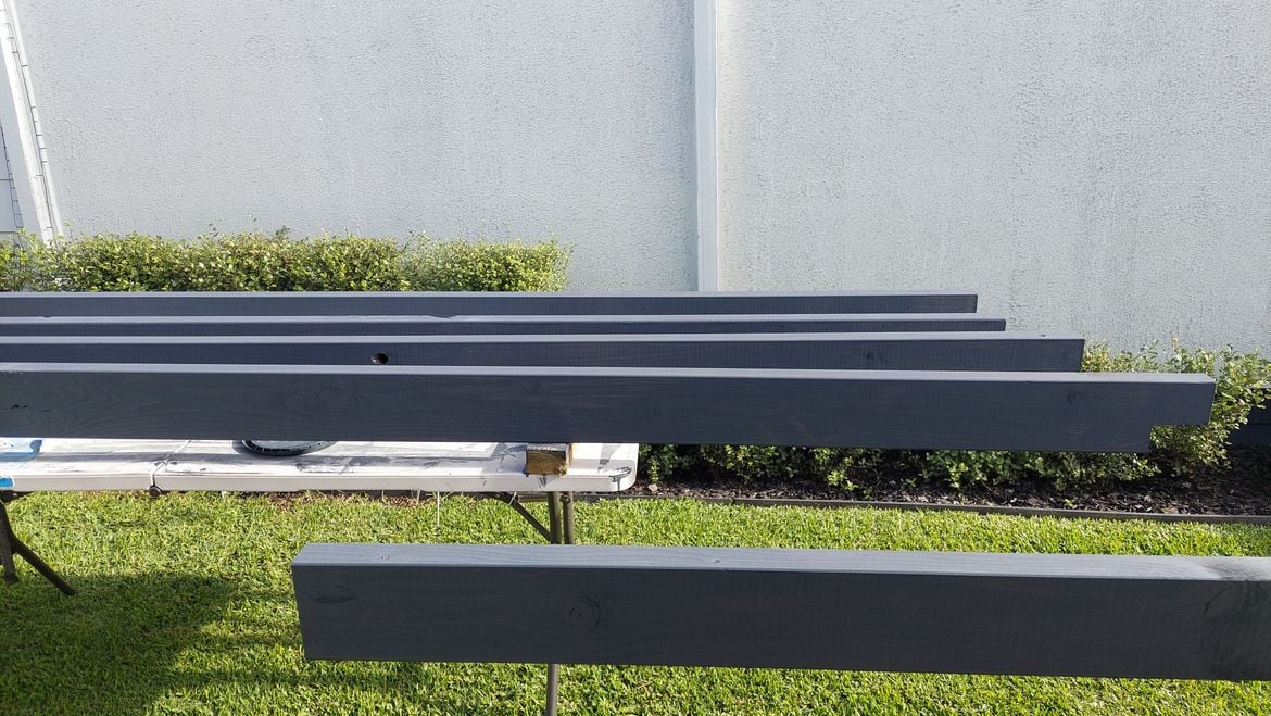

I then trimmed off some of the timber and painted all the joists.

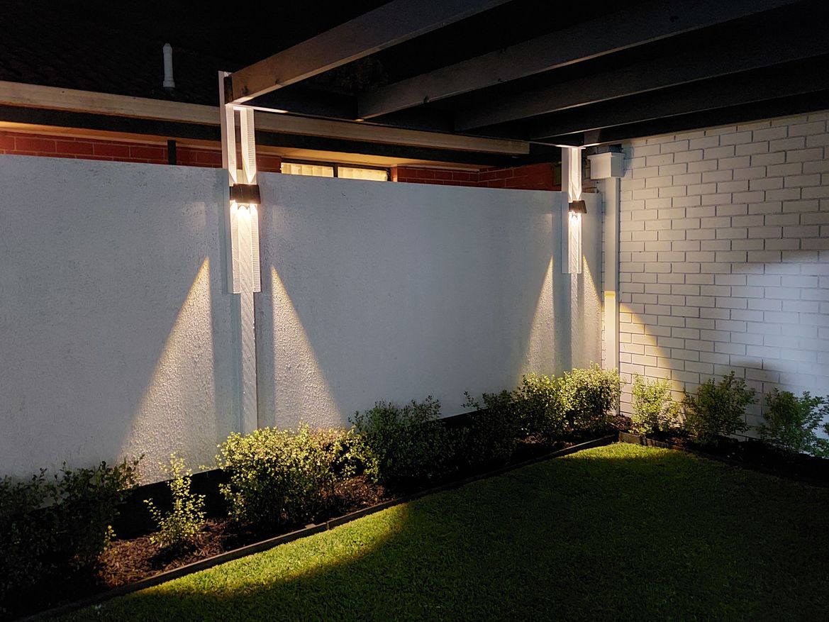

Before and after
