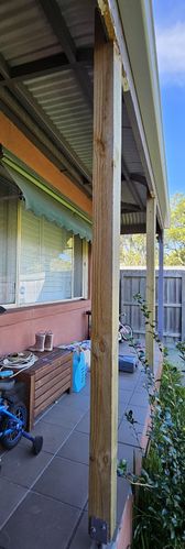

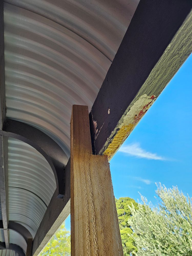

We had some posts replaced but they are coming loose and seem to be twisting. Is this repairable or do I need to replace them? If I do need to replace, is cypress wood ok for it?

That post that you show dosnt seem to have any bolts through it? I cant tell if there are screws from outside in with the angle of the photo?
Posts will twist, especially unseason ones. Its part and parcel of them is the way I look at it. As to securing the post to the beam I would suggest to use some bolts with washers. But before you do it yourself I would probarly have a chat to the installer. If thats not doable then the bolts should be fine for securing the post. Looking at the scond photo raises another question, does the other replaced post have bolts through the top?

Both posts are secured just with nails so I will look into getting some bolts to try and secure it better.

Pool deck stage 2 Is one of the projects that will show you how to attach a post to a beam.
Check out step 2 for how I attached the beams with bolts. Diagonally drilled and at least 20mm in from the edge. They make for a very solid connection. Mine was hardwood posts and beams so it was a lot harder to drill. Your post is pine and it looks like your beam is (cant think of the name but know it lol Its the same hardness as the pine post) So should be easy to drill.

I'd advise using 2 x galvanised M12 cup head bolts with washers to secure the beam to the post.You will need a long 12mm drill bit such as this Sutton Tools 12mm Long Series Jobber Drill Bit to predrill your holes. Put the bolt through the pilot hole with your washers in place and tighten. This will pull the two pieces of timber together snugly.

"Is this repairable or do I need to replace them?"
Sorry to hear of your troubles - but my thought would be to replace them with a better product - plenty of choices at Bunnings. Wet sleepers are evil things when they twist and can hold their contorted position against your wishes. Even with a bolt, you may have trouble closing the gaps seen above.
