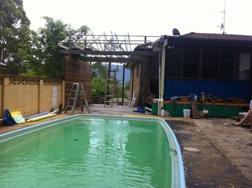

Having just finished the deck itself Pool deck stage 1 I really wanted to start boxing in the area. I had sourced the trusses from a recyled timber place (It has since closed its doors)
I had to try and work out how to actually put up trusses, corrorgated metal roof and also the ridge cap without climbing out onto the roof as it is at a resonably high height.

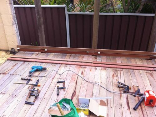

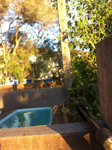

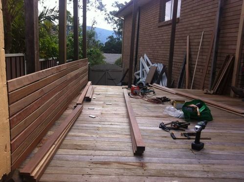

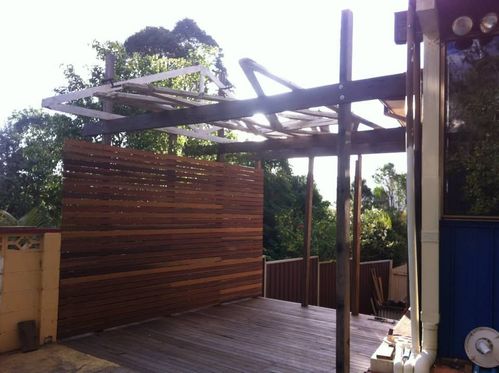

After completing the skirt of the deck I was super keen to at least get one of the privacy screen slats down... Even tho the sun had gone down! Go little green ozito!
Next day, Showing a lot better what I was up to.

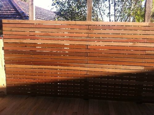

One of the reasons I wasnt fussed about the extra effort for four posts was I knew it would be easier to keep the slats straight especially the joining of them.

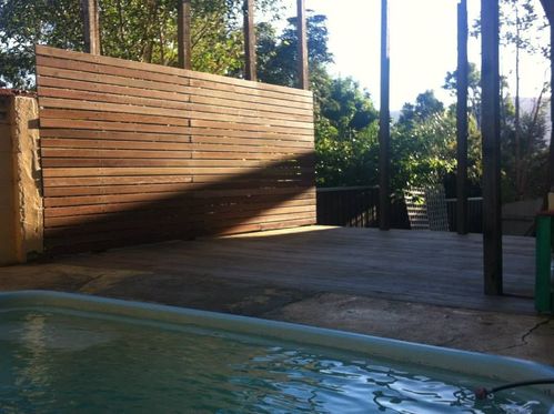

I allowed 5mm gap between the brickwork and the timber for expansion, possibly should have gone 10mm but I have had no issues in the decade since I put it up.

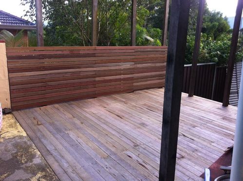

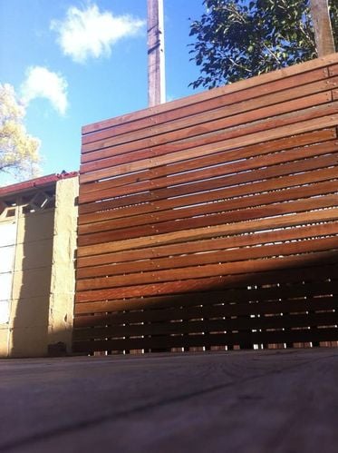

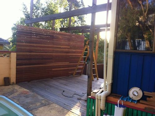

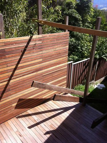

It made it feel a LOT more private as I went up the wall.
Nicely hides the neigbours place. I love how the eyes just blurr it away. That middle join has blened in and is no longer noticable.
One reason I chose the Jarrah slats.
Old lattice being used as spacers between the new privacy screen slats 🙂
I was really happy with the sense of being surrounded. I almost didnt put a roof on it but decided to continue with the original plan.

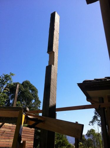

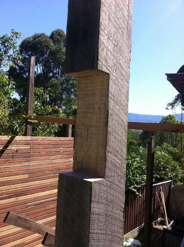

I have gone and forgotten the actual height of the beams. Fairly sure they are at least 3m if not a little higher. I was just tieing the posts together as I worked my way up for stability.

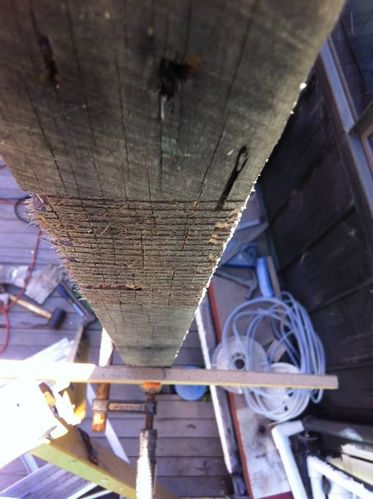

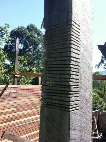

The reason I was tieing the posts together lol When I was notching the timber with the circular saw and then chiseling. The stays kept it from wobbling.
Better view to show the stay and the cuts.
Working out the height the roof beams and where they were going to be.

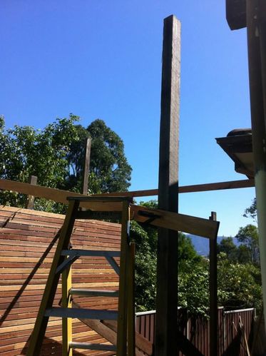

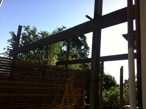

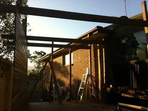

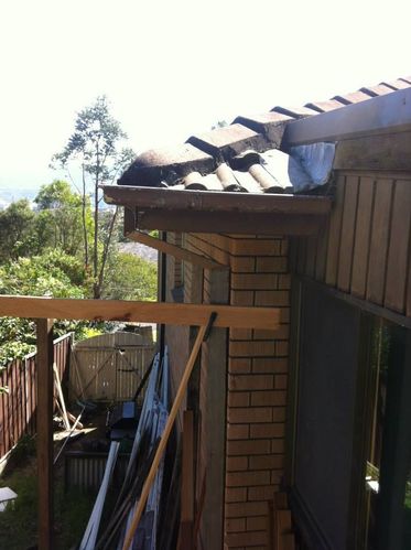

The crossbeams that would support the roof trusses I wanted to be secure as we have fairly high winds where I live. I also had to factor in immovable objects such as the corner of the roof and guttering.

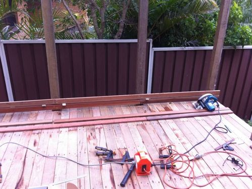

I used a spare floorboard as my leveler for the posts. No way was I going to try holding up a beam while marking the level on top of the ladder!

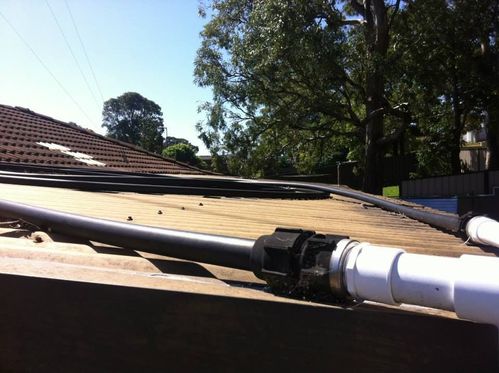

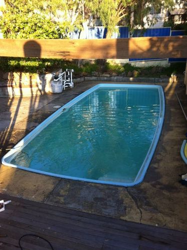

The "solar" heating of the pool... 2-3" black pipe in a coil maybe of 8 circles... Yeah I dont use it as I found it did nothing to the pool temperture.

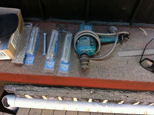

I have never gone through as many bolts as I have since working with hardwood. So many times its just cheaper buying by the box.

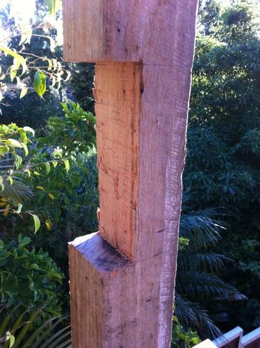

Notched! 🙂
Clearer shot, I was pretty happy with myself making it so tidy.
Working away bit by bit. The timber beams were HEAVY!

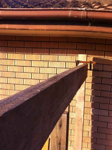

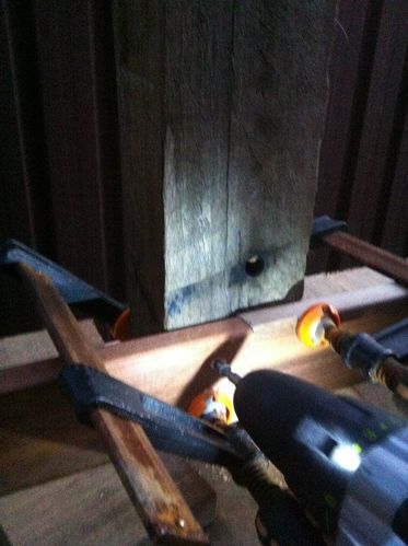

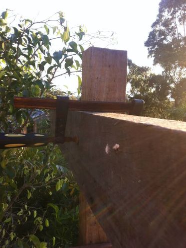

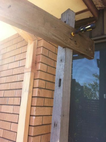

It looks scarier then it was. The beam wasnt close to the window 🙂 Once clamped I put in two bolts diagonally through the beam into the post.

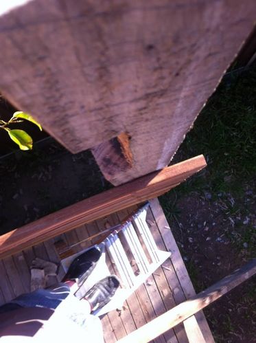

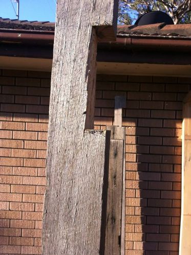

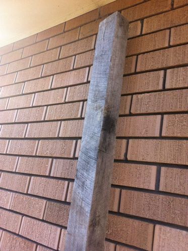

Ahhh A stuff up.... I didnt factor in that the circular saw wouldnt fit... How do you notch a post that close to the wall?
With a hand saw 🙂 Slowly!
There is something about chiseling that is relaxing...
I was resonably high up and yeah I know I should not have been standing on the top of the ladder.
So you can see the two middle posts are standing. These actually dont connect and were meant to be chopped off. I decided to leave them there for the time being as I was going to put a handrail across the space and then that changed to a spa going in next to the deck, so not sure if it will be a step down or handrailed and a step down. Still to be done .... 🙂

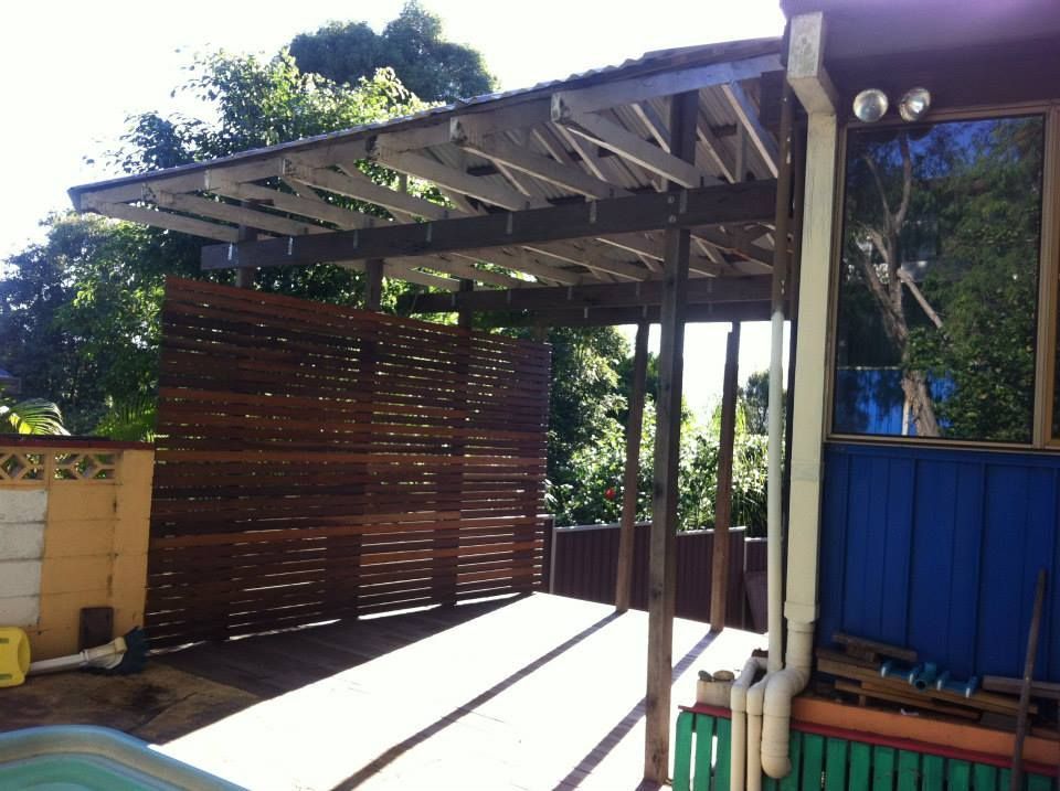

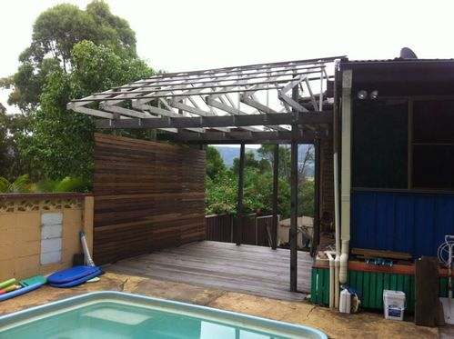

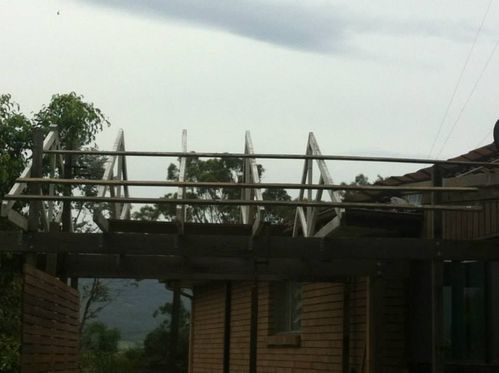

Once the beams were in place (And drilling 12mm holes at height is not an easy job) It was time to get the trusses up. I only went with three cross beams as the other post came down directly on the grease trap drop off point and I really didnt want to mess with that.
The rest of the privacy screen was up and the beams were being bolted in place. I decided to leave the posts above the privacy screen in case I needed them (And they are still there to this day)

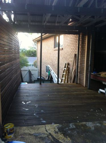

It was a very solid structure even before the trusses were put up.

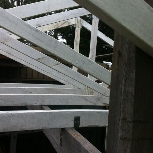

First one in and up,having the tall posts did end up helping me out 🙂

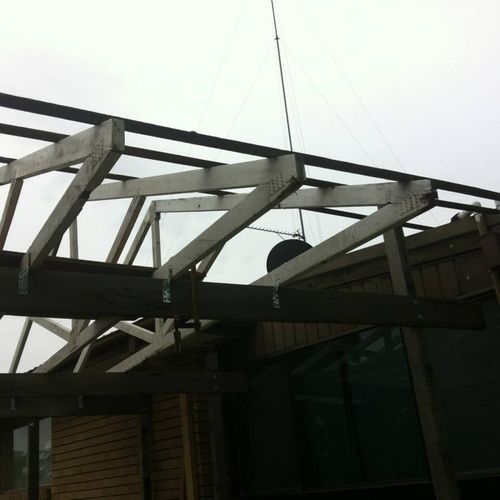

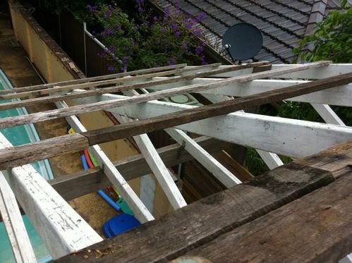

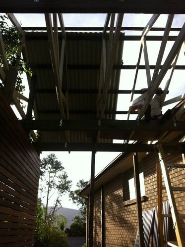

Making my way across the beams. I was using the roof battens to also temporarily hold in place the trusses as I wanted the spacing right and had never attached trusses before so was a little nervous.
I really felt I was having a lot of fun doing this stage.

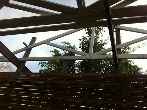

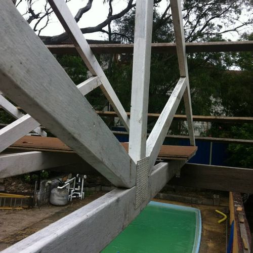

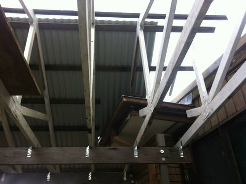

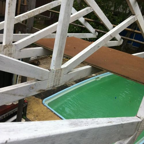

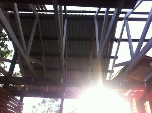

Connecting the trusses to the beams. I really didnt want any type of movement in them.

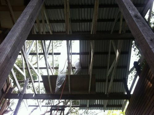

You can see the particle board that I used to help me move around. That way I wasnt hanging off the top of a ladder over reaching but could still stand up.
All lining up nicely and attaching nicely using the straps?
Maybe I should measure the height lol and also looking back I should have painted them before I put them up lol

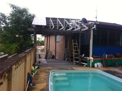

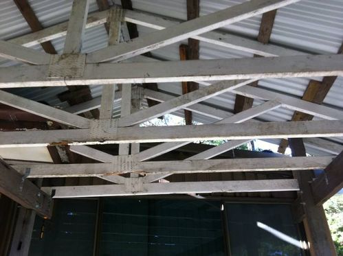

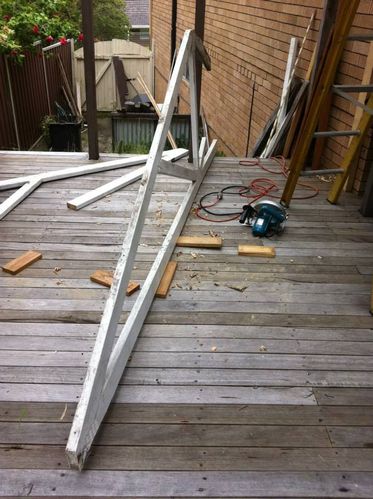

Modifying some of the trusses as they were rotten in sections but mainly because of the angle of the house roof verse the angle of the deck.
To show the height I was at... Yeah ummmm
I was running out of roof battens that I had recovered from a site that had a torn down house and didnt really think they were necassary... lol I was kicking myself I hadnt grabbed more!

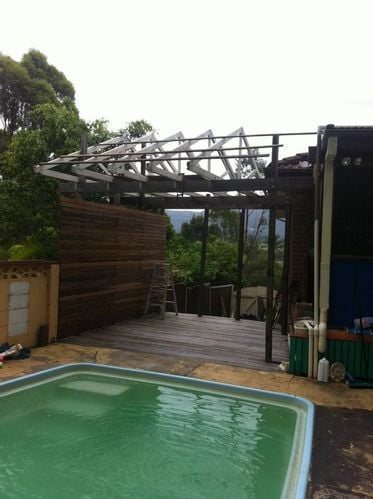

The two modified trusses. The bottom of them was fine it was just the angle that would impact the tiles. The whole deck is freestanding and I didnt want any of it to touch the house or back room.
All the trusses are in! 😀 I wasnt sure how I was going to cover the bit from the rear of the roof to the back of the house but decided to leave it to do later. (still not done lol)

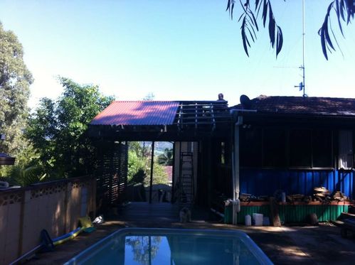

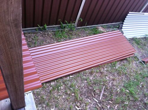

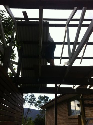

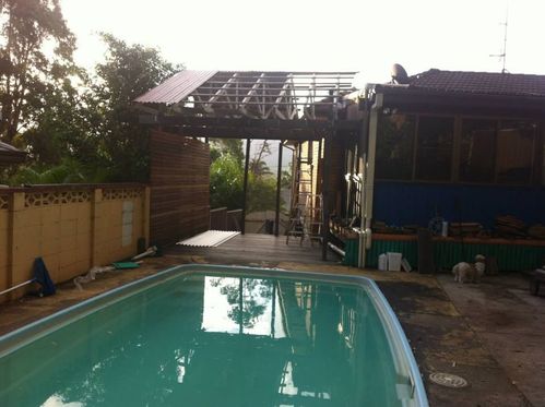

Time for the corrorgated roofing to go on, I remember thinking it should be cheap (it was dearer then I expected lol) and went with a local supplier. I had never done a roof before so it was a bit of a learning curve with the battens, rubber washered screws, the square edges and the peak of the roof. Plus lining up the sheets so the drip line was level.
That particle board fitted the bill perfectly I just kept sliding it around to where I was working! I am gald I had things pretty square for the trusses and the floor base as this is where it would show up in a big way. If I didnt get the first sheet right then the next would be out and so on. It made it hard as the deck was not square to the house but a little odd shapped to line up with the fenceline (1m from it I think)
Bit by bit is a favorite saying of mine. Break it down to smaller chunks and anything can become manageble.
I was impressed that the sheets of courrogated steel came with an extra top and bottom sheet to protect the coating!
Wondering how close the two sides should be at the peak, in the end I just guesstimated it 🙂

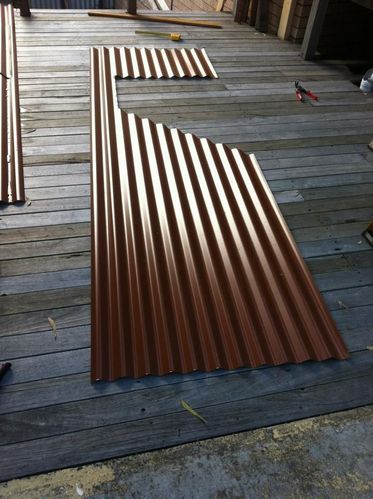

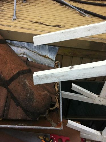

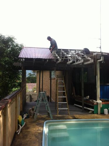

Ahhh the modified piece to align with the house corner. I spent so long trying to visulise it and get it right before lifting it up, I think I had to bring it down two times before the angles were ok.
One thing I hadnt factored in was a facia board for a gutter.. And yep thats on the list to do for the next stage of maintainence 🙂
Where the roof meets the roof... Lots of fun but woked it out!
Just showing how I "crawled across the roof" I delibratley made sure I kept my body weight centered and low. I made sure I did not listen to that guy on the shoulder that says "a little bit more is ok, just a little more" lol That guy has no fear!

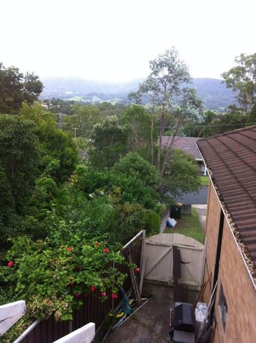

Almost there, I was getting nervous about the ridge cap being put on as it would mean I would have to go out onto the roof and do it. In the end I did one end from the left hand side by standing on the overhang of the roof beams (lucky I hadnt chopped it off!) and then most of it from the house side. I only had to go out onto the roof more then I was comfortable with by 500mm maybe.

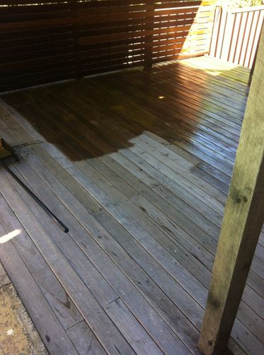

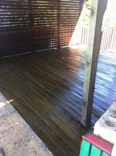

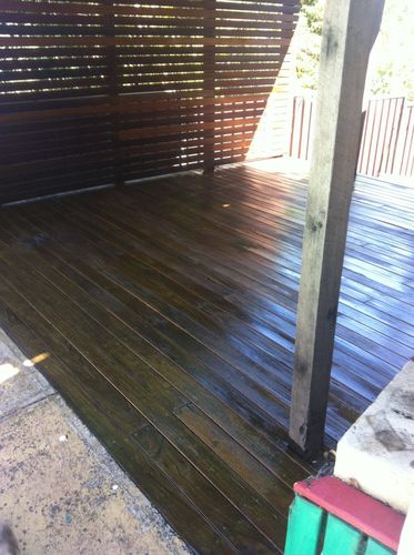

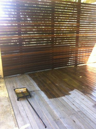

Finally got around to oiling the deck. I really should have done it a lot earlier. Live and learn.
The oil still worked a treat and brought it together.
Completed! 😀 Oh yeah!. I did two coats of oil.
