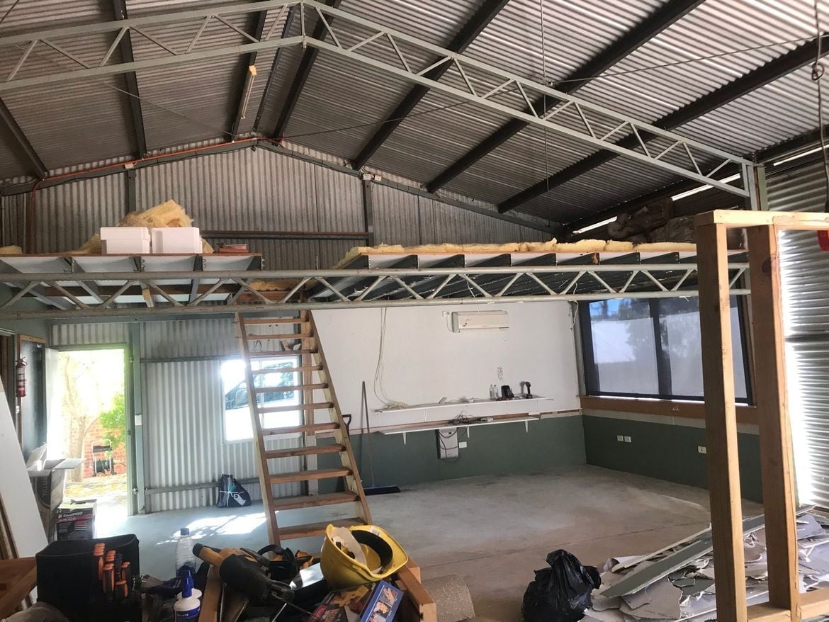

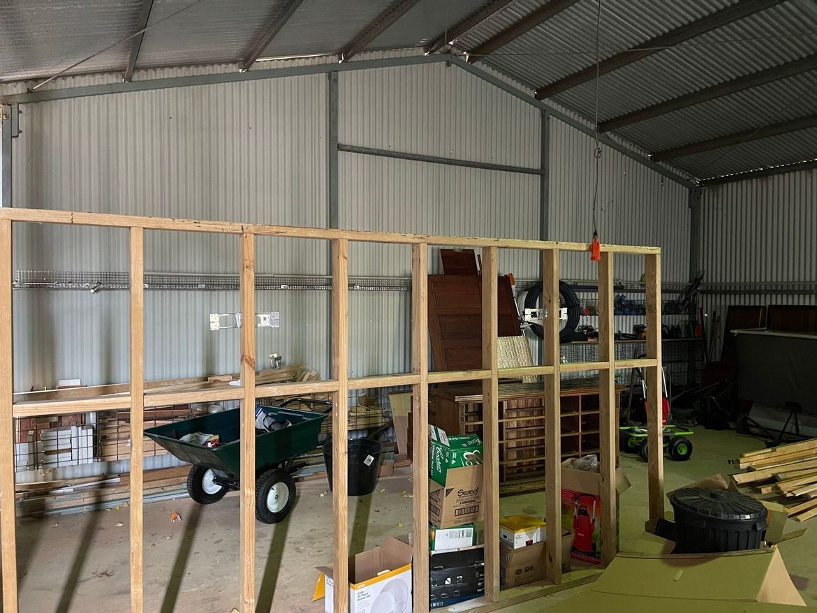

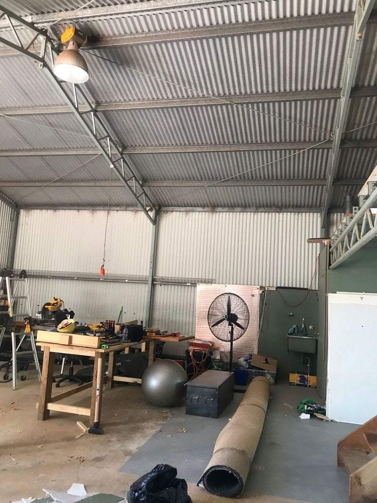

These are some before photos, including the partition wall frame that went up. Apart from the electrics, this was the only things we got someone else to do. We did clad the wall ourselves in plasterboard painted black for the back-drop to the bar.

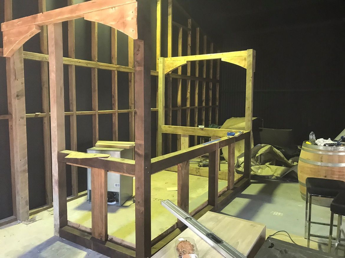

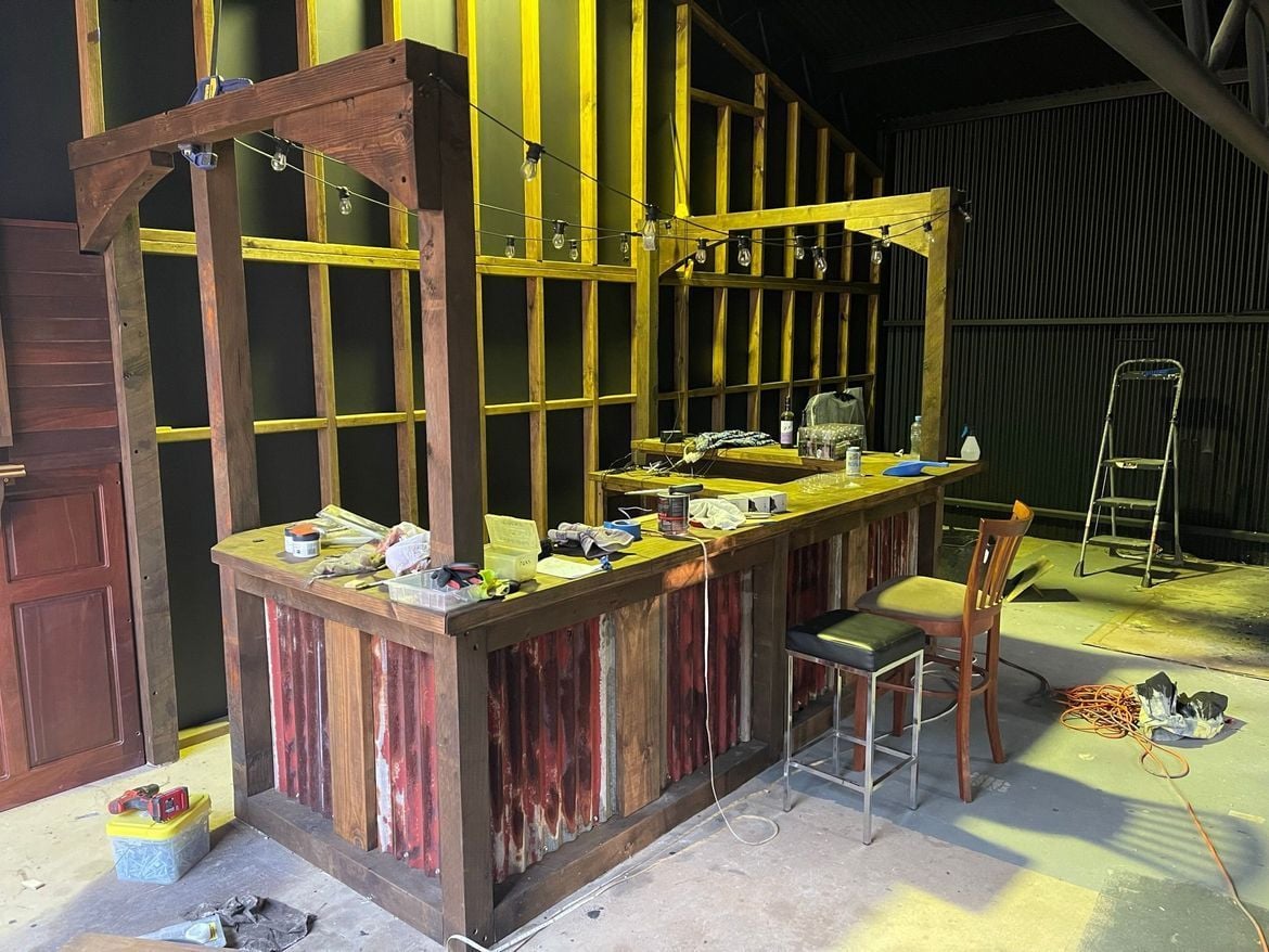

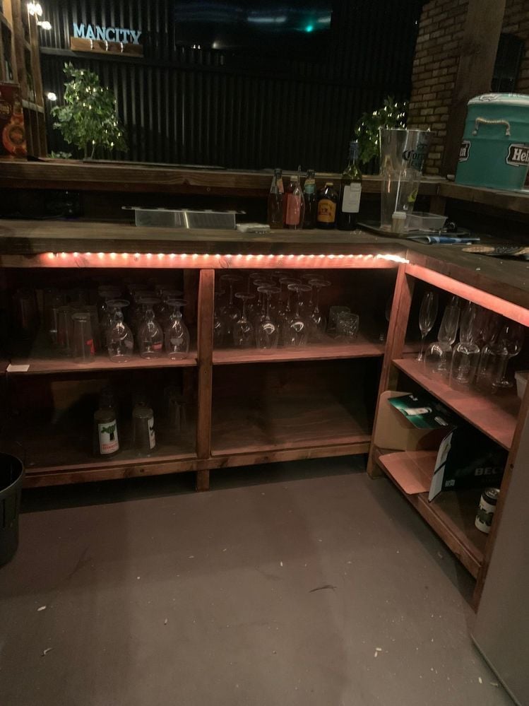

The centrepiece of the whole pub is the bar. I didn't really have a design, I made it up as I went along. Trickiest part (apart from the size and weight of working with such heavy wood) was mitring around the posts and the bar top, as it was two-tiered and constructed using pocket hole joinery. I also made some under-bench shelving units for plenty of storage. For the dartboard area right next to the bar, I re-purposed some panelling that came out of our study that we renovated.

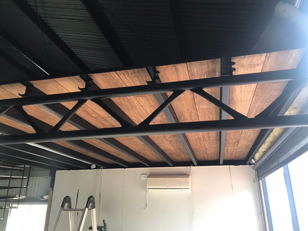

Opposite to the bar was a mezzanine area where firstly I changed the ugly steel girders and white board, to make it look the ceiling was made from wood planks. I did this by firstly painting the steel girders black, and then ripping up some 6mm plywood into planks and staining them, then nail gunning them into position. I was very pleased with the effect.
