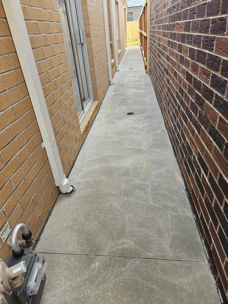

I am looking to build my first narrow side gate with brick walls either side, just behind the downpipe. The total width of the walkway is 1.12m.

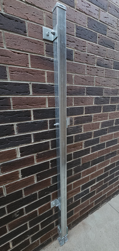

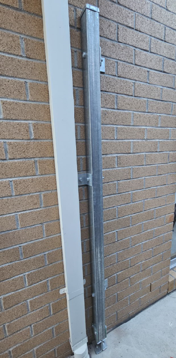

I would prefer to use steel posts at least 1800mm high, anchored to the cement and brick wall.
The concrete (32mpa) was poured on September 28th 2024. Concrete depth of 13cm.

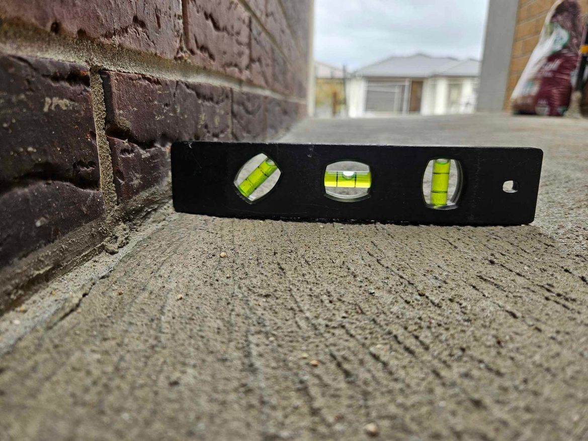

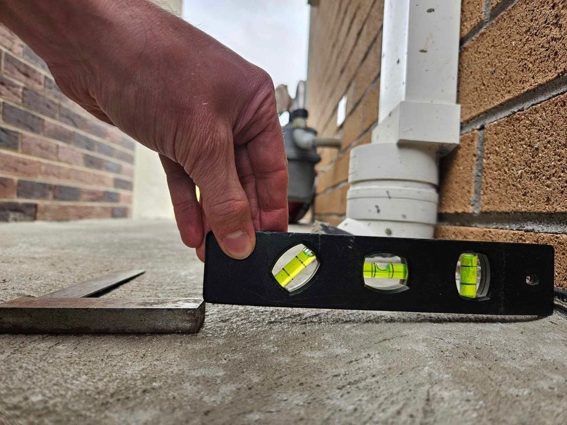

The issue I have is that the cement isn't level on the left side with lighter coloured bricks. It needs packing of around 6-10mm. The right side seems to be fairly level.

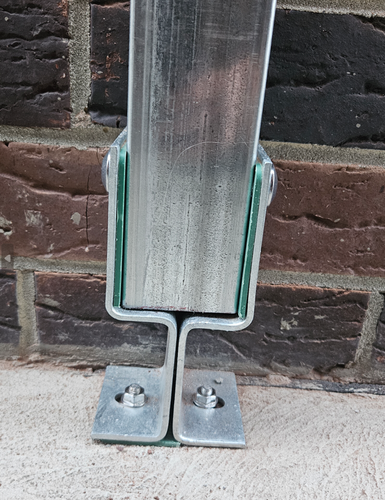

Originally I was planning to use protectoral-50-x-50-x-1900mm-black-aluminium-pool-and-garden-flanged-fence-post but now I am unsure how I would level the cement to have proper contact with the post flange.

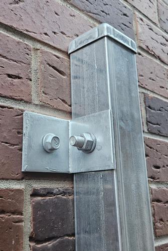

Therefore I started looking into the simpson-strong-tie-90-x-90mm bases. Would that type of post base be a better solution and is it suitable for a metal post? Looking to use a Dynabolt 70mm or so into the concrete. Along with anchoring the post to the brick wall with a bracket of some kind.
