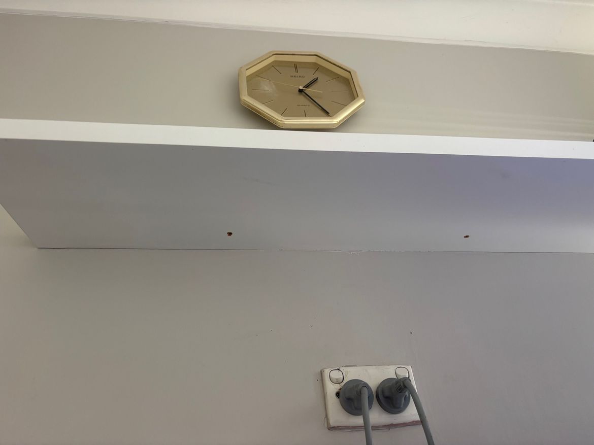

Dear Experts

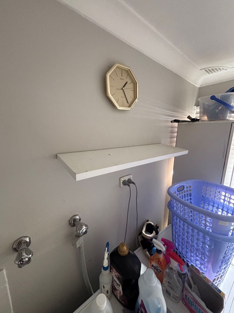

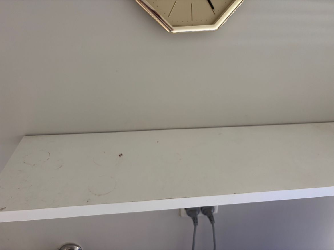

My laundry shelf is loose and I can't locate the screws for it
Please see attached photos and video
https://imgur.com/a/gq9Hxtw
Hello @zillah
It appears to be a floating shelf installation. Does it use a steel flat base with two poles sticking out where you slide the shelf in place? It also appears that you have a timber wall covering and not a plasterboard wall. I propose using either Tox M6 Flip Toggle Bolt or Ramset 3 / 16" x 50mm Round Head Toggle Spring - 4 Pack to anchor the shelf bracket back into position. But if it appears that the mounting points are soft and compromised, I suggest moving the shelf down and screwing it into a new position and patching the old holes.

Sorry for the late reply I was trying to figure out what type of material was used for the laundry wall,,,I am not sure if it is Villaboard as it is wet area ?
How can I dismantle the shelf ? to install it again using your toggle bolt

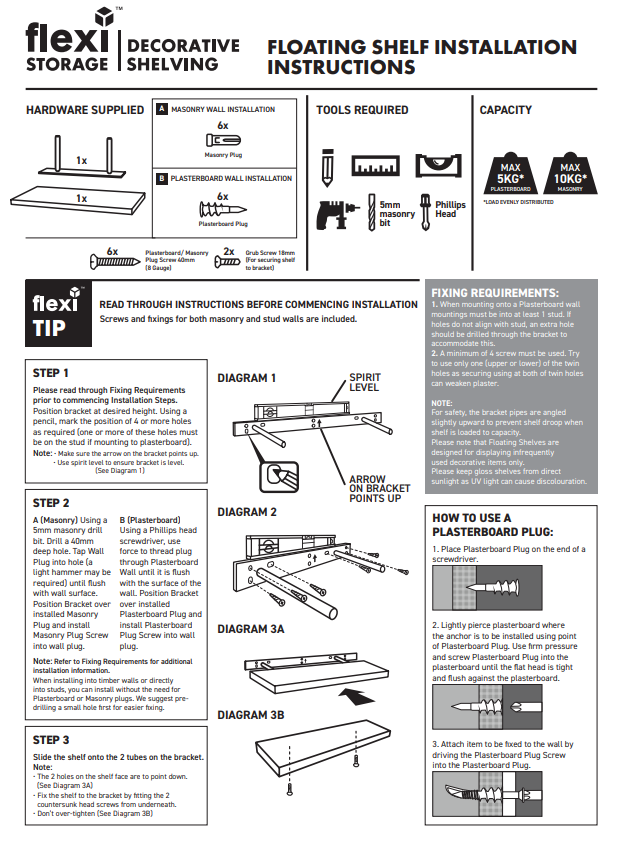

Under the shelf there are two tiny holes. They contain grub screws that could potentially be configured for Allen keys or a Philips screwdriver. If you can peak inside the holes, it will give you a better idea of what tool to use. Once you get those grub screws out you can then pull your shelf off the blind mounting bracket. If it appears that the old mounting points are soft and compromised, I suggest moving the shelf down and screwing it into a new position and patching the old holes. Can you please show us the screws or fittings that were originally used to install the shelf in place. Once we see this, we can then make recommendations on how to proceed. I've placed a sample installation manual to give you an idea how the shelf is installed.

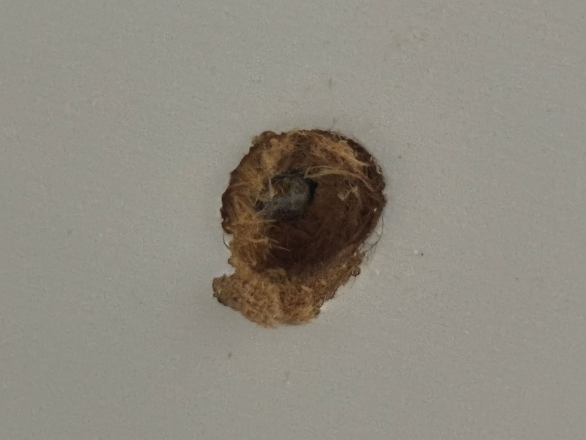

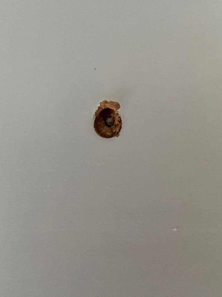

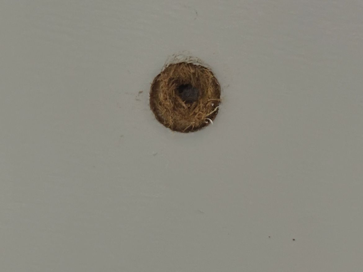

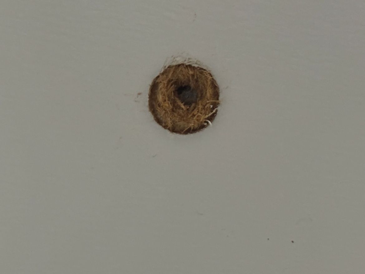

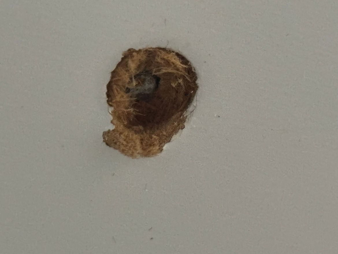

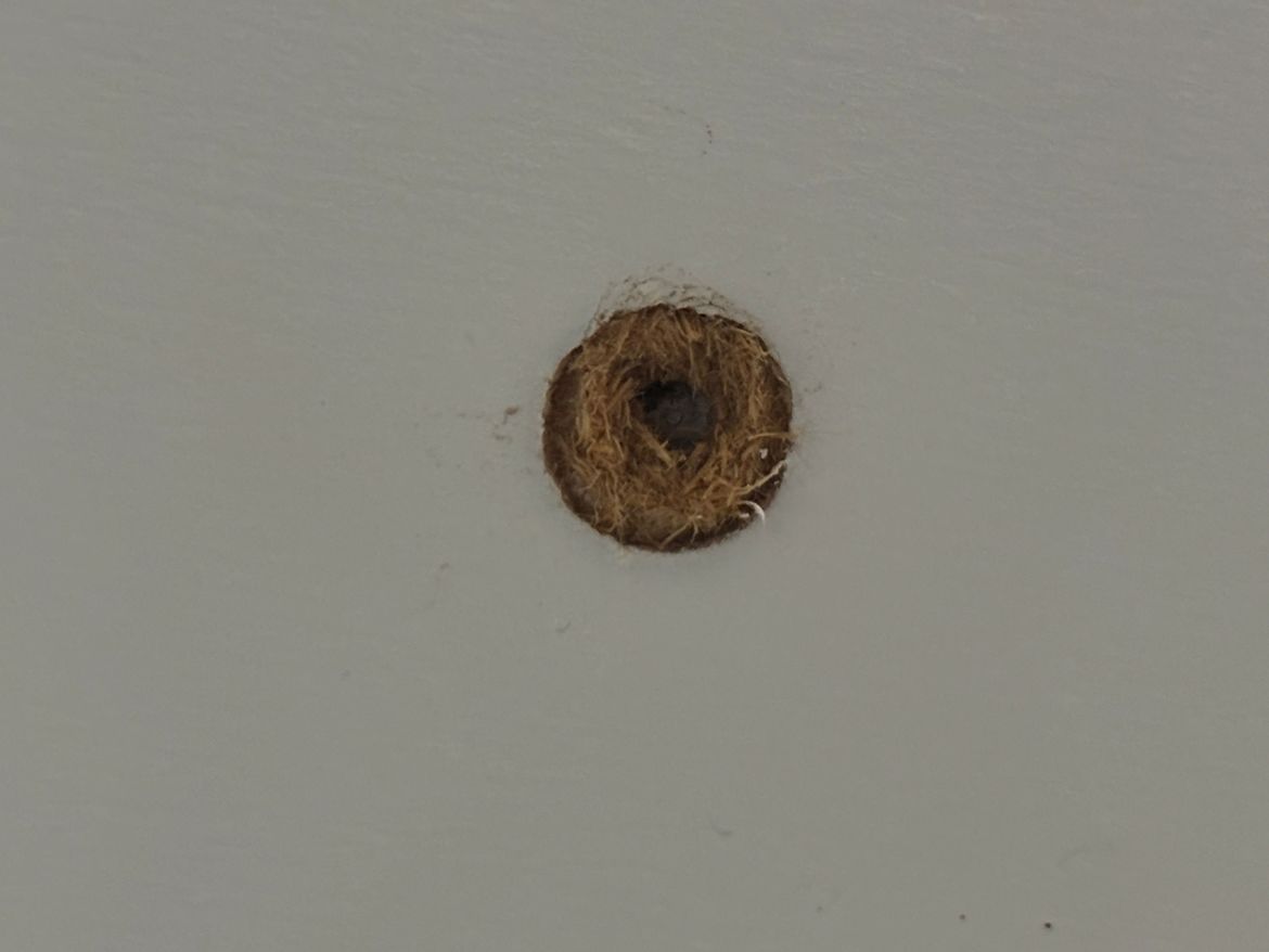

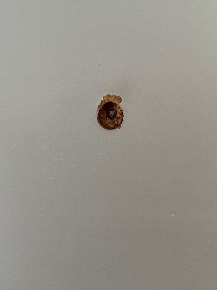

I failed to figure out what type of screw is used please attached photos ,,,It is not Allen key head nor Phillips head

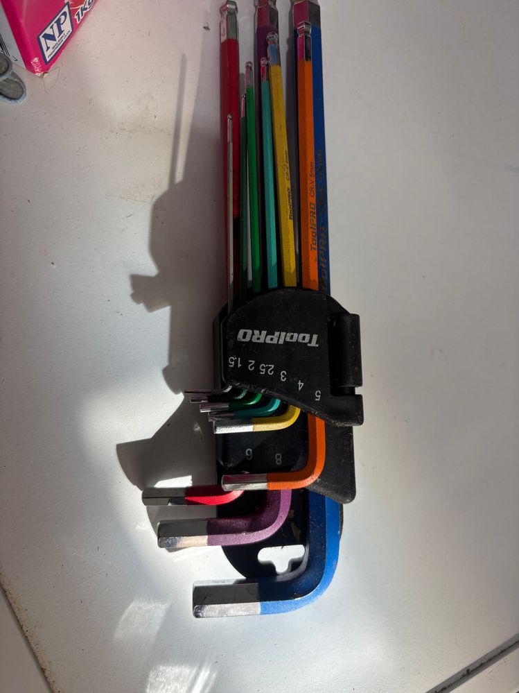

I'm sorry to hear that you could not remove the locking nuts to your shelves. Thank you for posting those extra photos, it appears to be a hexagonal opening. I suggest using a larger Allen key or a midsize one to see which one fits. Once you find the correct size, turn the key anticlockwise to loosen the screw and remove it from its location. Once both screws are out you should be able to pull the shelf out of the hidden wall bracket. Please give this one more try and let me know if you succeed.

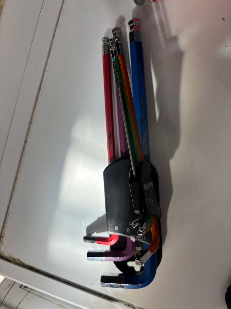

I tried couple of those Allen key but I couldn't grab the hexagonal screw that is located in awkward position
My only other thoughts are to see if you can use a flathead screwdriver and see if you can anchor the head to the tool and see if you can turn it. If this fails, the only other tool I can suggest is to use an IRWIN 3 Piece Screw Extractor Set 1876224.

Maybe try an imperial set of Allen keys before the screw extractor? That could be why the allen keys dont quite match up. I would also clean up all teh fibres that may be hanging over the edge of the allen head screw as well.

I'm half blind - but it looks like a six-sided bolt head to me?
The large fibrous hole I just assumed was for the socket?
Hi @zillah
I can’t see a hex shaped recess in the head so it’s not going to be an Allan key especially with a head that size. From the first photo it looks like a hex head from a coach screw or bolt.
if that’s the case you will need to open the hole a bit more to fit a socket on to it. Then as @EricL suggested it will undo counterclockwise

I have cleaned both holes as there are two holes
It appears that the heads have been sheared off. I propose going with the IRWIN 3 Piece Screw Extractor Set 1876224 in order to remove the body of the screw.
Hi @zillah , just another thought is the get a small is to get a small chisel , 1/4 inch wide and chisel out the wood around the screw , which should then release the shelf from the screws, then get a pair of pliers to remove the screws.

The screw heads have been stripped/burred away by the look of it. Trying to extract teh screws might be problematic and saving the shelf for reuse is heading to the low side. Apart from chiseling out the timber around the screw as @JoeAzza has suggested and @EricL ezyout suggestion I am thinking of cutting off the supports going into the wall. With the issue of the screw heads either being a hex head, allen key or ??? It will be problematic to remove them and also in reusing the threaded area as well.

If you go back and look at @EricL 's post of how the shelf should be installed (its an instruction page) on the first page of this topic it shows how the bars are connecte dto the btracket that is mounted on the wall. A hacksaw blade or sabersaw would be the tool I would reach for. In the video you posted a link to, the shelf moves with a resonable flex to it already. That suggests that the screws holding in place may have weakend/stripped. You could flex it some more to see if the whole bracket peels away from the wall. I wouldnt put lots of pressure on it but some and see how it feels.

Thx Dave I have checked the instruction that Eric posted yes it showing everything clearly
