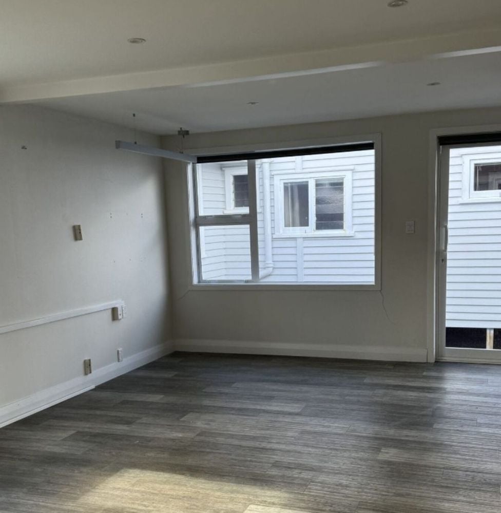

The room beforehand.

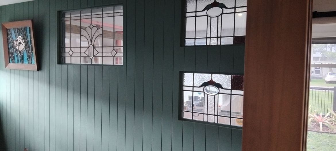

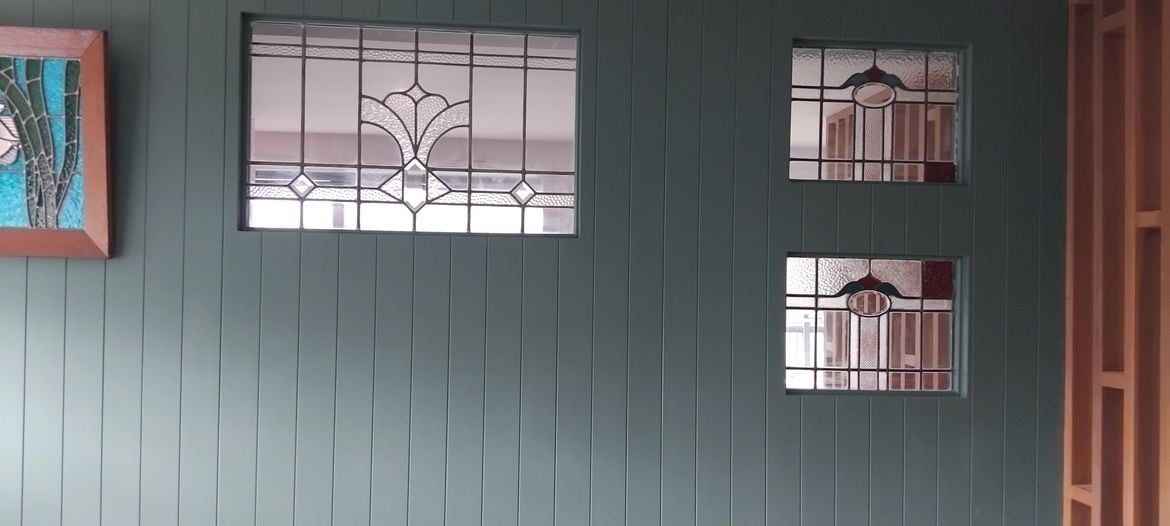

Filled and sanded all nail and screw holes. Applied 4-in-1 sealer, primer, undercoat on MDF VJ panels. Next day windows installed. Again, filled nail holes, sanded, 4-in-1 sealer, primer and undercoat on windows. When dry, painted one coat of green.
Step 4
Next day - final coat on wall, windows, and skirting.
