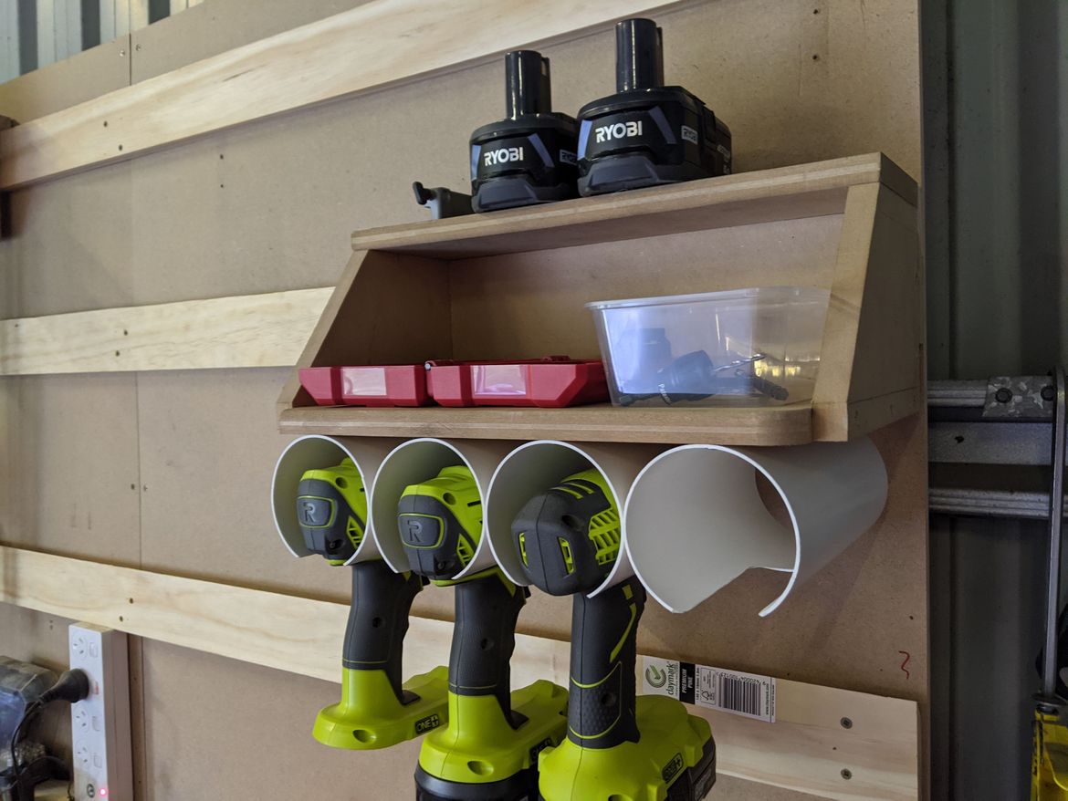

I am happy with the Drill Station, using 90mm PVC is ok, but would opt for something a little thicker walled next time.

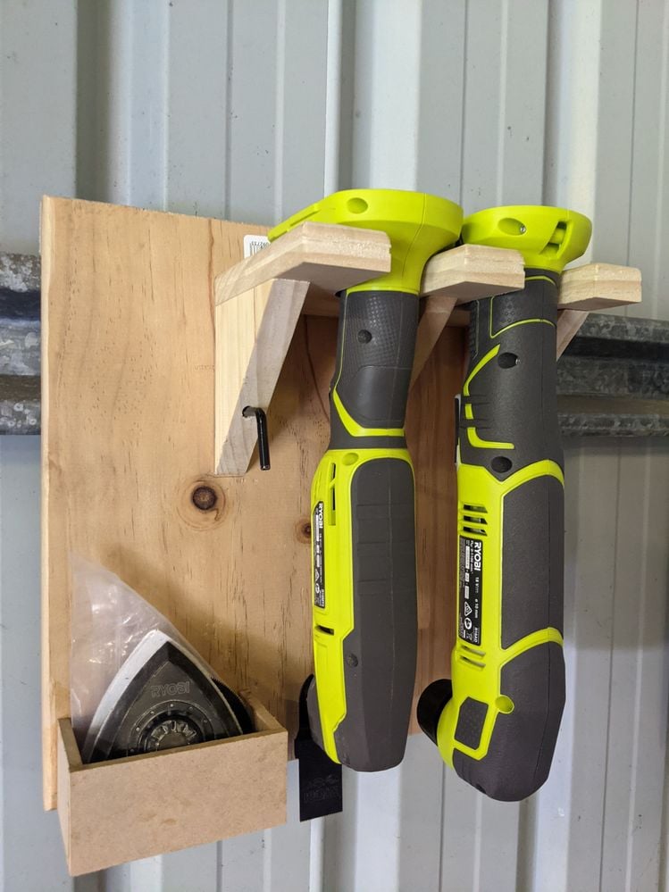

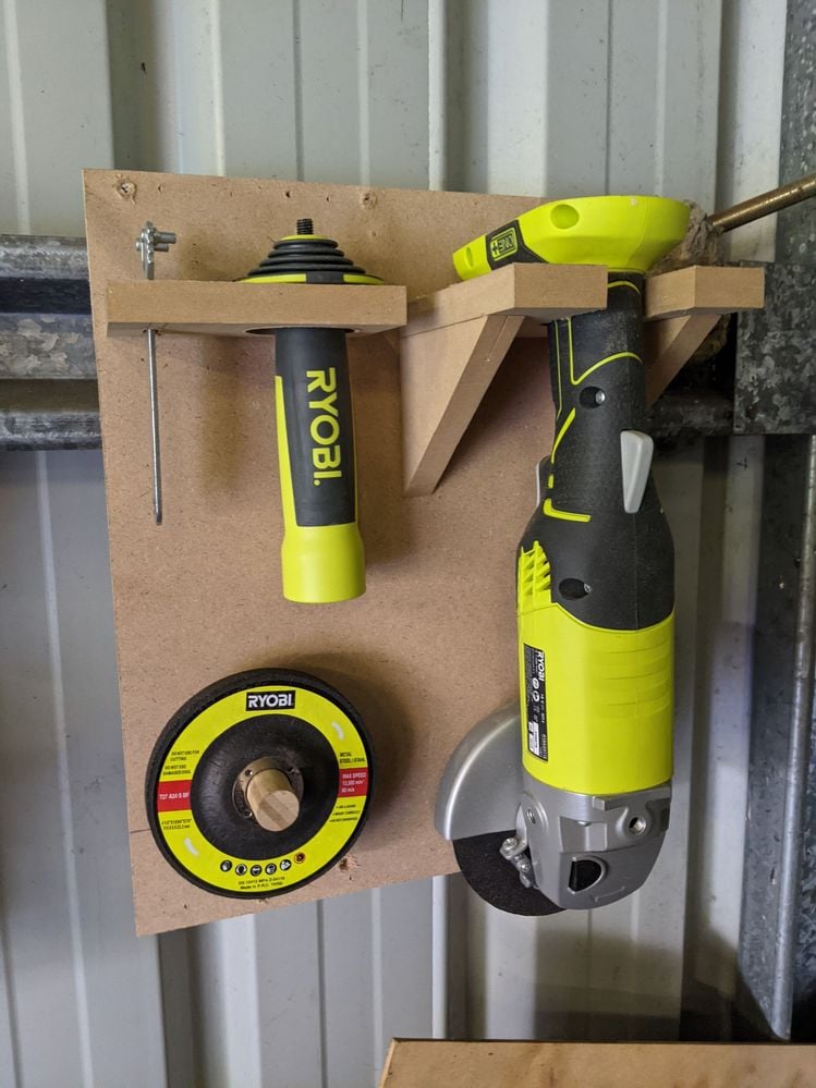

My favourites are, the holder for the Angle Grinder and the twin Multi Tool and Angle Drill holder.

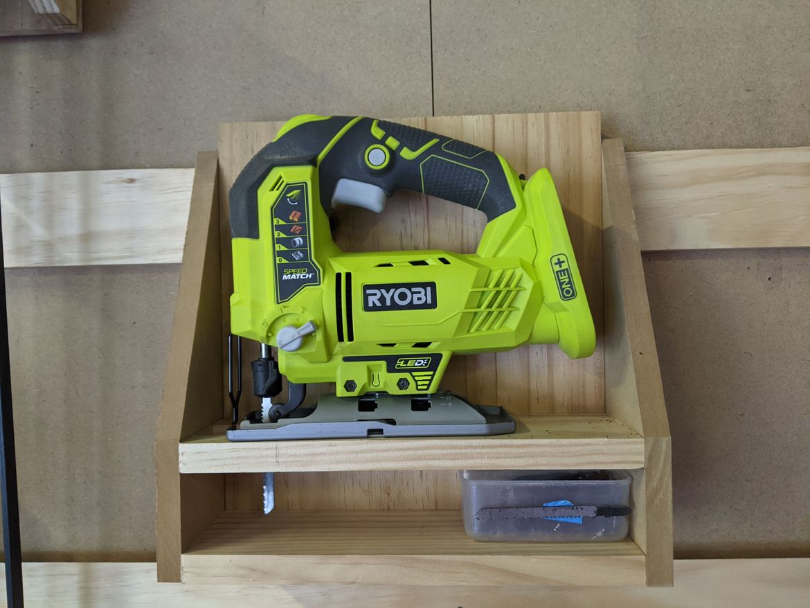

Jigsaw holder is great with a shelf for blades etc.

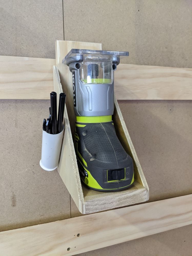

The holder for the Trim Router is ok, but I might expand it to include some router bits.

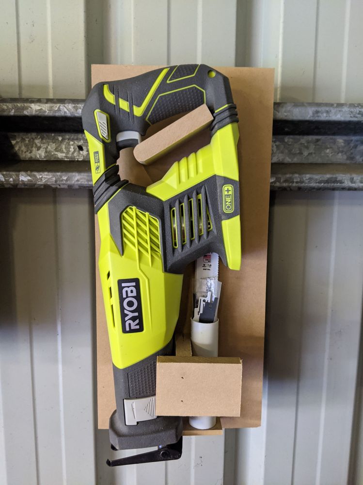

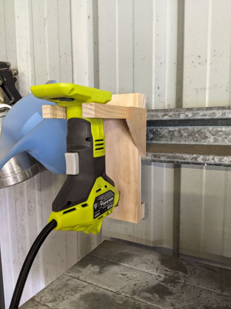

A couple of quick holder for the Digital Pressure Inflator and Reciprocating Saw.

You might notice that the French Cleats on the back of the holders also work on the 'C' section of the shed wall.
