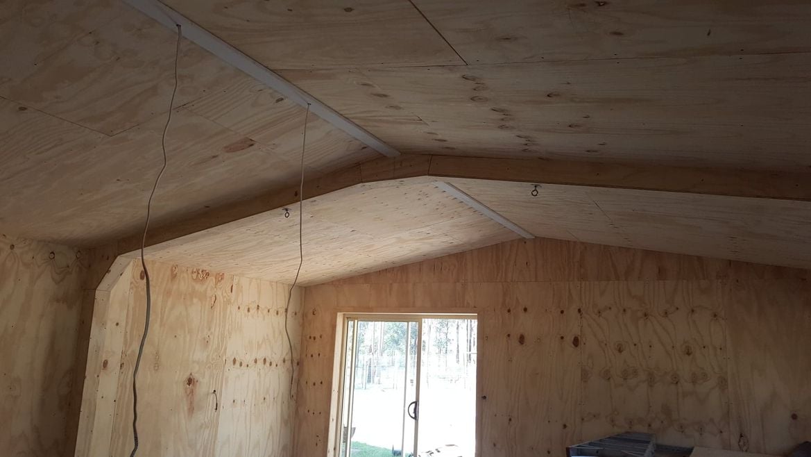

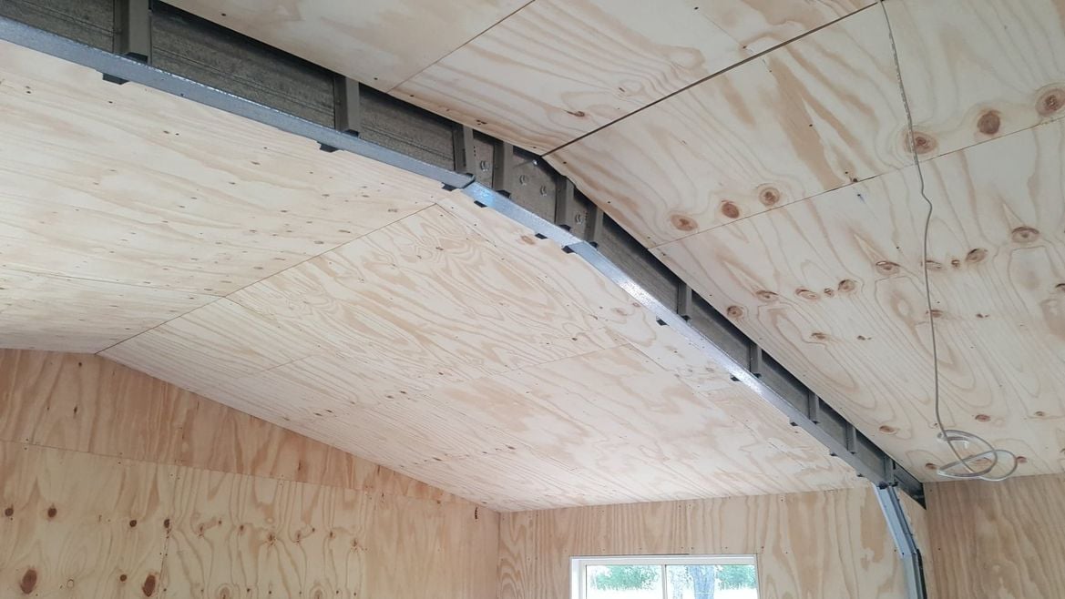

Roof lined, beams to box.

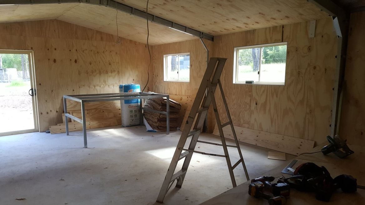

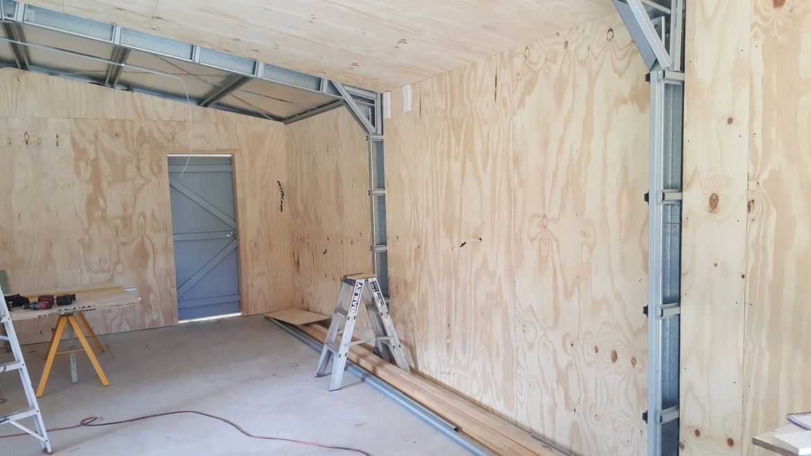

Walls insulated and lined.

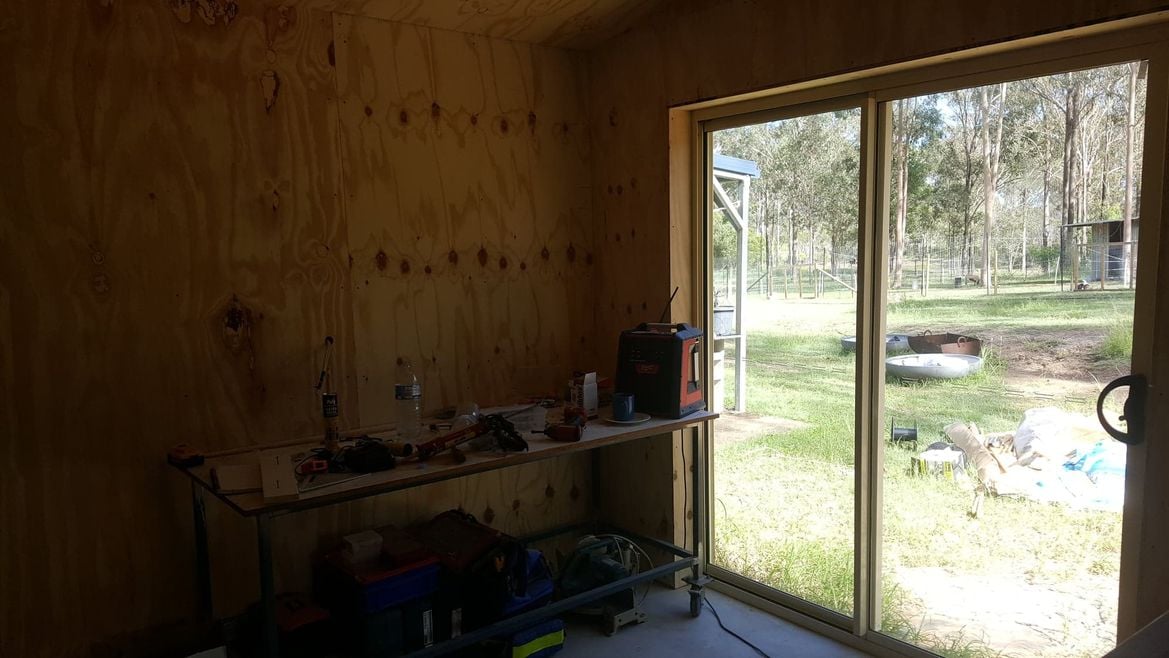

Sliding glass door boxed out.
Windows boxed, trim to come.
Access door boxed.

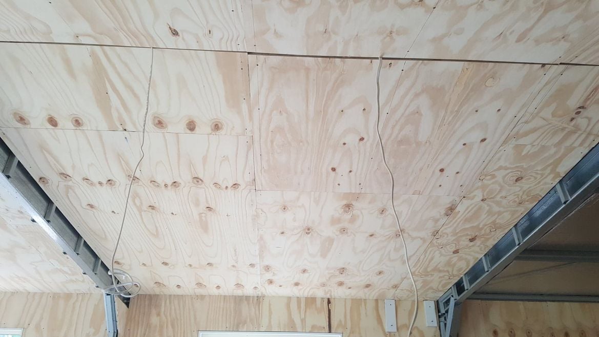

Roof all in.

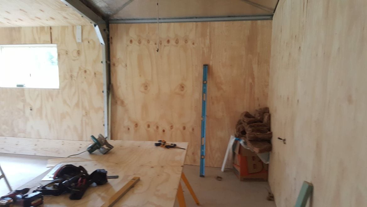

Between work and a million jobs going on at one time, we have all but prepared the studio for painting.

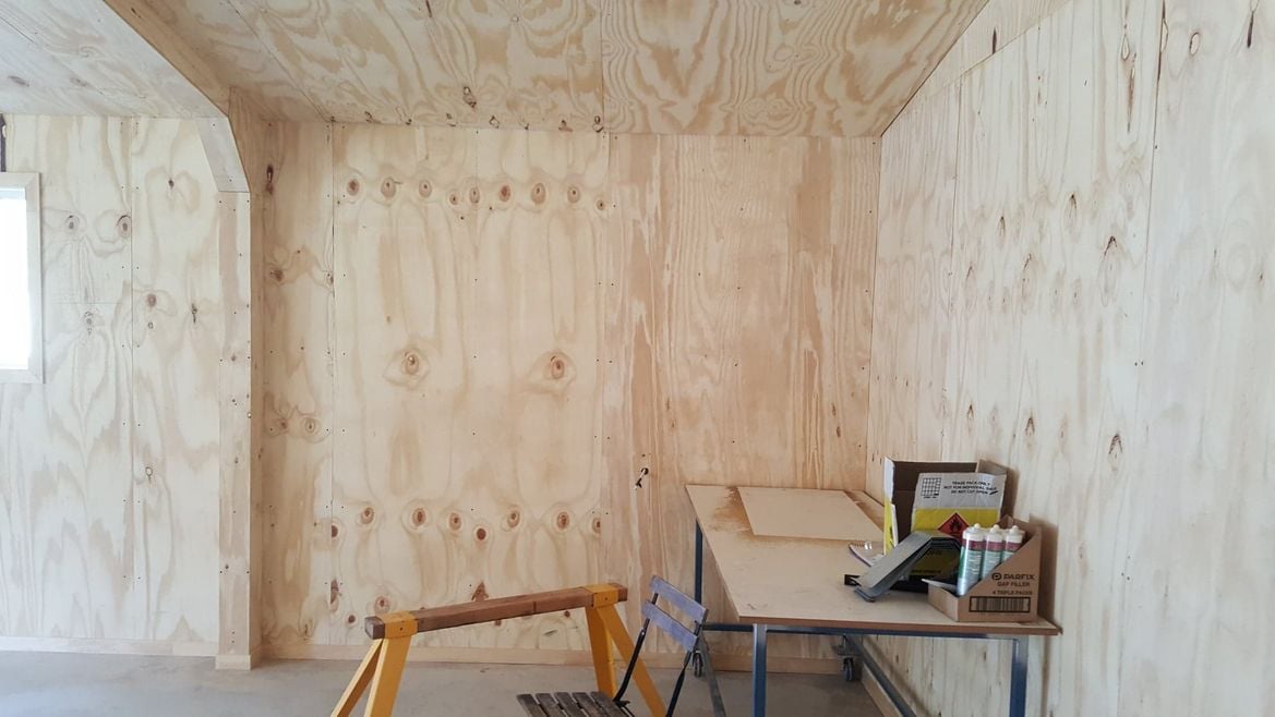

Well pleased with the ply. We were looking at Gyprock initially but the nature of her work lent itself to ply as there will be loads to hang up, including pegboards, and it looks great.
When preparing the ply for painting, make sure the smooth side is facing you, do a light sand and away you go. We found that we needed to do a few light patches with filler over the knots, then a good primer and your top coat.

Pulling in a couple of large tables we purchased recently. These will be used for some of the larger machines.
