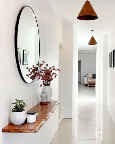

I am wanting to do VJ panelling in the hall way. Has this been attempted and are there any photos to see the end result. The hall way walls take in light from front door and getting a good painted finish with light reflection is hard.

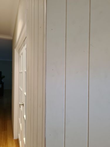

You need to leave an expansion gap around the panels (top and bottom and where the sides butt up to a wall).
Filling these gaps somewhat defeats the purpose of then in the first place but if you doninsist on doing it as some people do, use a high quality, highly flexible filler. Note - while this type of filler will allow for thermal movement moreso that cheaper less flexible fillers, there's a risk that over time the filler will crack where it meets the panel so you'll need to patch/paint when the time comes.
An alternative is to cover expansion gaps with timber or aluminium trims depending on the style/profile you like.
Some installs I've done showing the points I've made above.
