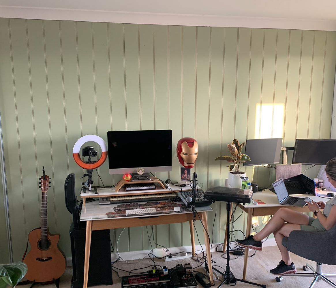

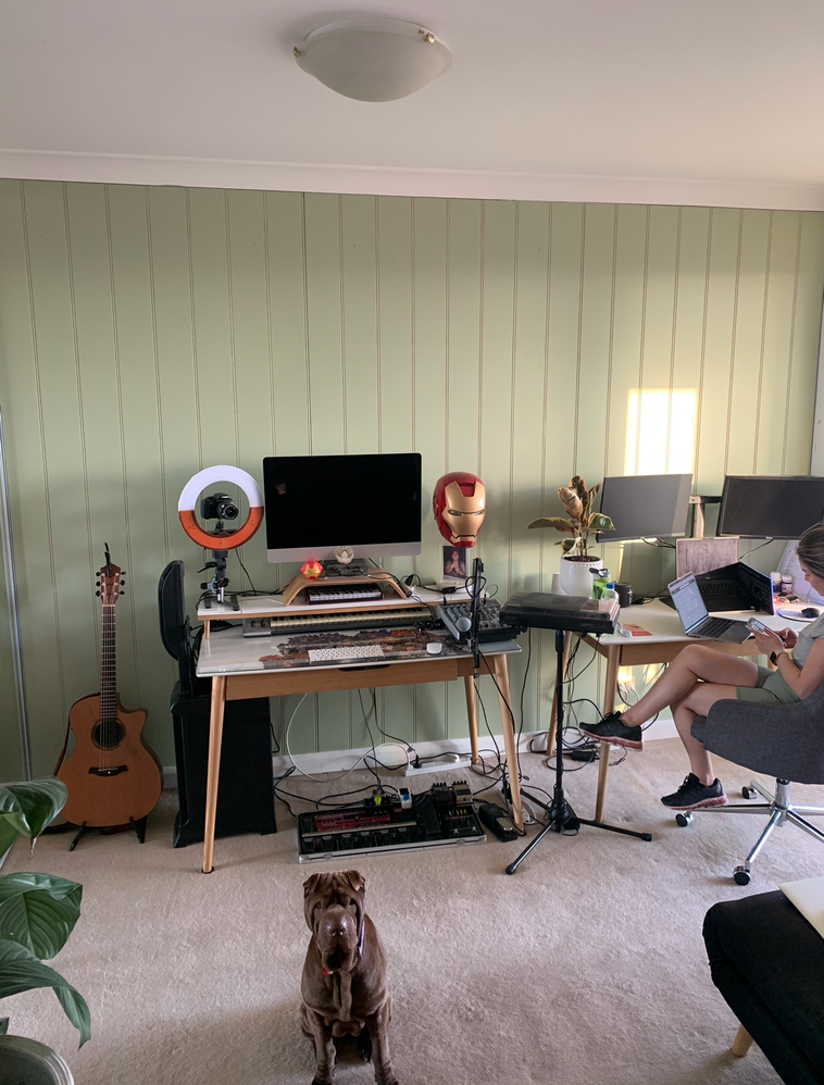

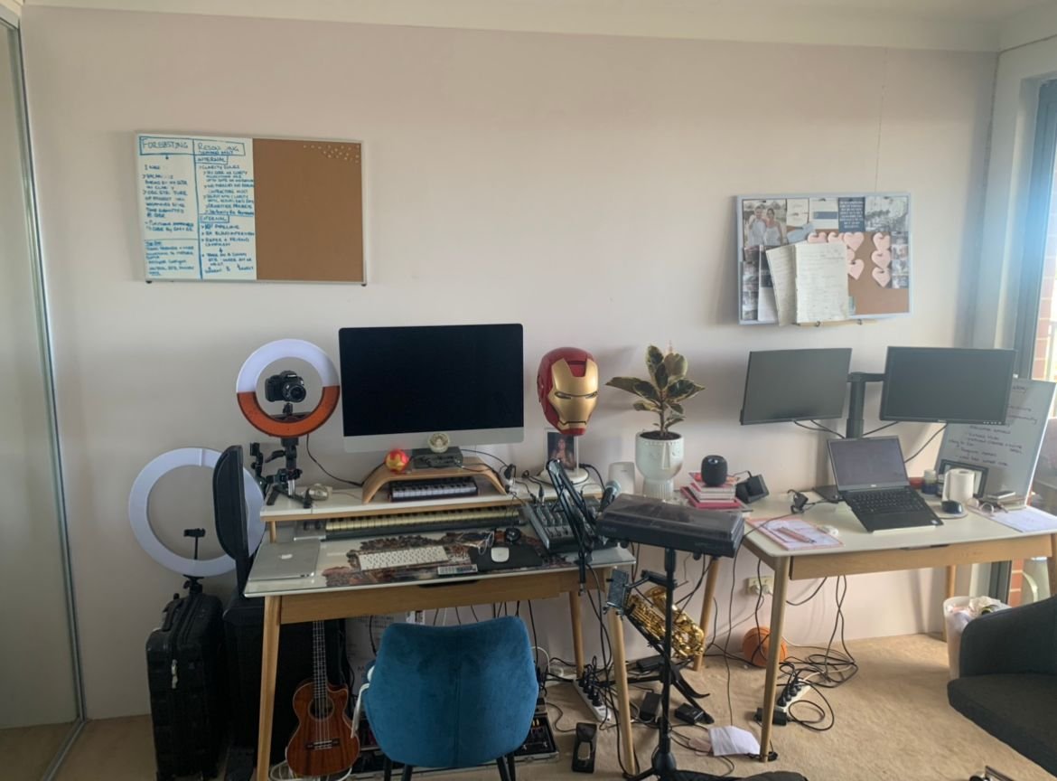

We live in a two bedroom apartment and the second bedroom has been turned into a work station while I work from home and a music studio for my partner. It was a tired room with a hint of purply white walls. The worst part is that because of the way our room is shaped I have to face the ugly wall all day every day for work. So I thought to myself, what can I put there to make it pleasing on the eye?
I then stumbled across this Bunnings video about How to create a VJ panel feature wall. We went with the Easycraft EasyREGENCY 2400 x 1200 x 9mm primed MDF interior wall linings.
The panels were 10cm too short (which we knew when we bought the panels) so we decided to hide the bottom with skirting. We glued the panels onto the wall, made sure it was level at the top and drilled into the concrete walls, fixing the panels to the wall by inserting a plastic plug and then screwing into the plug.
We went for a lovely green to give our room some life and it's a much more vibrant room to work in.
