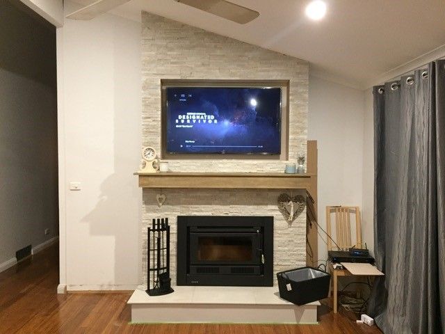

A plain wall was transformed into an attractive and functional space with a wood heater, bookshelves and stone-clad feature wall.
The project
This D.I.Y. project was not for the faint-hearted and needed more than just help from my husband. We did the work ourselves but had a plumber sign off on it, which included the flue installation.

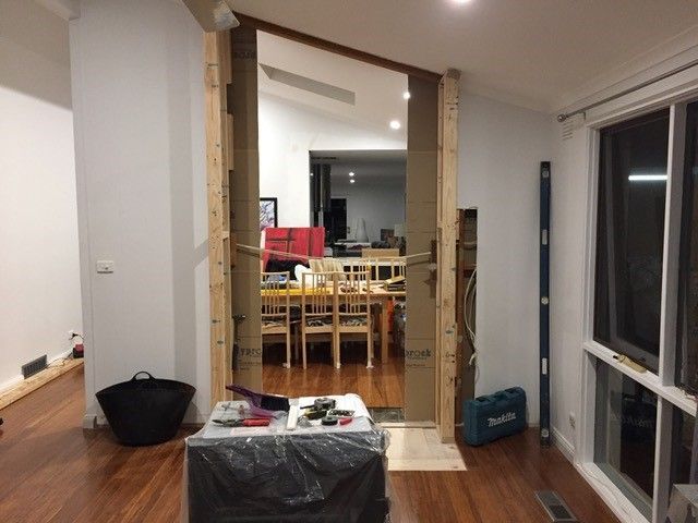

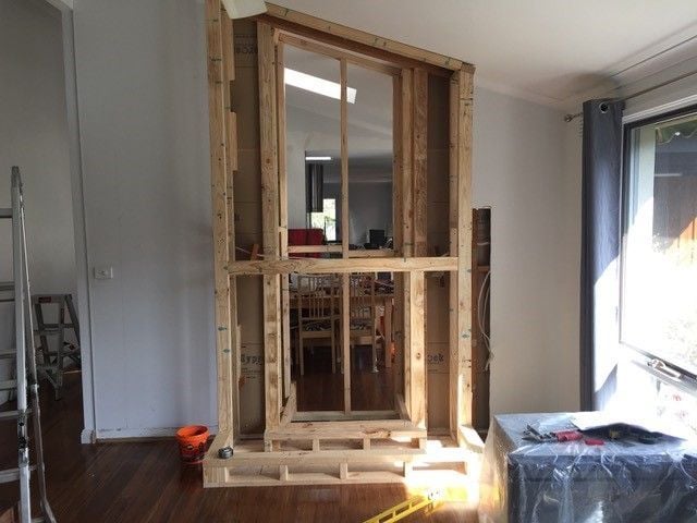

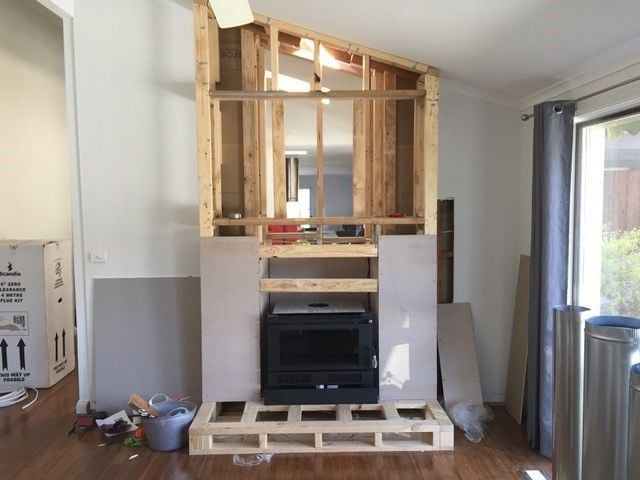

- The most significant challenge came at the design stage. We had to use space from the room behind to house part of the flue. We had to protrude into the other room by about 250mm as I didn't want to compromise on how deep the shelves were or they would have been right up against the window.

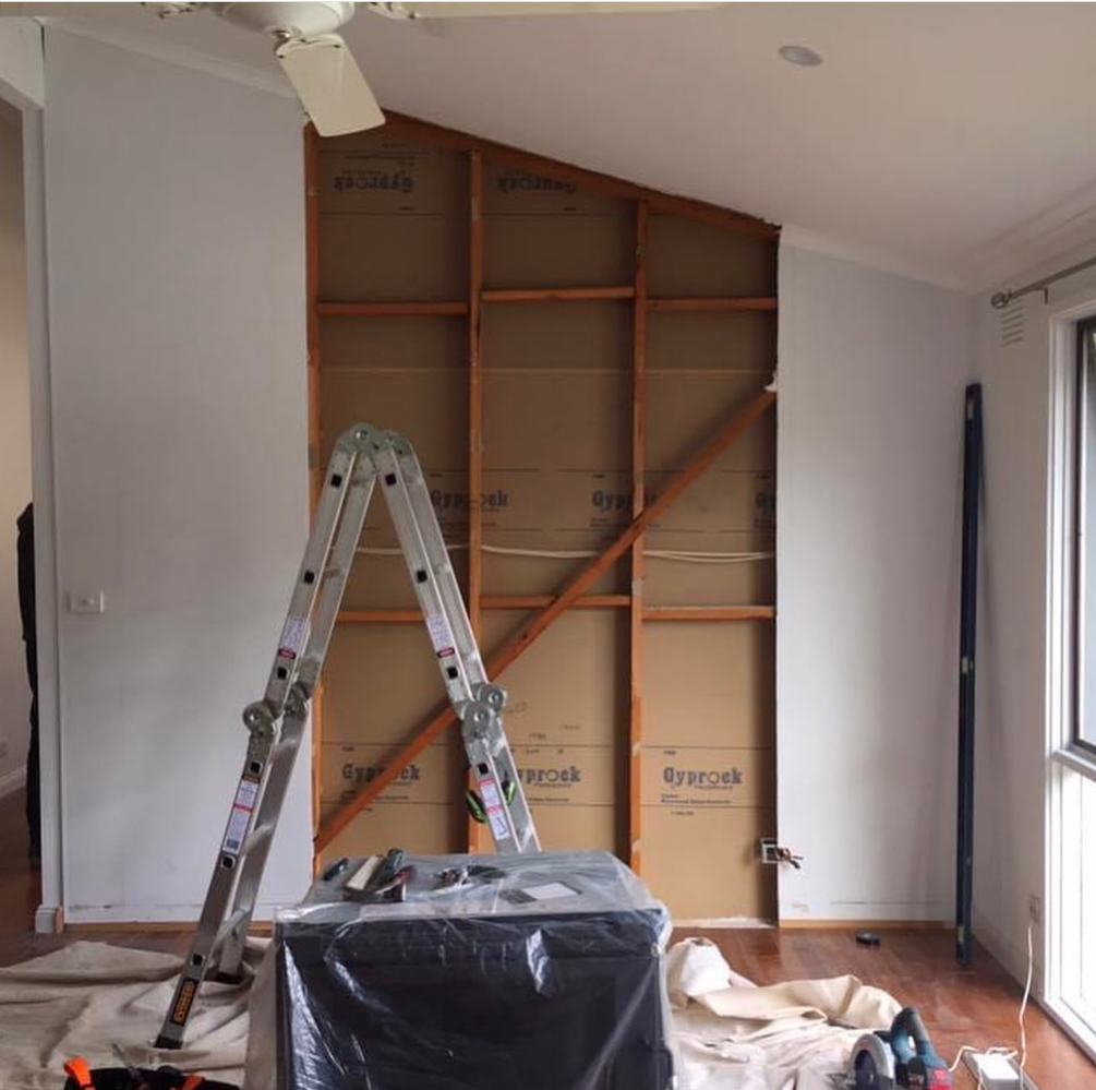

- Once we started demolishing the wall and ceiling, we noticed that a roof rafter went straight across where we needed to put the flue, so we had to split it. Luckily my husband is a carpenter and we have lots of builder friends so we knew what we could and couldn't do.

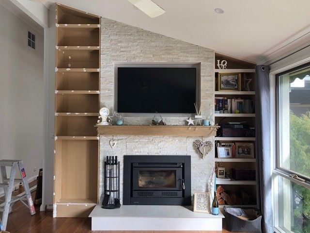

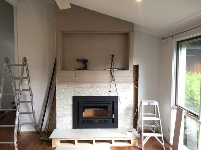

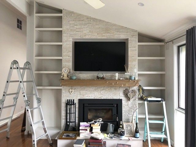

- Once the fireplace was complete, we started the bookshelf using particle board. This was a mistake! The cut edges were really rough so I had to plaster them. It was ok once it was painted, but a lot more work went into it compared to the left bookshelf when we used MDF.

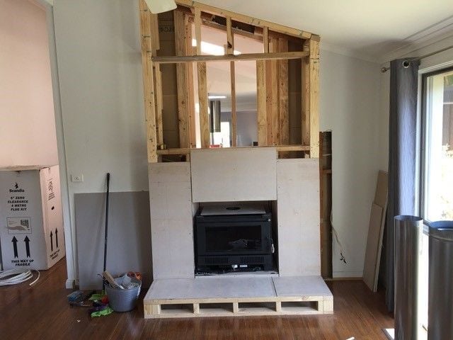

- The wood heater was very heavy. I managed to help get it into the house, but we needed extra help to get it into position in the wall.
This project is my favourite renovation achievement. I love the result and it's a great feature.
