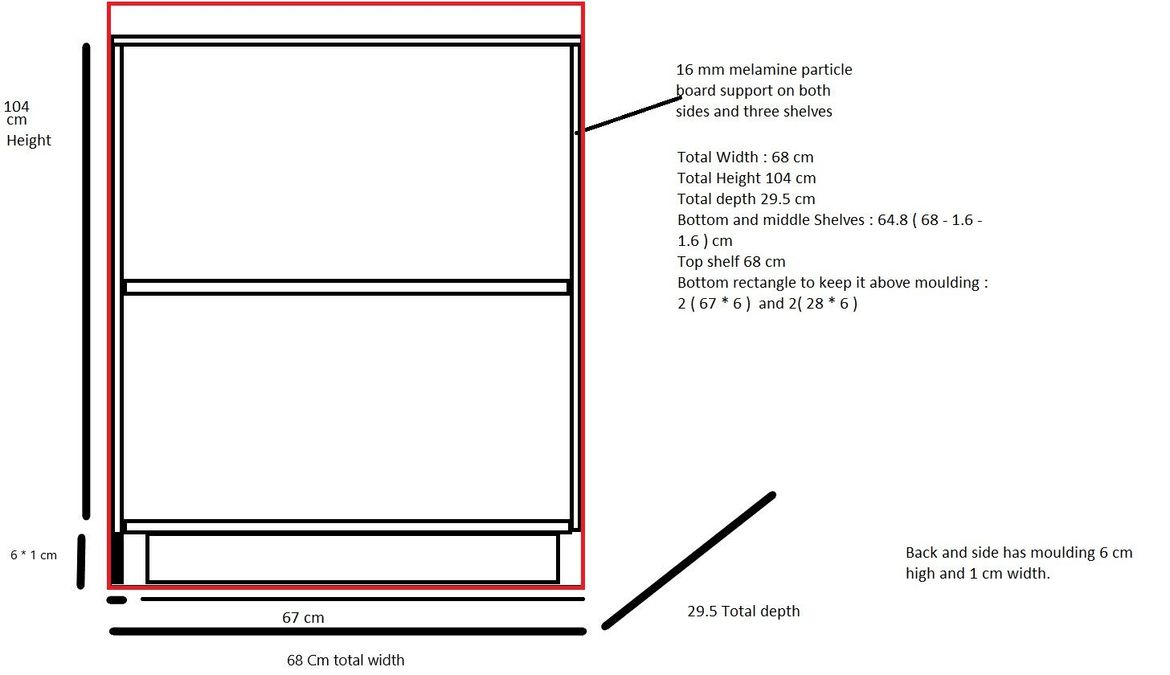

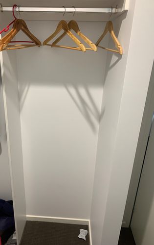

I have wardrobe with no shelves or partition, so i want to build standalone insert shelves that sits between
the current partition. I have tried to measure and put down on paper roughly.
Question : a) Is that the correct way to measure or do i need to leave more margins on side
b) Is melamine particle board good for wardrobe
c) Do Bunnings cuts board to size or i can cut using reciprocating saw
d) What kind of screws to use with melamine
Any additional tips for first timer
