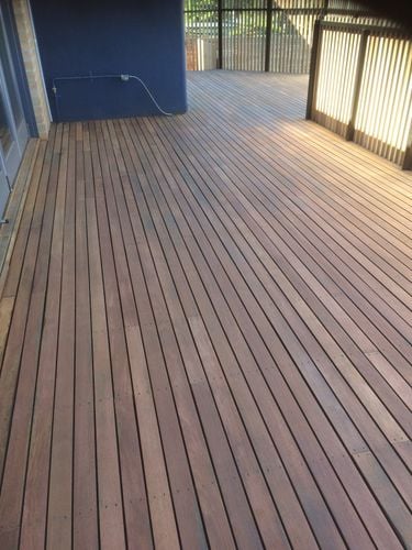

I thought I'd share my current deck renewal project.
The deck is around 10 years old and was looking pretty shabby. The timber is merbau but I wasn't sure what the original coating put on the deck was - something with a coating that peeled off in parts (as opposed to an oil).
Subsequent oiling never got a brilliant result despite how much I scrubbed and blasted with the pressure cleaner - it was clear that a full sand back to the bare timber was needed.
In preparation for hiring a floor sander I purchased an orbital sander and sanded back all the edges of the deck with 40 grit paper. It's hard work on the hands and knees but I was happy with the initial results, giving me confidence that the deck was going to come up well after the job was complete. Here's a rough example:

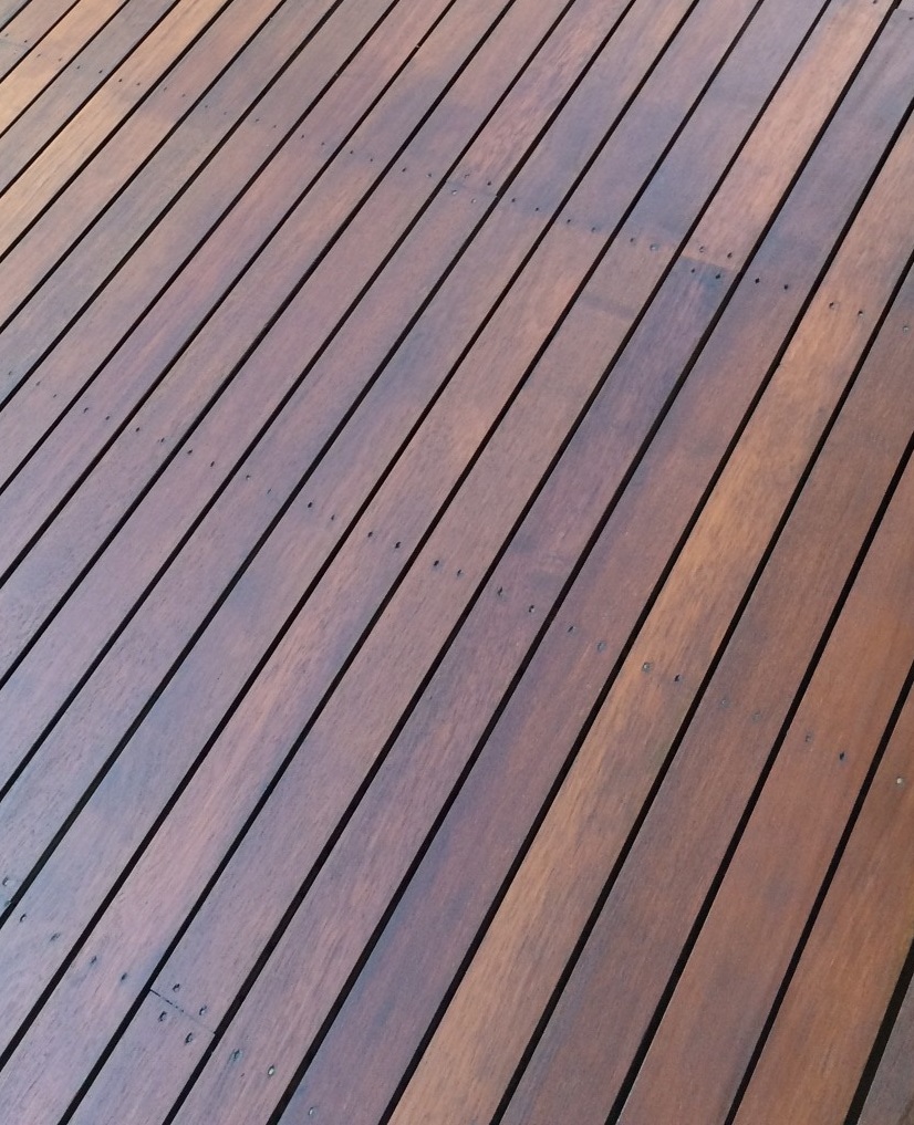

I hired a floor sander on Saturday. They are heavy beasts but surprisingly easy to use. It's a job anyone can do - even those with limited skills like me! Again I used 40 grit paper for the first sand, then went over again with an 80 grit. Here's a few sanding progress shots:
Final step in the sanding process was to get the orbital sander out again with the 80 grit paper and tidy up any spots that were a little rough or needed a little more work.
After cleaning up I started oiling the deck. I got one coat on Saturday and one coat on Sunday morning, but with rain forecast for Sunday afternoon/night I couldn't get the third coat done. Hoping to get to it in the next couple of days and will share the results. It looks like it will be a big improvement and well worth doing.
