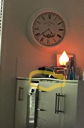

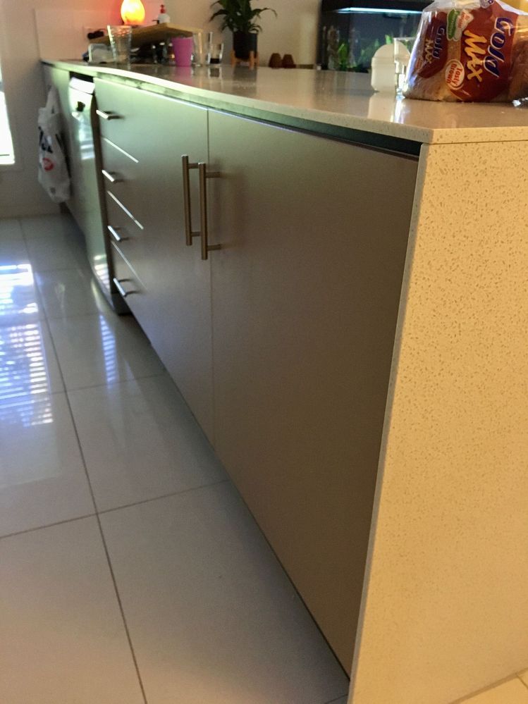

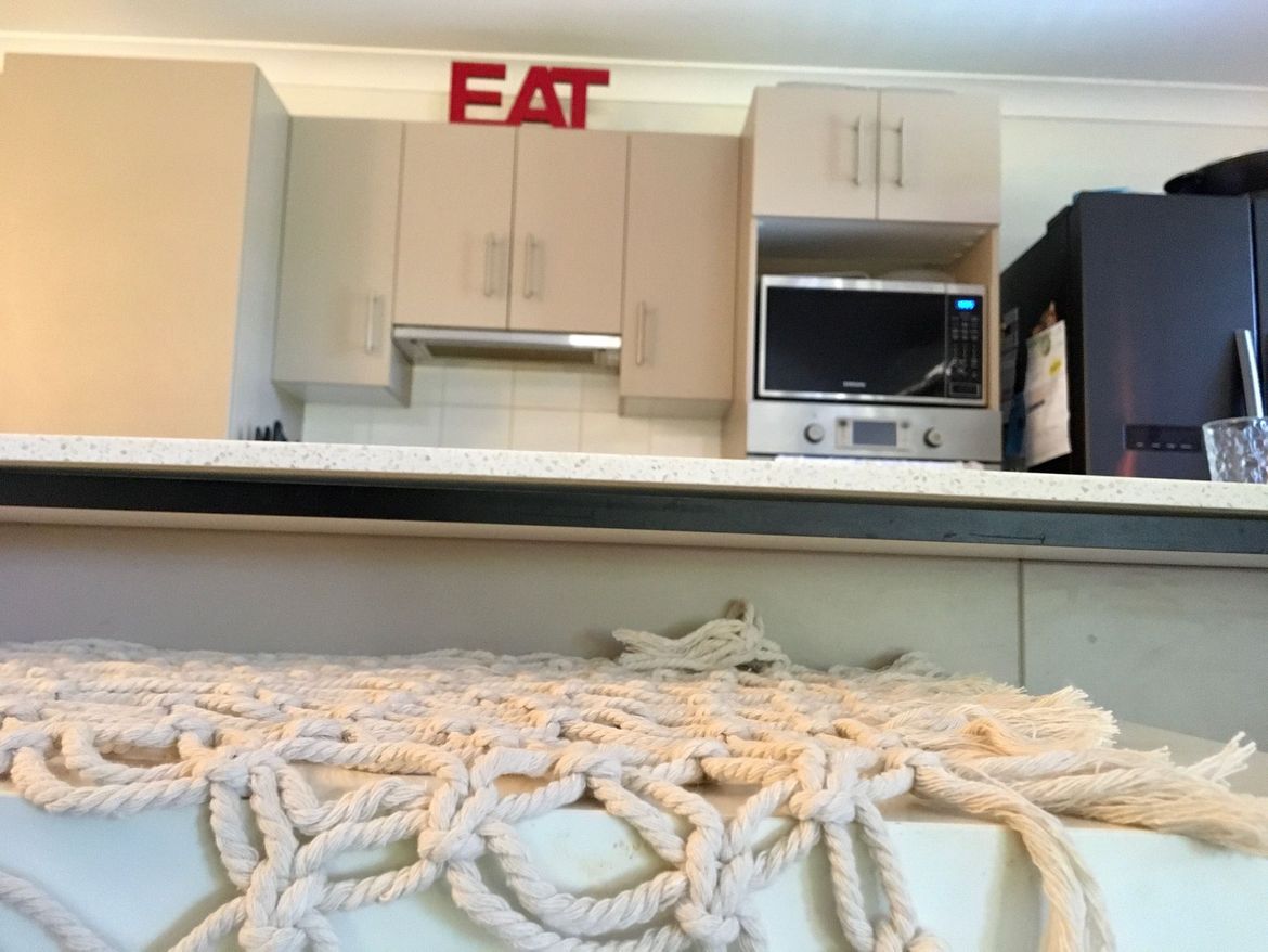

Hello all, first timer here to the community and my first post. I am seeking advice on the steps to firstly remove and then replace this warped faux stone benchtop. I think it was caused due to hot items on top causing it to rise up. I have tried regluing and clamping down to no avail. So it looks like it has to go and replace with a new one. I am looking at the Kaboodle range but am such a novice so any advice much appreciated, thanks.

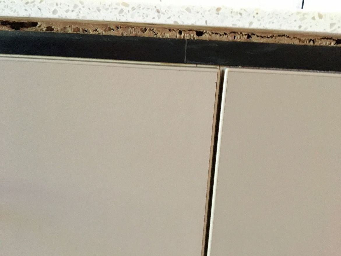

Hi @Simone1976 , that amount of warping, plus the profile of the top in your photos says that this is a stone-look melamine. Any type of actual stone would break rather than warp. This means that to remove it, you need to open doors and remove drawers to expose the screws which will be holding it in place. The glue which can be seen, is best cut through with a multitool and blade, but you might also be able to get a handsaw in there instead. That will help you find where any missed screws are too.
That amount of warping could be caused by water getting under the laminate and distorting the particle board carrier or heat, as you said.
There's no way to undistort it unfortunately.

You'd need to take some slightly better images that depict the situation and provide more details on how this warping occurred for our members to assist with repairing the current benchtop. For a warp like that, you'd likely need to install some brackets to pull it back into position.

Have you tried contacting the manufacturer/supplier and questioning whether this is something you could claim under warranty? When you say it's a faux stone, is it engineered quartz-based stone? That amount of distortion seems quite unusual. Did the area experience high heat for a prolonged period? Perhaps a pot was placed down there?
If you could clear out the glue (liquid nails?), you might like to try epoxy or perhaps Sika 290ml Sikaflex®-118 Extreme Grab Construction Adhesive. Sika 300ml Black Sikaflex-252 Polyurethane Adhesive could hold, but it might be a bit flexible to keep the bench in place. I think that you'd potentially need to drill and epoxy plugs or threaded studs in the underside of the bench and use them to pull it down with mechanical force.

Is the material flexible enough to clamp and pull completely back down into position? I wonder if an application of heat (being careful not to burn it) would help it return to the original flat shape. Heating the benchtop up and then letting it cool and set into position might also reduce the tension which has caused the warped section.
Any repair you attempt could result in the benchtop cracking, and I can't imagine you'll be able to remove the warp completely. That should be kept in mind when deciding to repair or replace.

The glue was an unsuccessful attempt at flattening it out but there was not enough force down.
