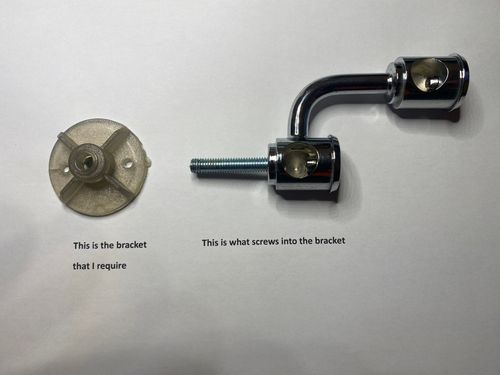

Sorry Eric I don’t know the brand. It would have been installed around 30years ago. The distance between the 2 brackets is 30”.

Thanks for you reply, the unit that I have is plastic (the one that I want to replace was same but black it has broken into small pieces) The rear of it has a space to insert small nut. There is a cover - See attached photos.

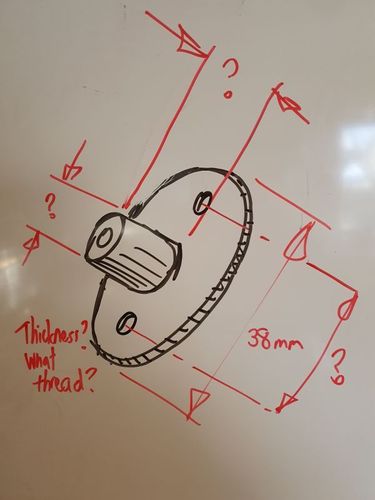

I'm keen to try making one - but we will need more dimensions and they need to be accurate. Do you know the thread size?
I would ditch the four fillets since this will be steel.
Let me know what you think.

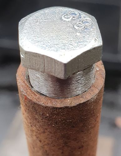

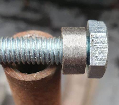

Amazingly I have found 38mm diameter washers with a chrome covering which would be perfect.
Playing outside just now (before the rain) with M8 nuts (assuming your bolt is M8) I found 16mm diameter pipe that a bench-ground M8 nut is then 'sledge-hammered' into position. That nut isn't going anywhere and therefore doesn't need welding.
Cut to the right length this is then welded to the washer - and instant bracket.
Just need a few more dimensions.
