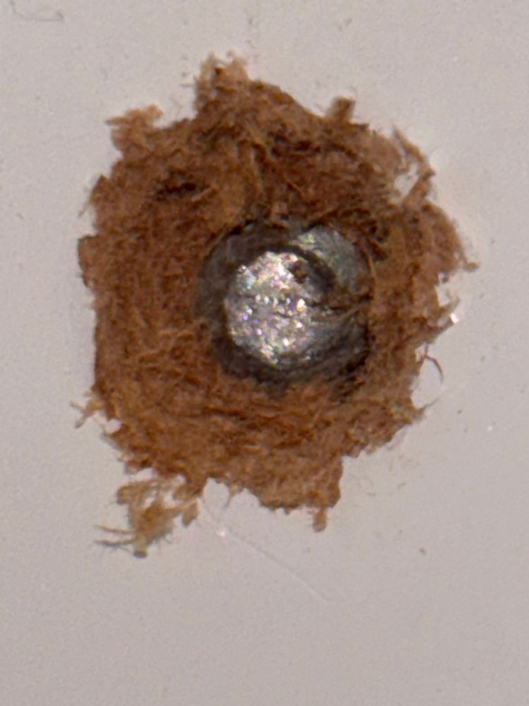

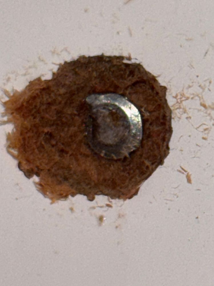

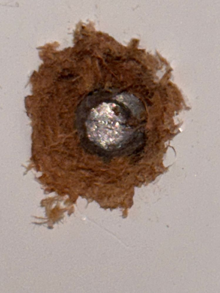

Dear Experts
My laundry shelf is loose and I can't locate the screws for it
Please see attached photos and video
https://imgur.com/a/gq9Hxtw

Hello @zillah
My only other thoughts are to see if you can use a flathead screwdriver and see if you can anchor the head to the tool and see if you can turn it. If this fails, the only other tool I can suggest is to use an IRWIN 3 Piece Screw Extractor Set 1876224.
Let me call on few other members such as @Noyade, @TedBear, @JoeAzza and @Remarka6le for their ideas on how to remove the screw inside your shelf.

Good Afternoon @zillah
Maybe try an imperial set of Allen keys before the screw extractor? That could be why the allen keys dont quite match up. I would also clean up all teh fibres that may be hanging over the edge of the allen head screw as well.

I'm half blind - but it looks like a six-sided bolt head to me?
The large fibrous hole I just assumed was for the socket?

Hi @zillah
I can’t see a hex shaped recess in the head so it’s not going to be an Allan key especially with a head that size. From the first photo it looks like a hex head from a coach screw or bolt.
if that’s the case you will need to open the hole a bit more to fit a socket on to it. Then as @EricL suggested it will undo counterclockwise

I have cleaned both holes as there are two holes

Hello @zillah
It appears that the heads have been sheared off. I propose going with the IRWIN 3 Piece Screw Extractor Set 1876224 in order to remove the body of the screw.

Hi @zillah , just another thought is the get a small is to get a small chisel , 1/4 inch wide and chisel out the wood around the screw , which should then release the shelf from the screws, then get a pair of pliers to remove the screws.
